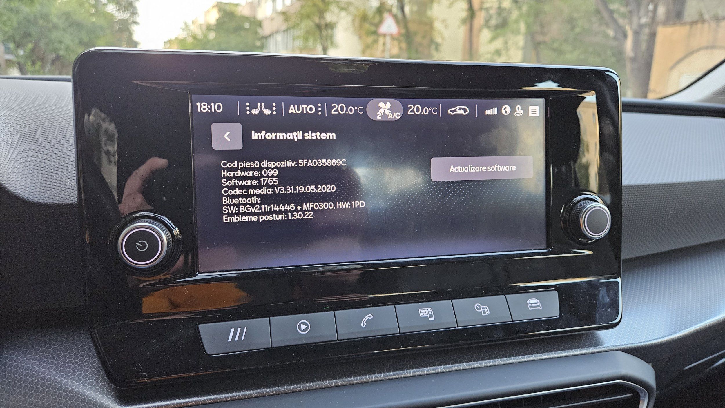

Mar 25, 2023
What is the latest software for this version? Seat Leon MK4 Style? My dealer says that this is the last version, 1765, i have problems with connecting bluetooth and Android Auto is not working on Samsung S23 Plus, i mention that i don't have Full Link with Wireless...only with cable....

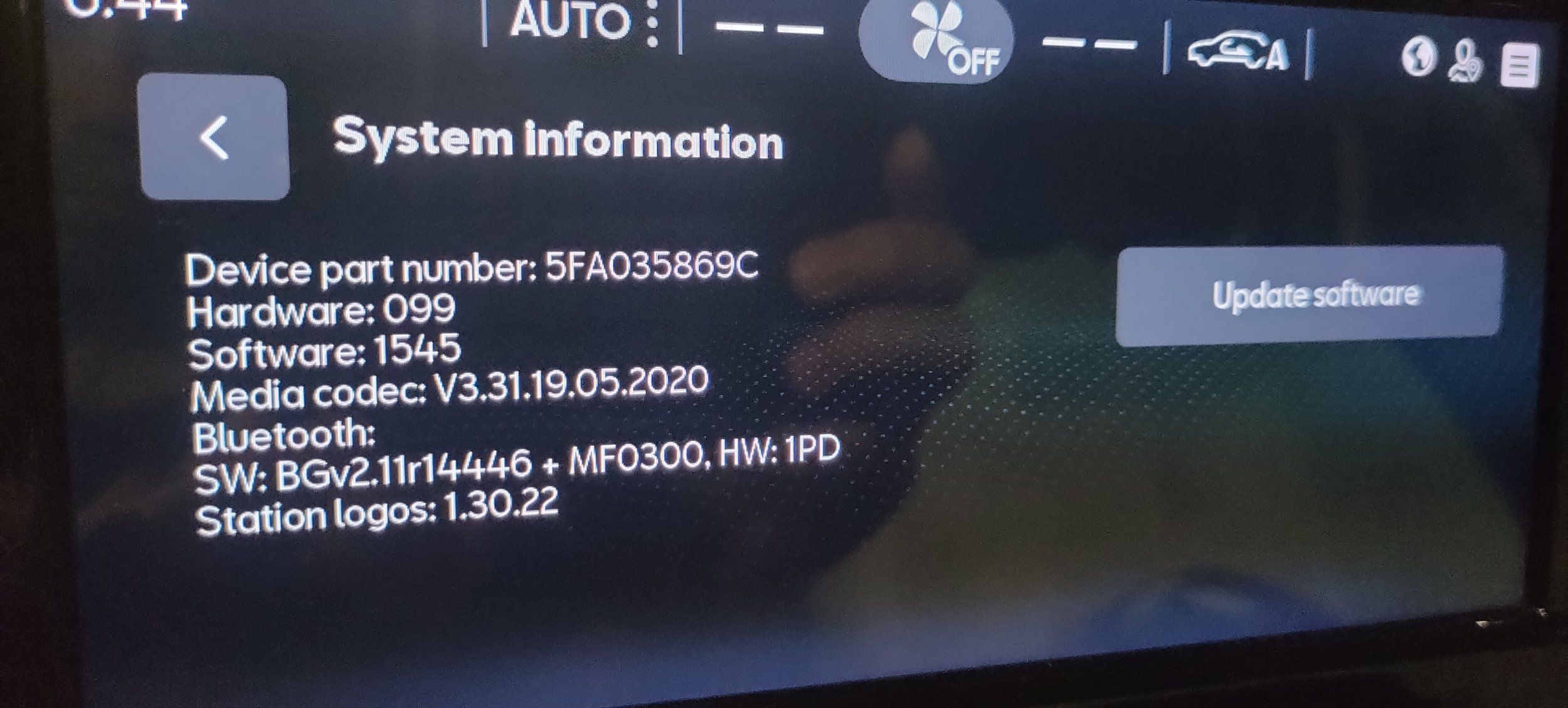

Hello all! I have a Leon Style 22 with Software version at 1545. I went before 2 weeks for the typical service and they told me that there is an update that has to be done. When the service ended and I went to take my car, I asked for the update and they told me that I will do it myself. I asked how and they told me that I will see a notification. I asked if I need internet connection and they said no, it's from the satellite (?!?). Next day I called another dealer and he told me that I need to have active subscription at Seat Connect App. Do I need to pay for seat connect app subscription in order to have that update? I'm really confused, especially with the satellite thing...

Do you have the 8 inch multimedia system?

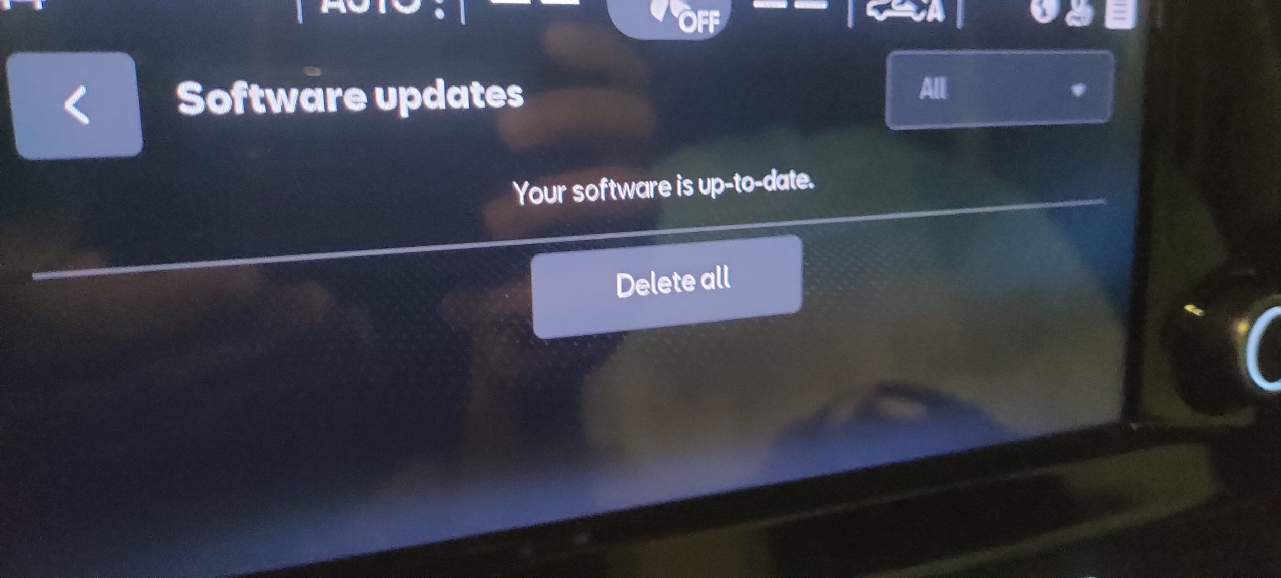

Couple of days ago I spot a red dot so see what's there. Apparently a 3 part OTA update! So I start the download for part 1, about 185mb and have seen nothing since! Can I force it to restart the update again?
