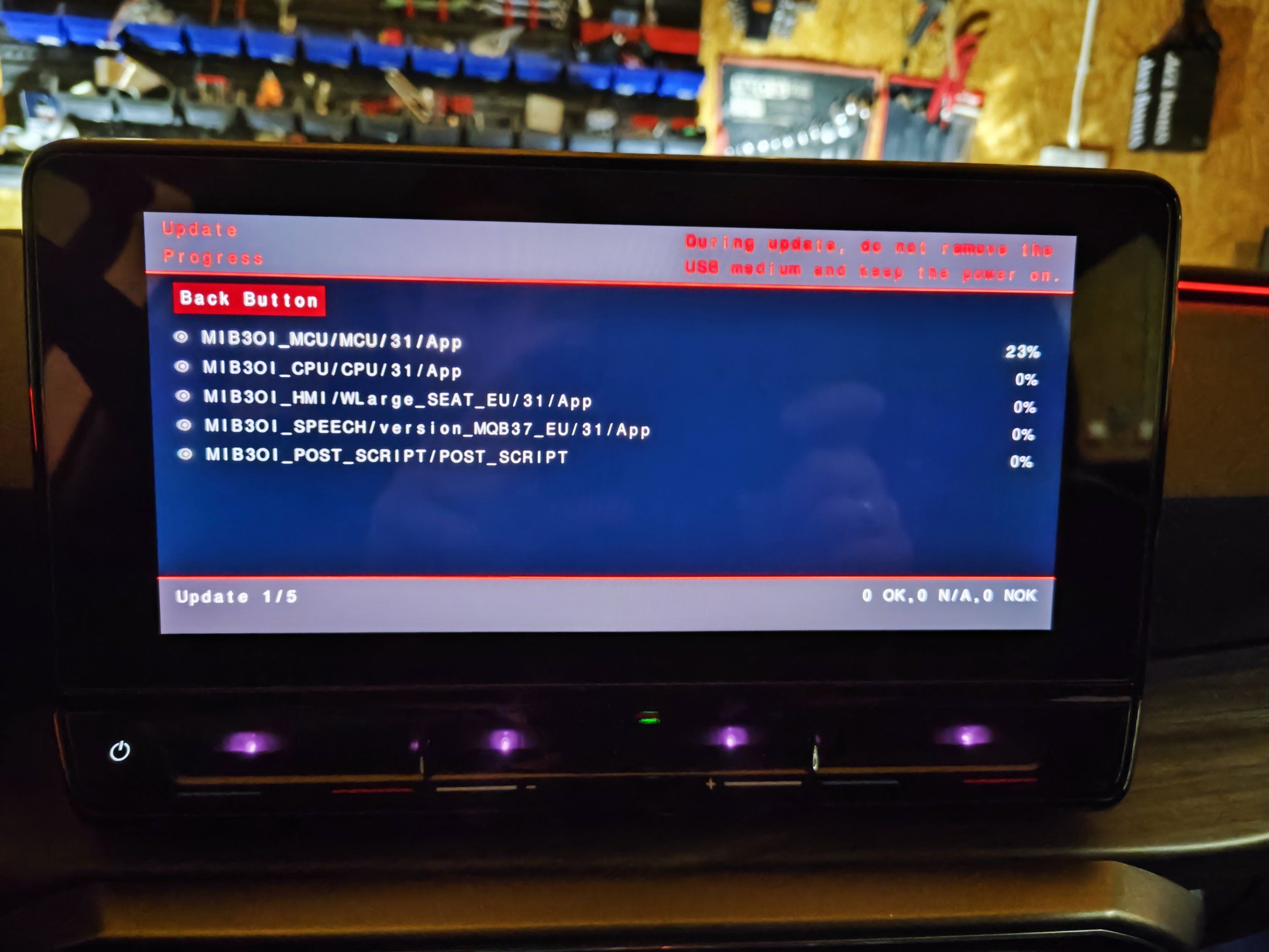

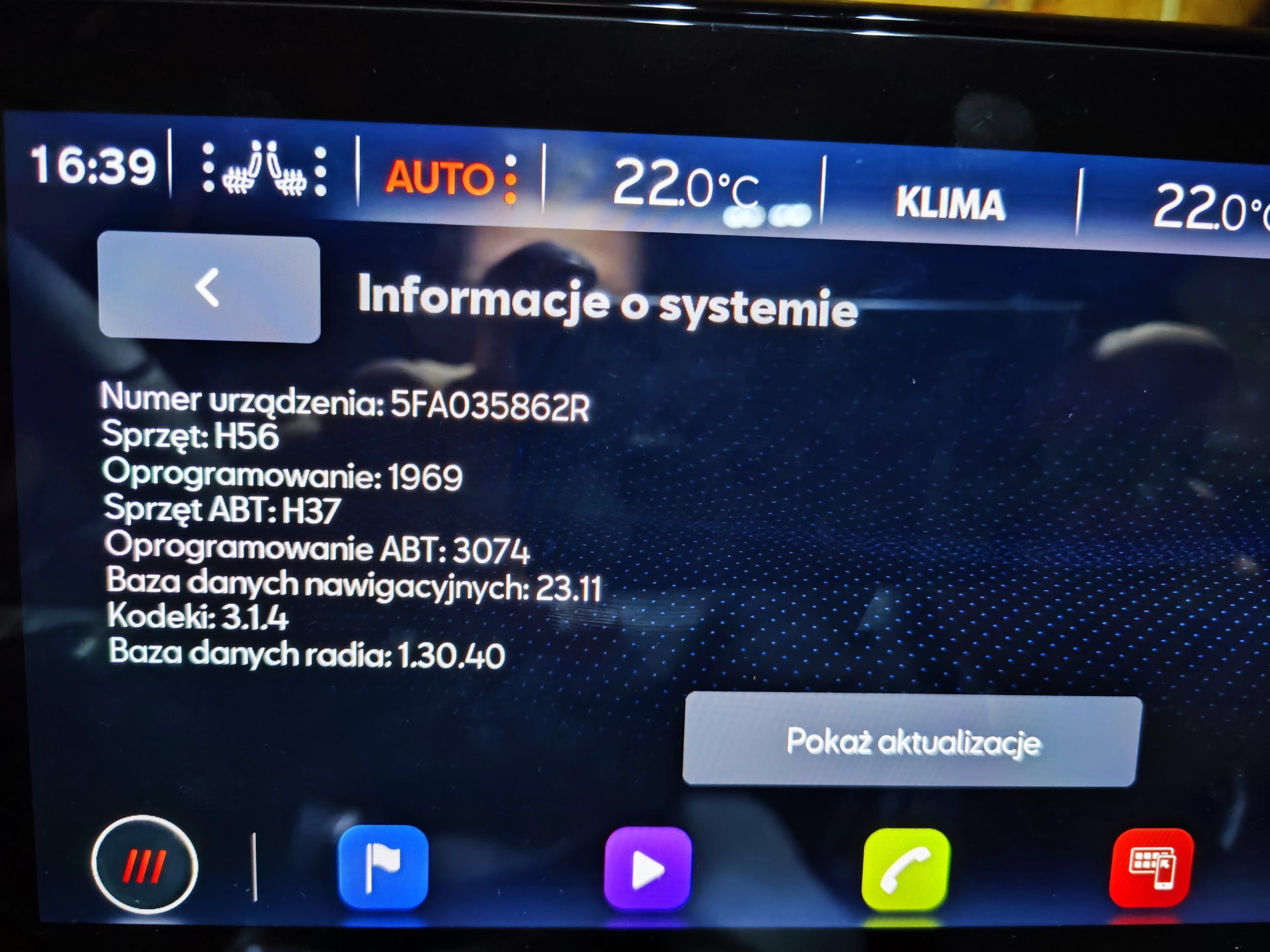

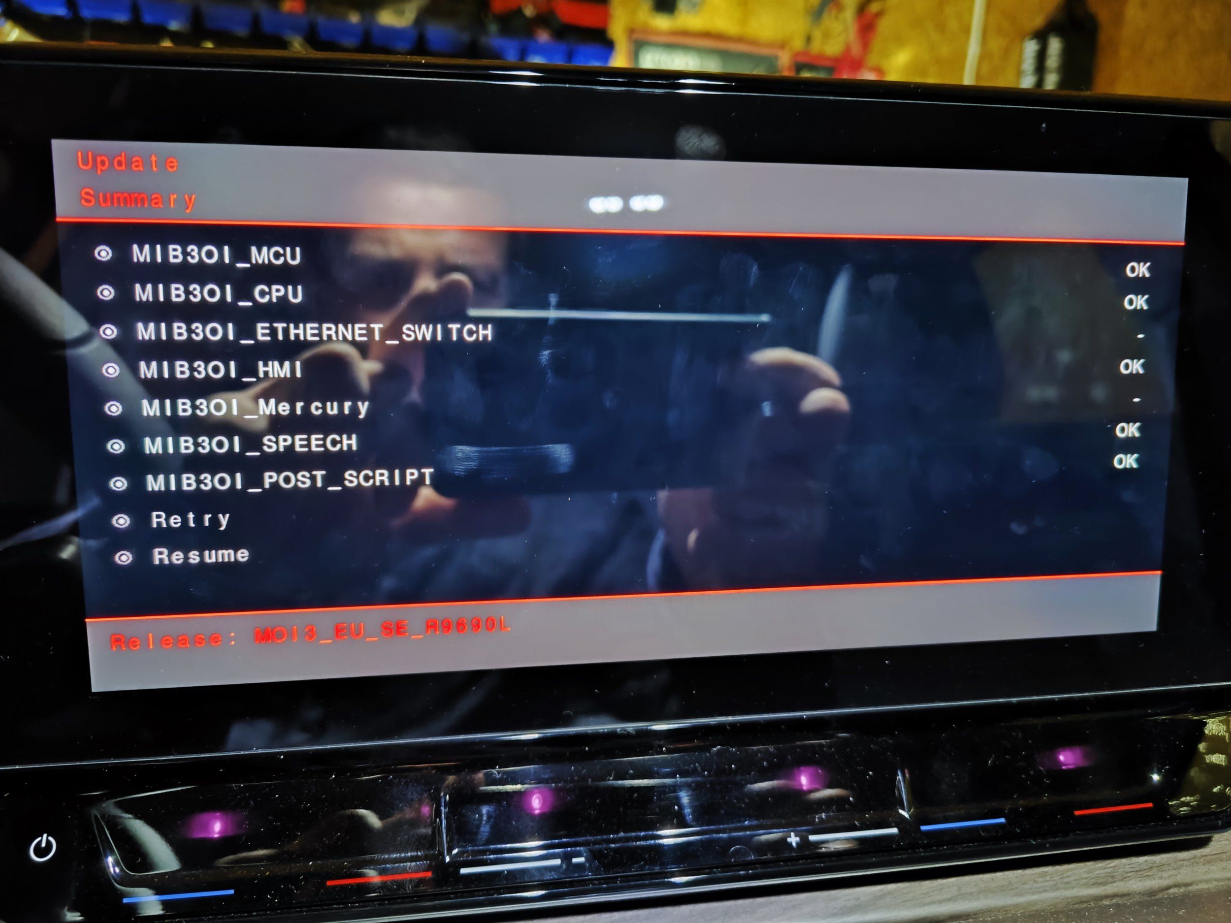

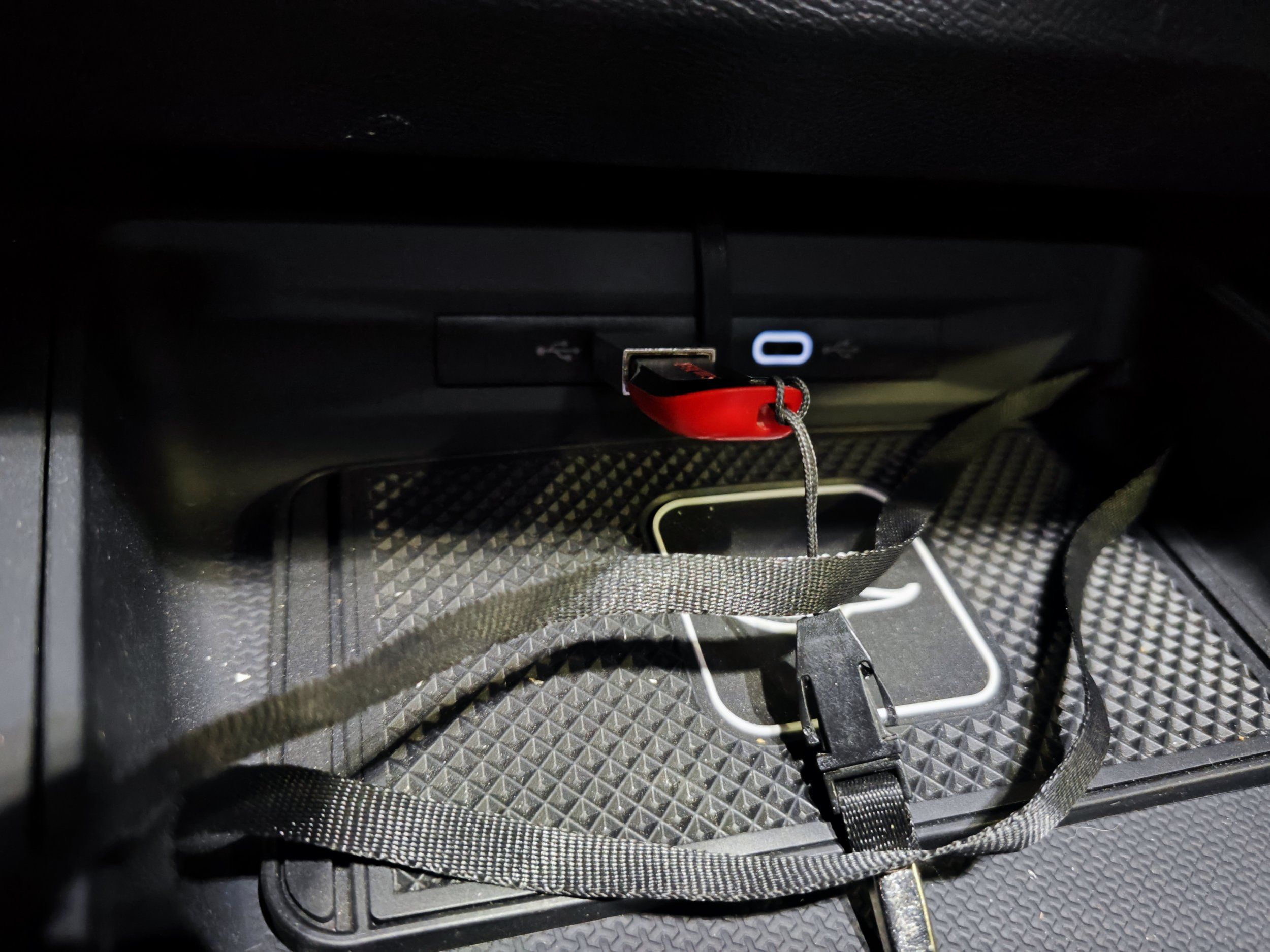

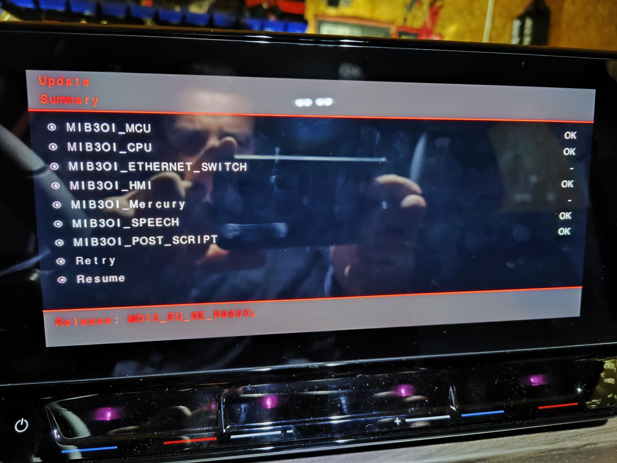

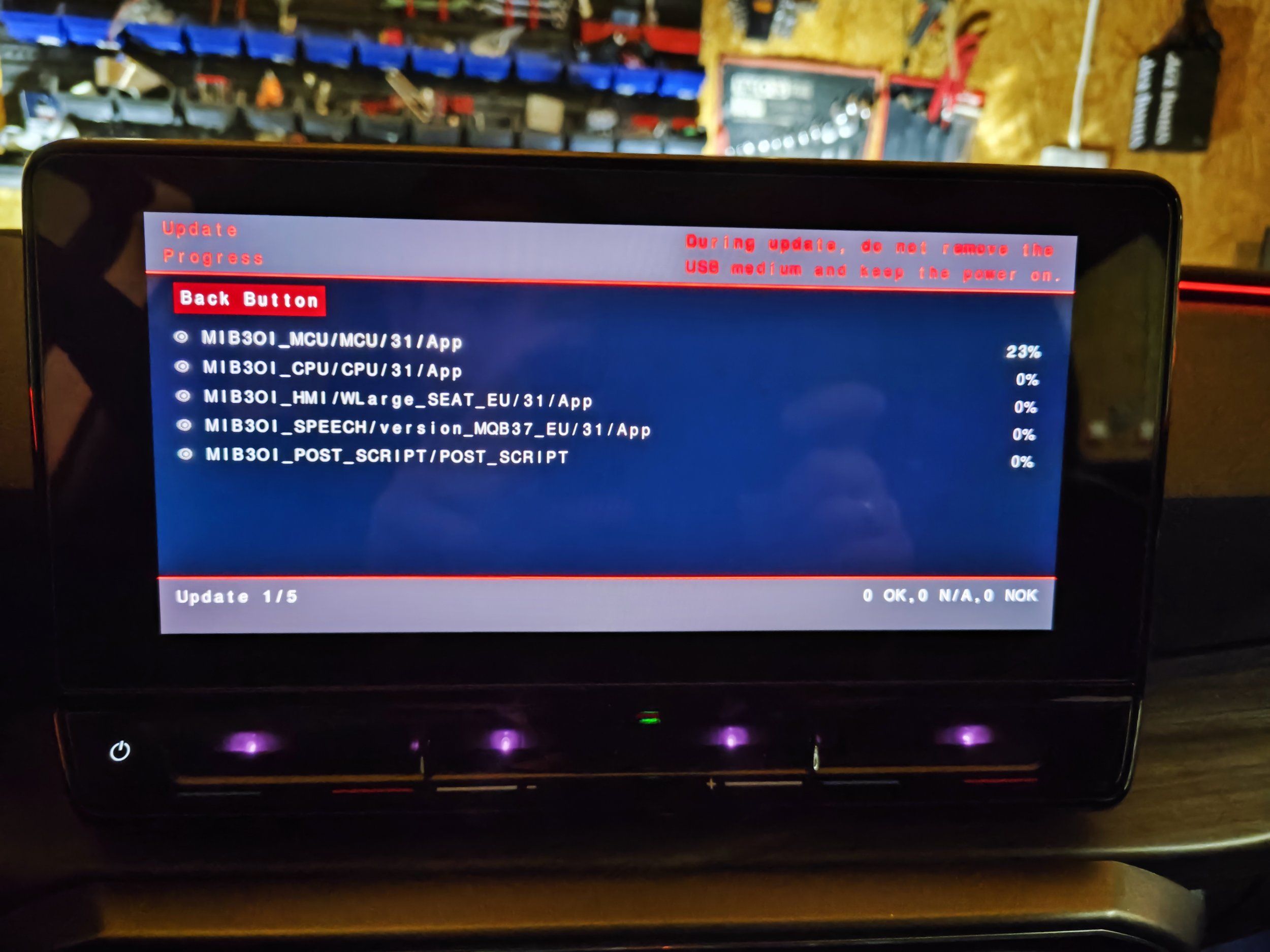

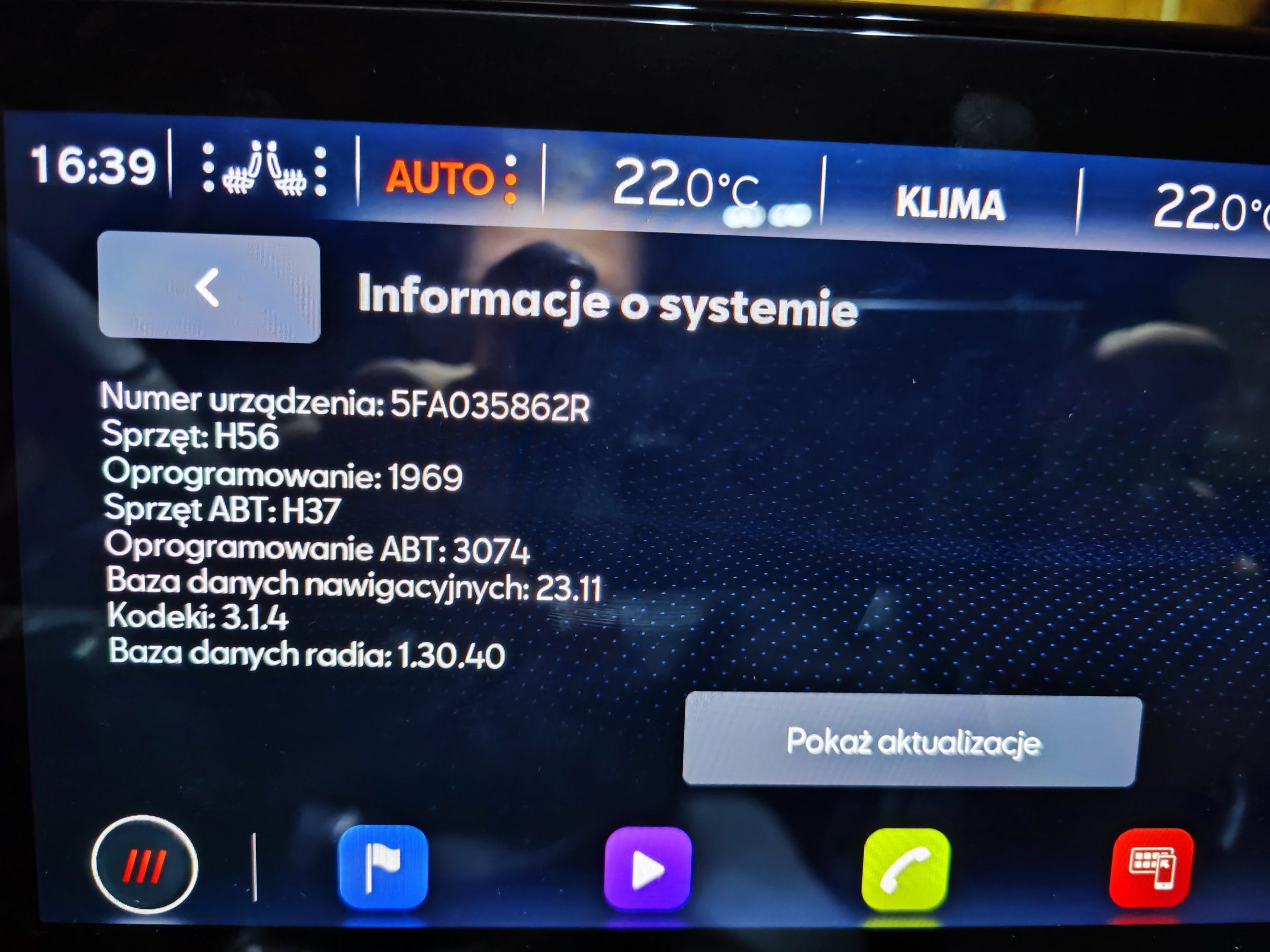

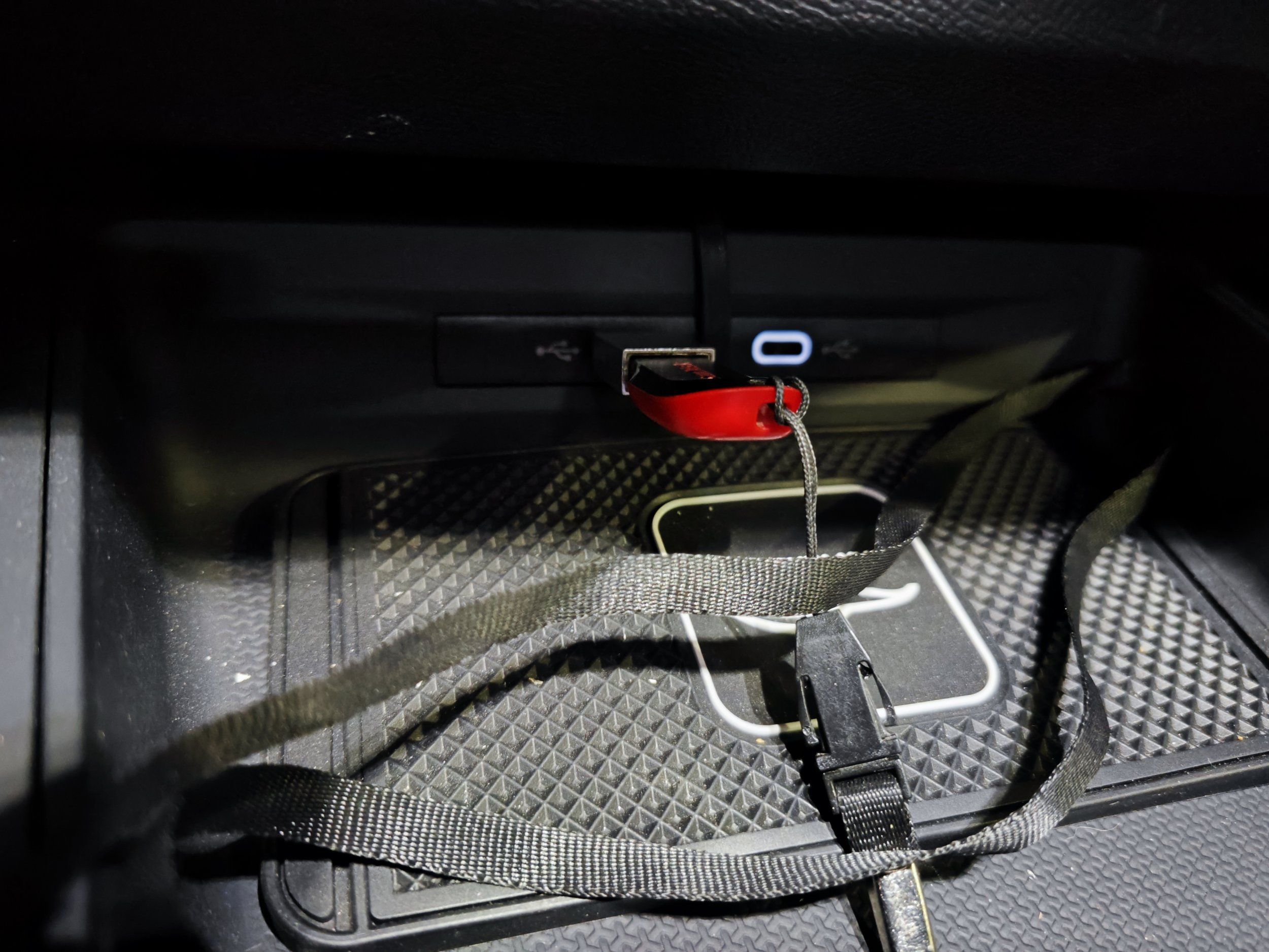

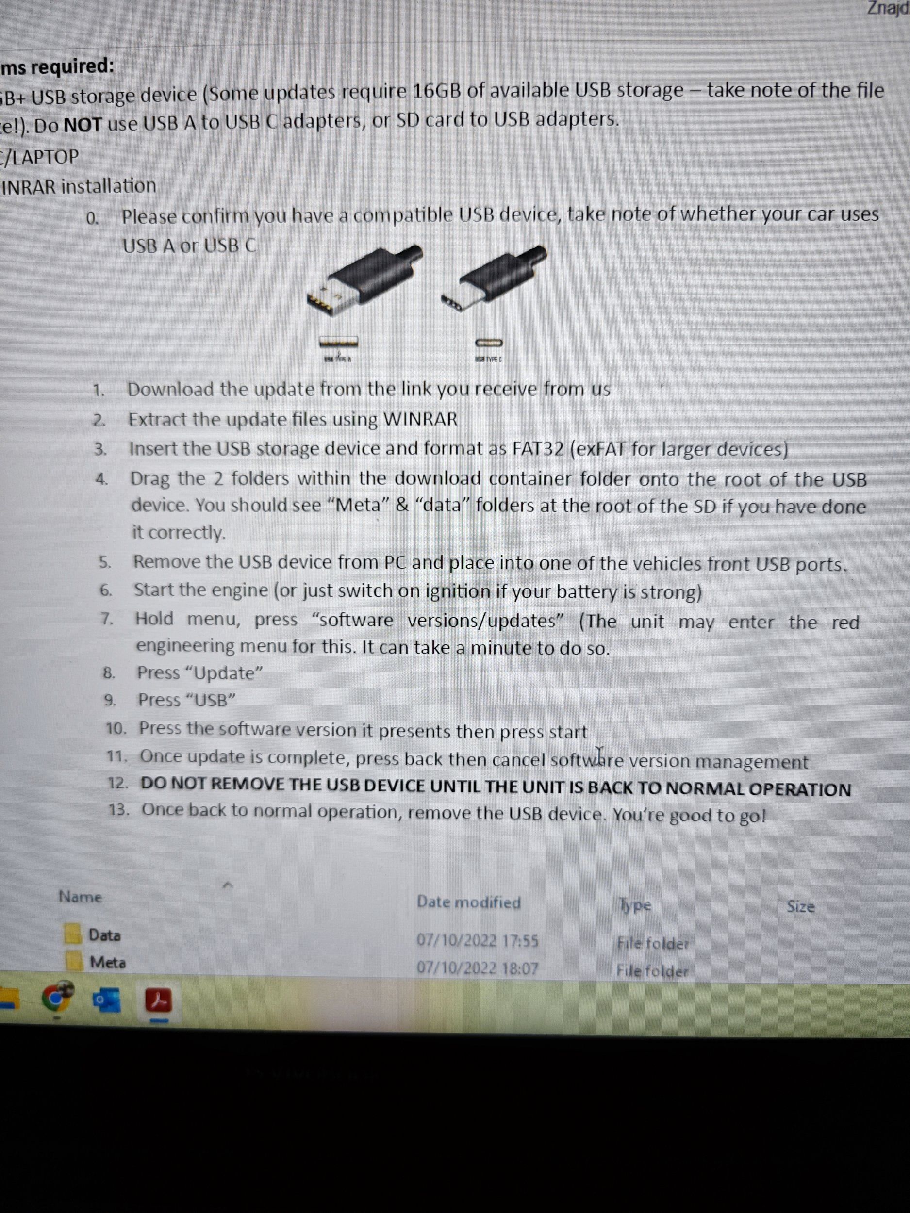

I will share with you the file I made from. Link for 1940 is HERE and link for 1969 is HERE. You do it at your own risk. download the file to disk, unpack it using winrar. format the pendrive to fat32 or exfat. Copy folders DATA and META for pendrive. Start the car. it's more safe than a battery. Insert the pendrive, press and hold the menu button (this on left corner with 3 lines or 4 dots) up to the service menu and press update. We're taking off down there. we wait about 15 minutes. If everything is OK, click resume and the system will restart. the manual is also available for download. Thanks for Jakub F. for file. File verified by 5 people on the Polish forum. Including me. I have update from 1896 to 1940 few months ago and now from 1940 to 1969. I don't know if you can update from older versions.
View attachment 39453 View attachment 39454 View attachment 39455 View attachment 39456 View attachment 39457

It seems to me that the USB update procedure from 1940 to 1969 is identical to the previous procedure for updating from 1896 to 1940, correct? only in this case, can I directly upgrade to the 1969 since I already have the 1940?

I have update from 1940. Procedure is the same. I was testing now and one small ota came right away. the same as in 1940 with the main user. Nothig change for now

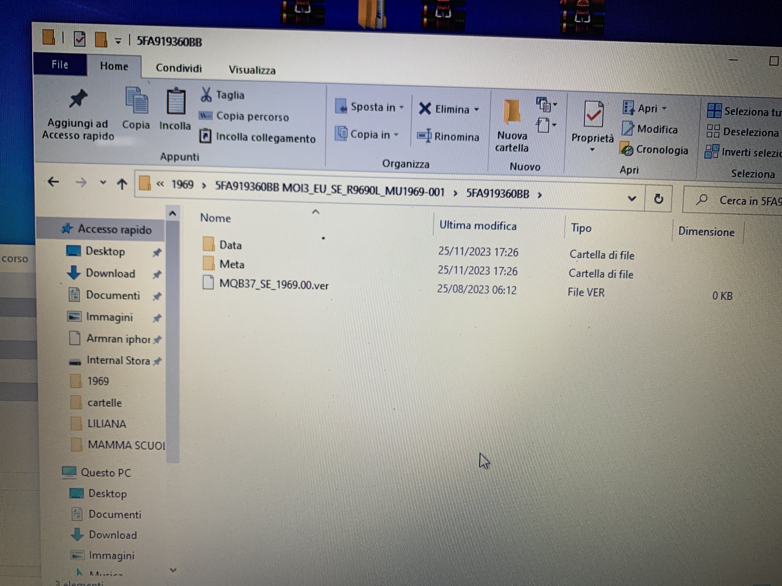

once I have extracted the rar via 7-zip (exactly as I did for the 1940 version), is it correct that I also find a "MQB37_SE_1969.00.ver" file together with the two "DATA" and "META" folders?
Yes. I also copied this file to a pendrive. I don't know what it's for but everything went fine
