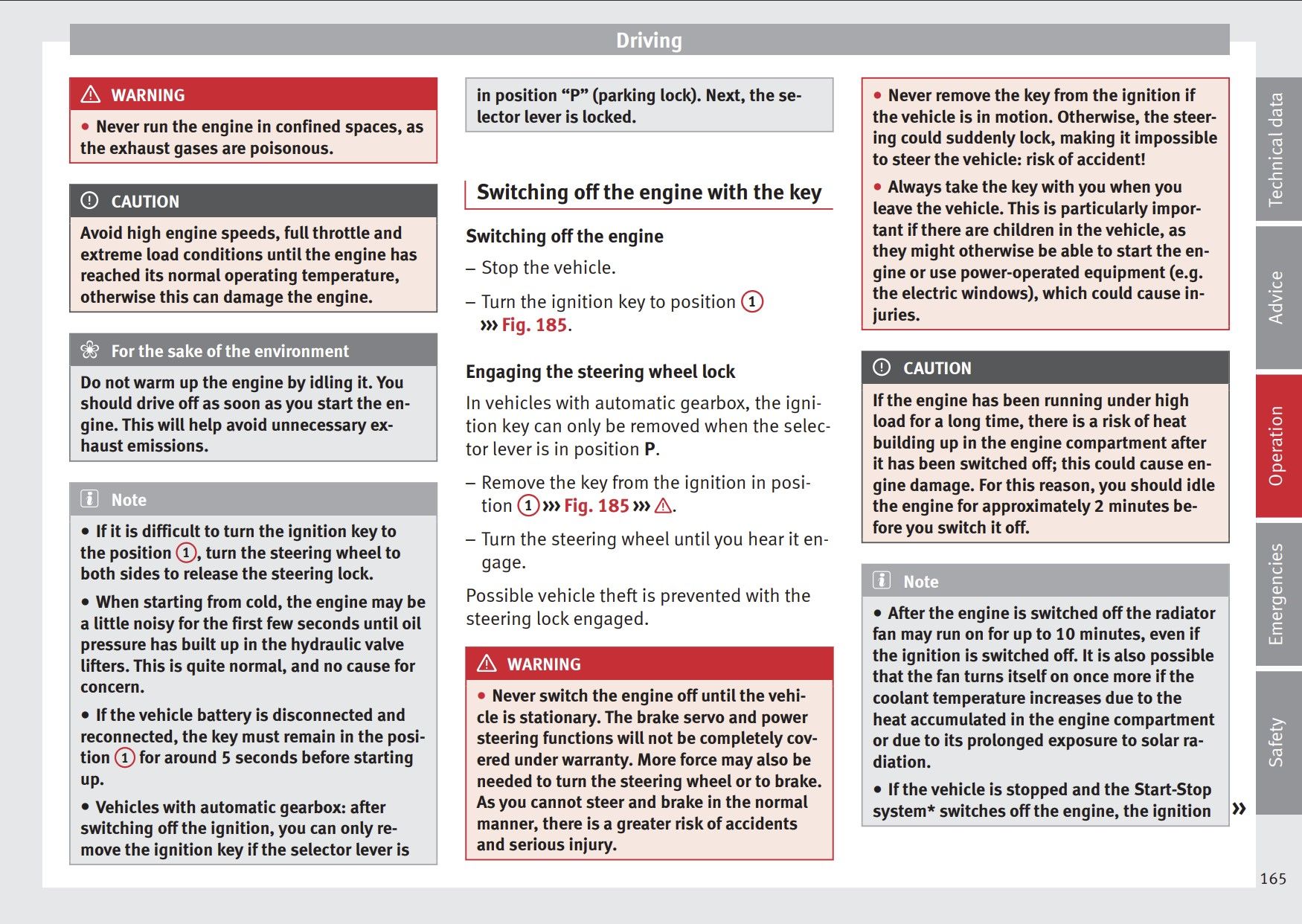

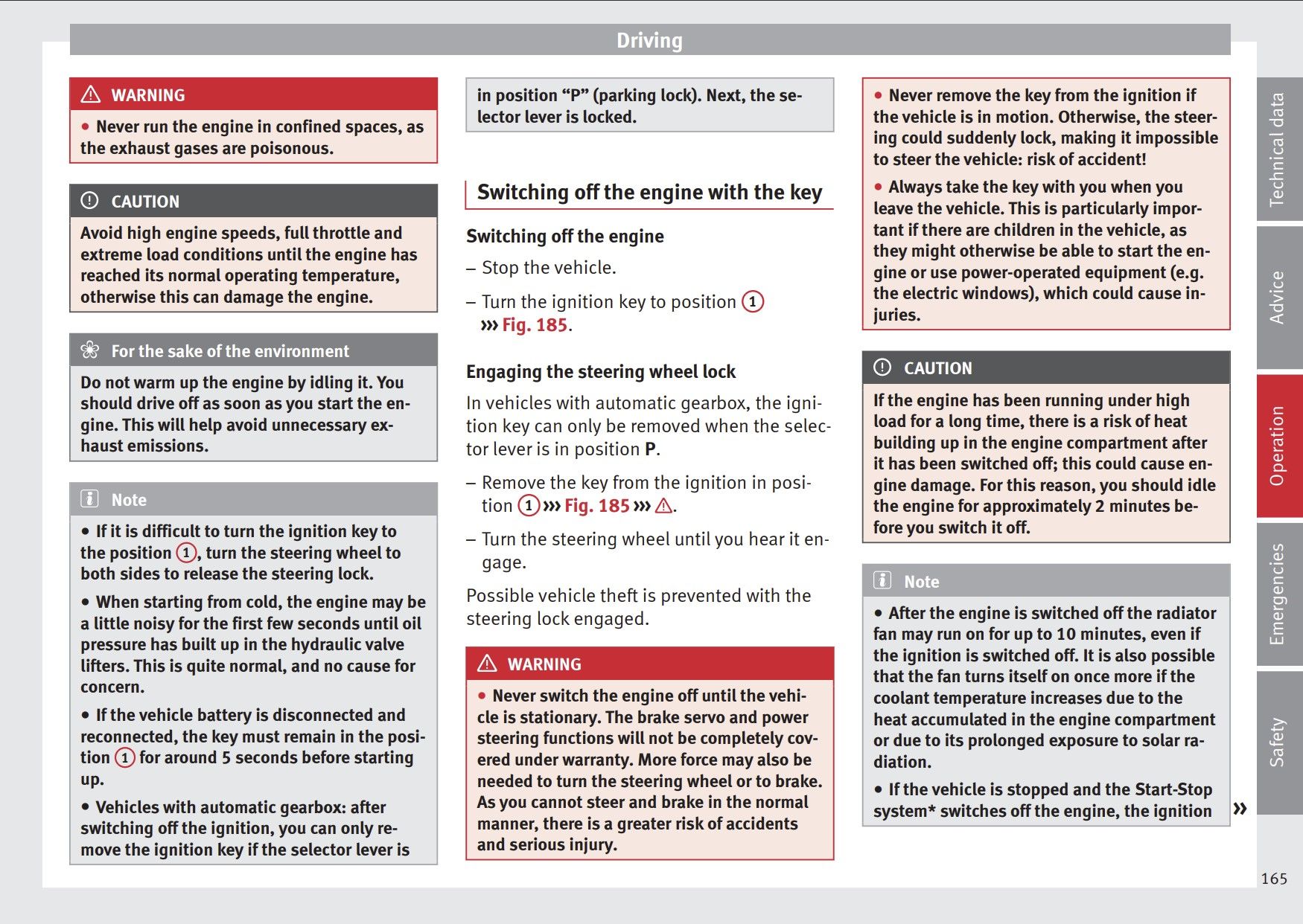

Why and how is it bad ?
it is better for the engine to drive off shortly after starting but don't 'stress' the engine.
