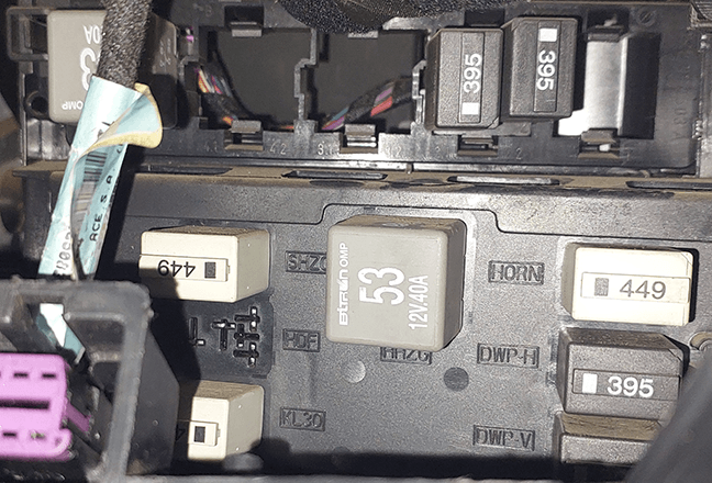

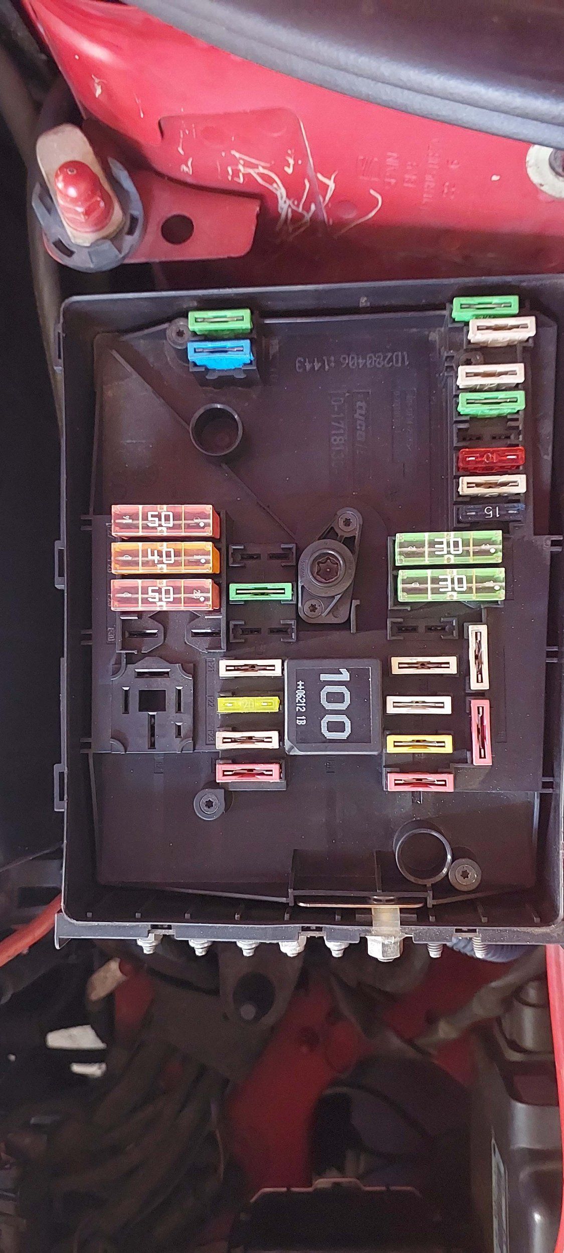

so my rear window wiper is not working and both water jets front and back are not working but the front wiper works fine, I removed the rear window wiper motor and hooked it up to a 12v source, and the motor worked, I then tested the connection running to the rear window wiper motor and got a low voltage reading of 3.8V to 4V, now I'm no expert and have read on other threads that this might be because there are different speed settings on the wiper but I am still to test that, is it not supposed to be 12V?.
I have also checked the fuses in the cabin and the engine compartment they are fine(not melted or blown), so I need to check the relays ?? where are they situated ?? I have attached pics of my relay setup I have a 2007 Leon 2.0 tfsi spec: sunroof, non-xenon, 6 spd manual, and leather seats. I'm providing these specs in case anyone has the same specs to compare the relay setup
