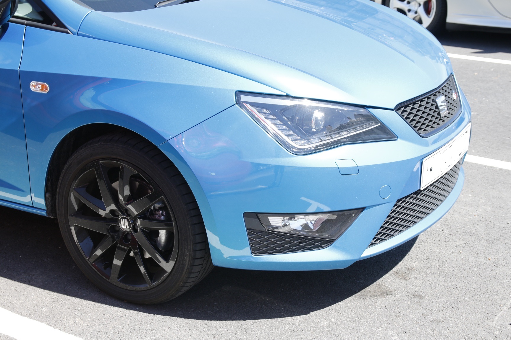

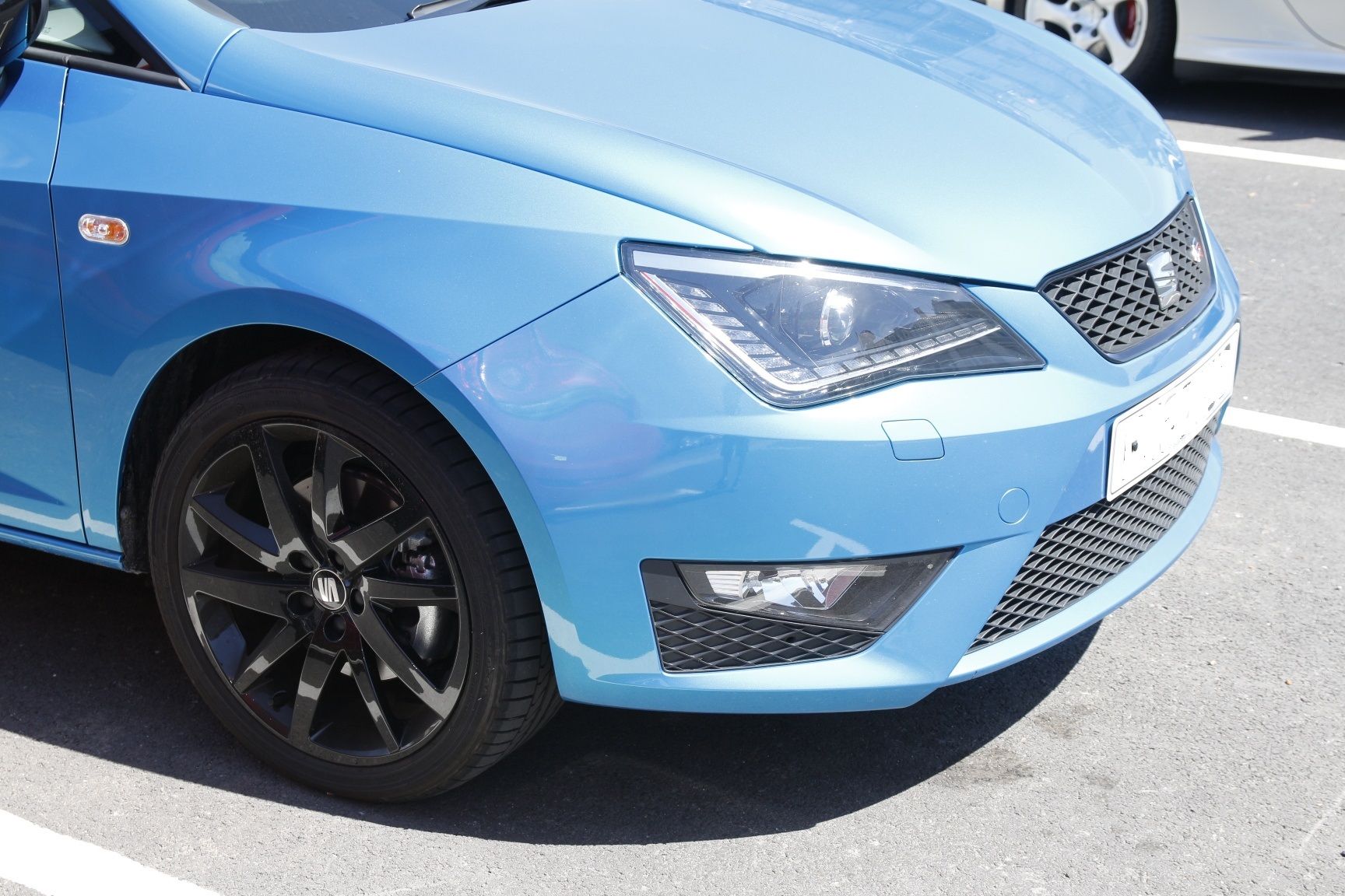

When you turn your headlights on, do they start yellow, then gets very blue, then after 30 secs or so, settle with a white colour? I thought all Cupras 1.4TSI 180 onwards came with D1S bi-Xenon headlights? I just think after 4-5 years, it may be getting dimmer and duller, and perhaps a bit purple. Are yours like these below? I have this same setup on my car, I find it very nice and bright enough (but still dimmer than some Mercs and Prius and Audi's with LED headlights), though I only had it for 2 years and 11k miles on car. Not sure which bulb is inside, assuming regular Philips/Osram D1s Bi-Xenon. If so, you can replace it with Osram Cool Blue Intense or NightBreaker Unlimited D1S. They should be around the £70 mark for 2 from amzon. You may need a garage to help you fit them.

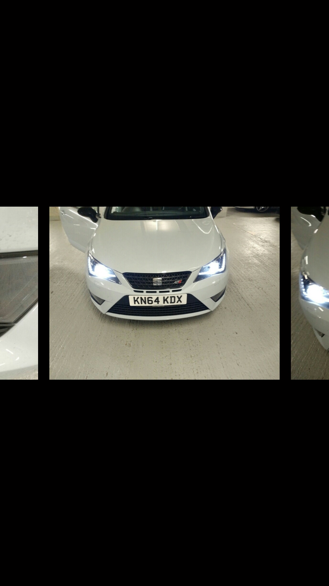

Hi. Thank you so much for your help.
I have just noticed that my Led daytime running lights have stopped working.
I have taken a few pictures, please let me know your thoughts
Thank you.

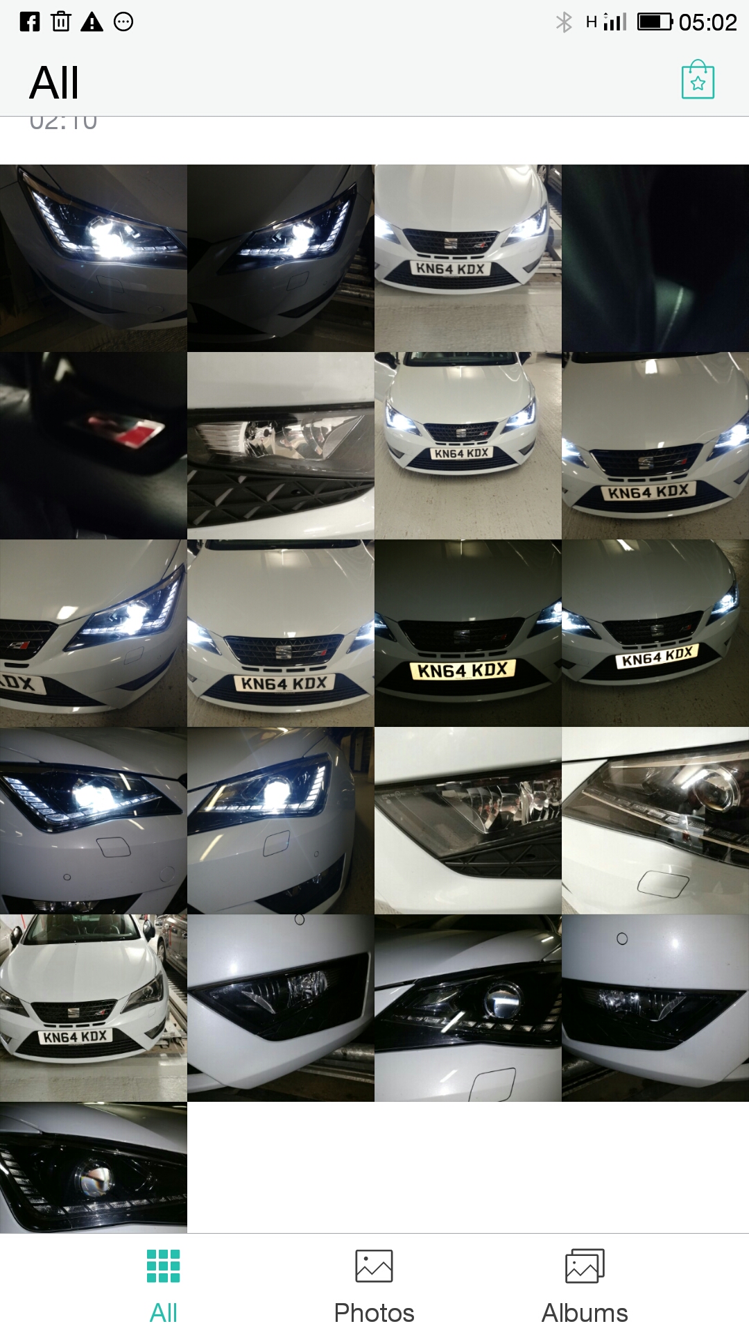

As you can see in the pics, my bottom daytime running lights are different than yours?
And my daytime running lights have stopped working now, think they're gone and need new ones too
Please see another picture. Headlights and daytime running lights.

Yes, this is my car, it's not a Cupra, but it has Bi-xenons. The bottom lights are fog lights, they are H8 (I think) bulbs, and one side is easy to change, the other side is a pain in the a**. It's unlikely they would have both fused at the same time, (did you check the fuse box?) assuming that when you have the headlights on (side lights or dipped beam) you are aware that you need to pull the headlight device up towards you?
The L shape lights are the day time running lights, and the bulbs on the main headlights are D1S.
Your xenon headlights look fine and still have plenty of life left...have you cleaned your headlights (give them a wipe with a sponge and dry with microfibre with some mild screenwash)...this can really hinder brightness.
I now also have a Volvo V40, and those LED headlights are waay brighter, but I wouldn't say the Ibiza's xenons are dim by any means...
