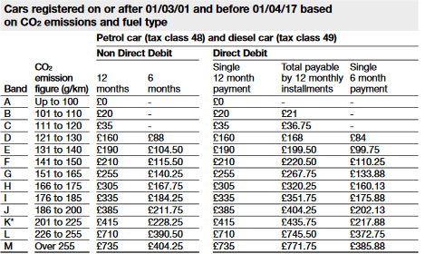

The emissions for that car are 121g/km
So it falls in band D which is £160
You need to look at an earlier car that falls in to band B or C

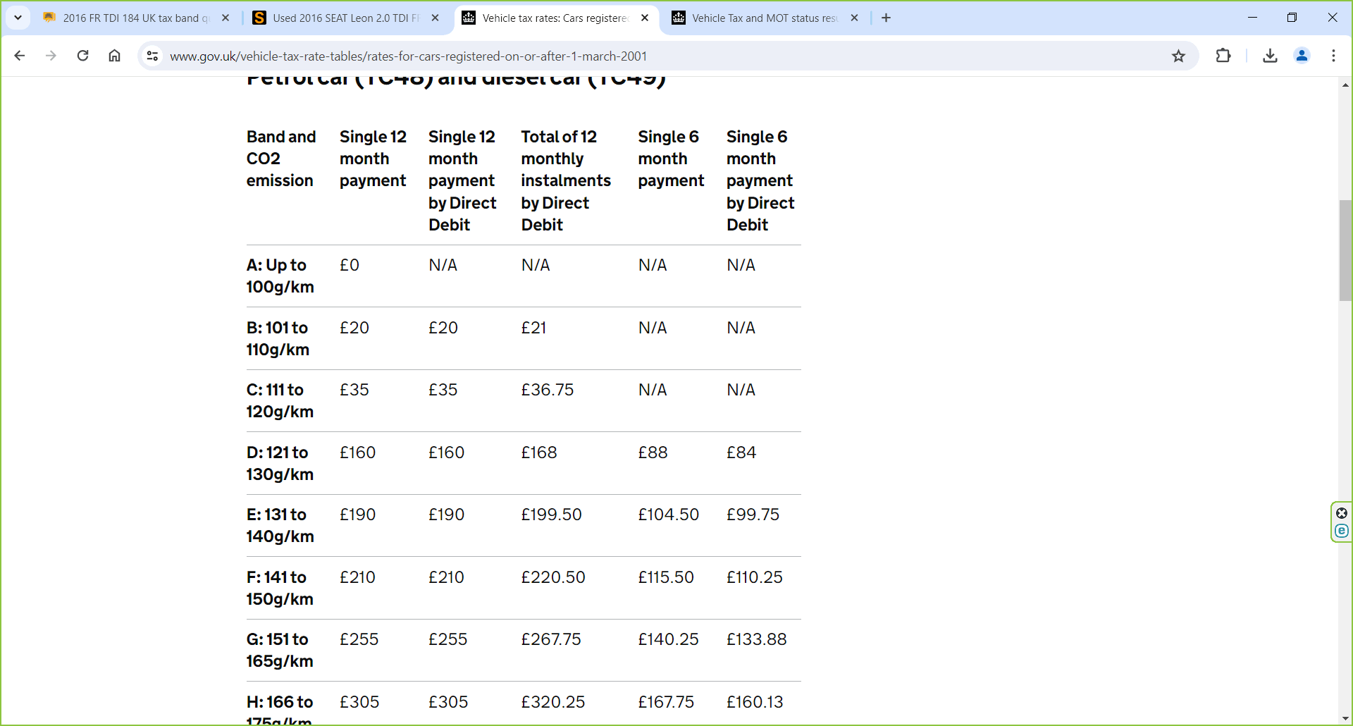

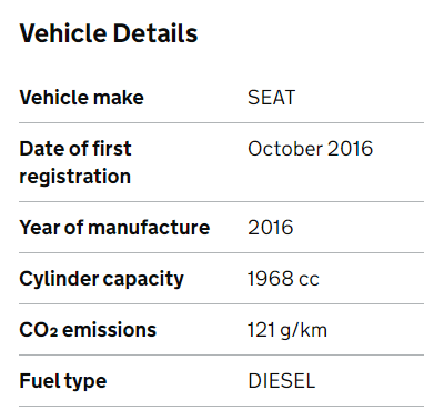

You can check a car's CO2 rating on .gov website. https://vehicleenquiry.service.gov.uk/VehicleFound?locale=en
That car is listed as: 121g/km which is group D so the higher group than £35 'C'.
It has 18" wheels - sometimes bigger wheels can bump it into the next tax bracket.
