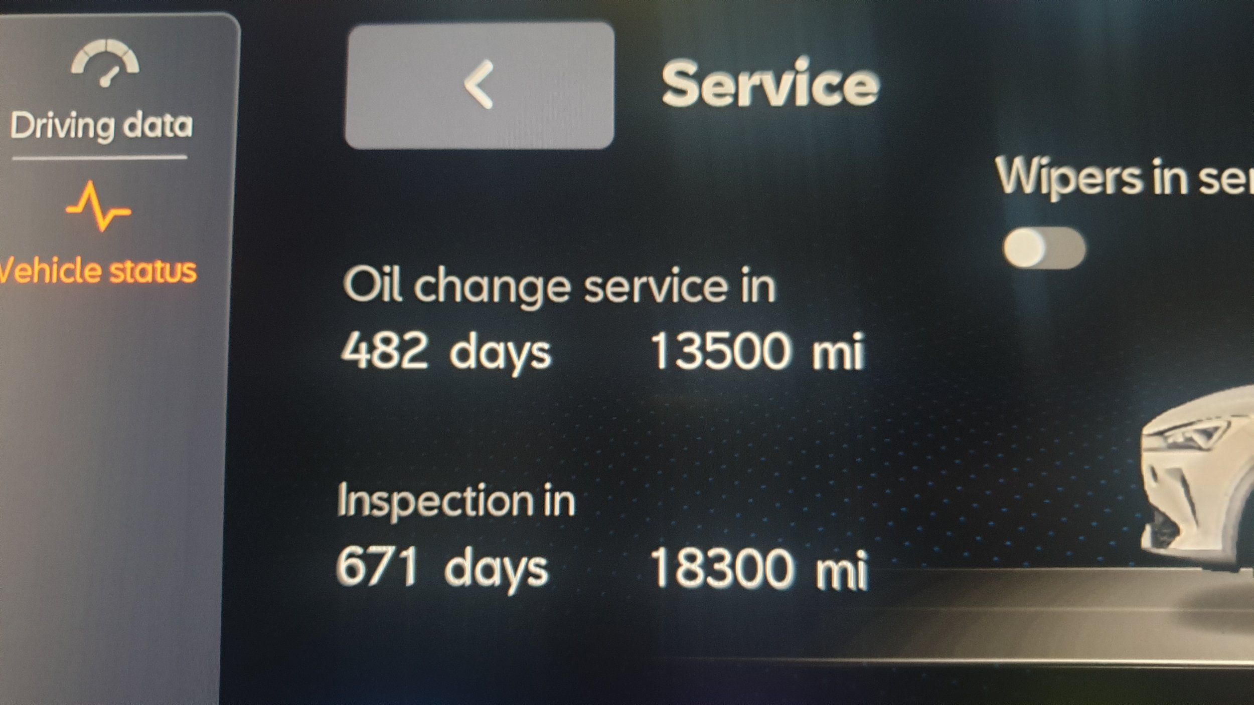

Looks like I had twin brother of your car, but it didn't come from Stockport. Mine had flexible service setup. Below picture taken 3 days after collection. Oil change went up to higher mileage over time.
6 days later it was showing 14700 miles and 527 days to next oil change. And at 5 months old it was 14300 miles and 521 miles
I think your car was setup incorrectly. Isn't there some combination to reset it? Date can be changed using OBD Eleven.
