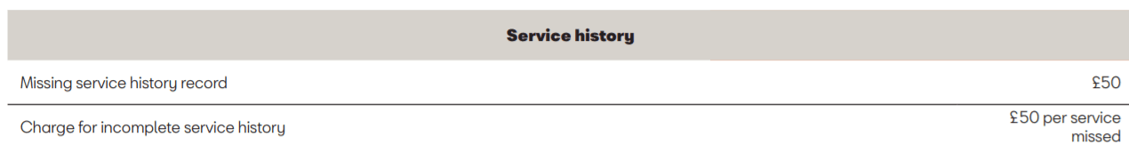

Orrr, you could just skip the service and get charged 50 quid haha!
