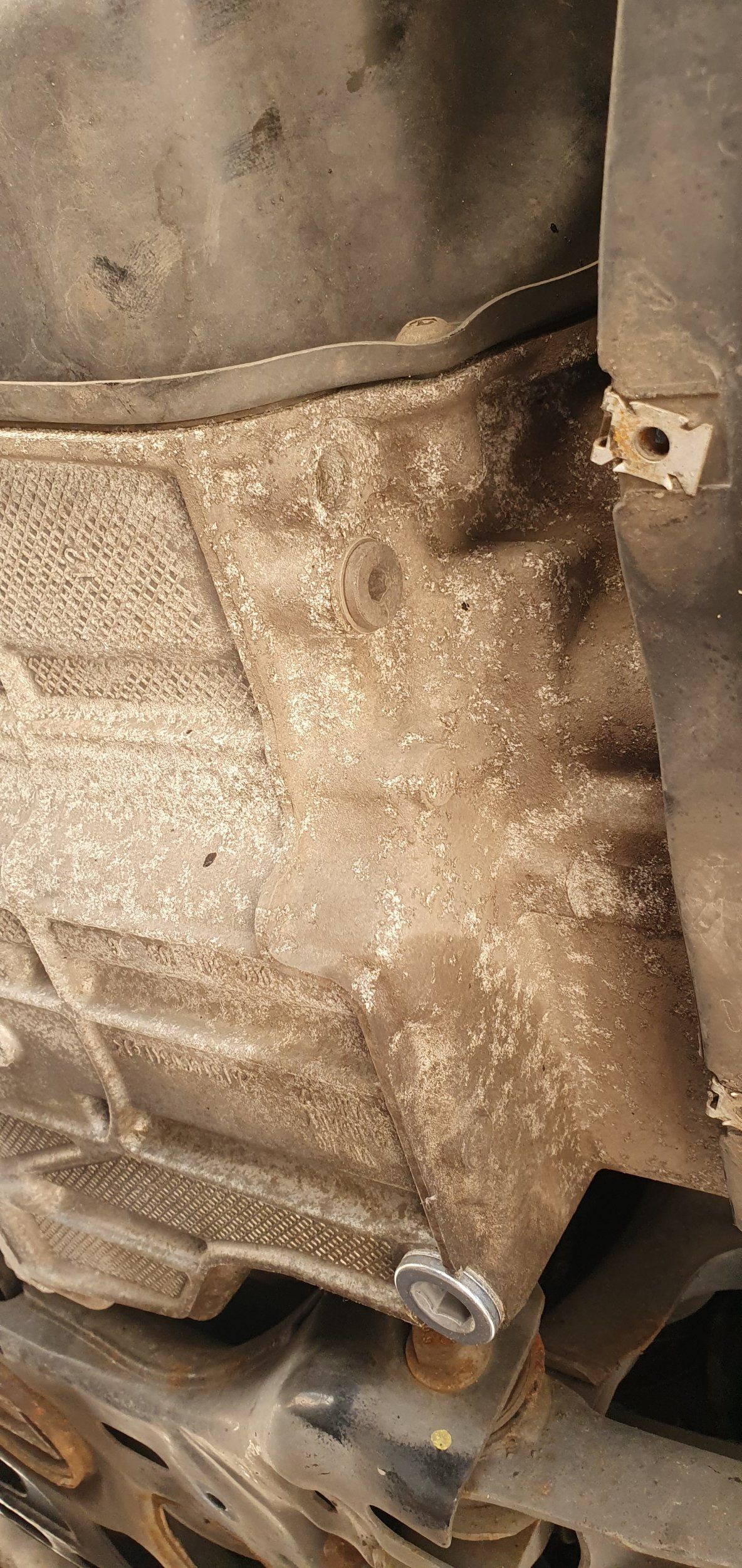

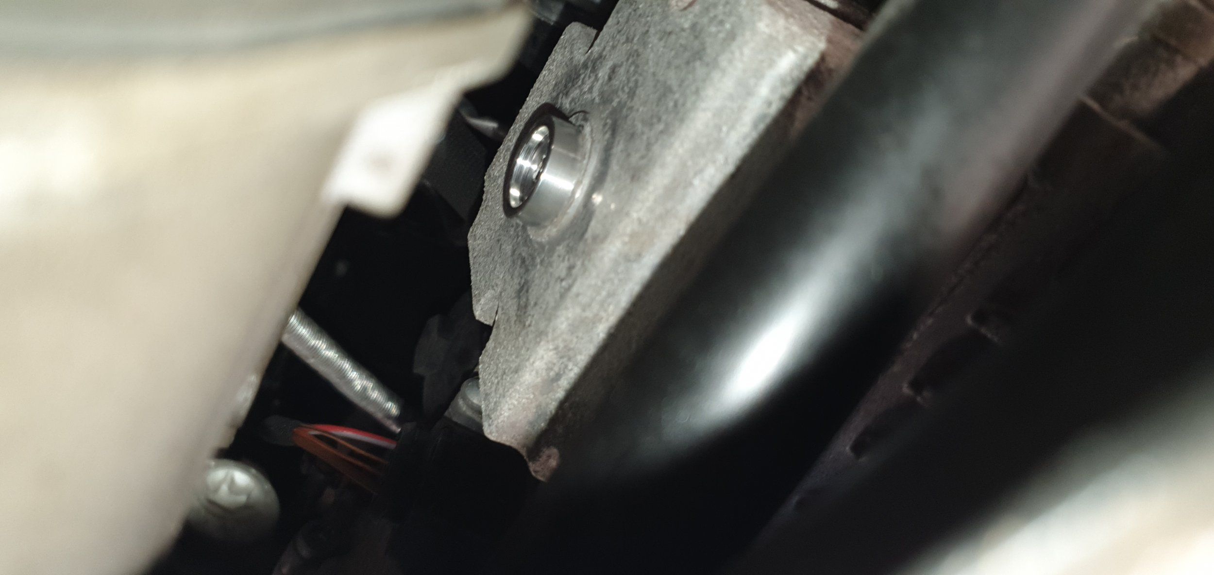

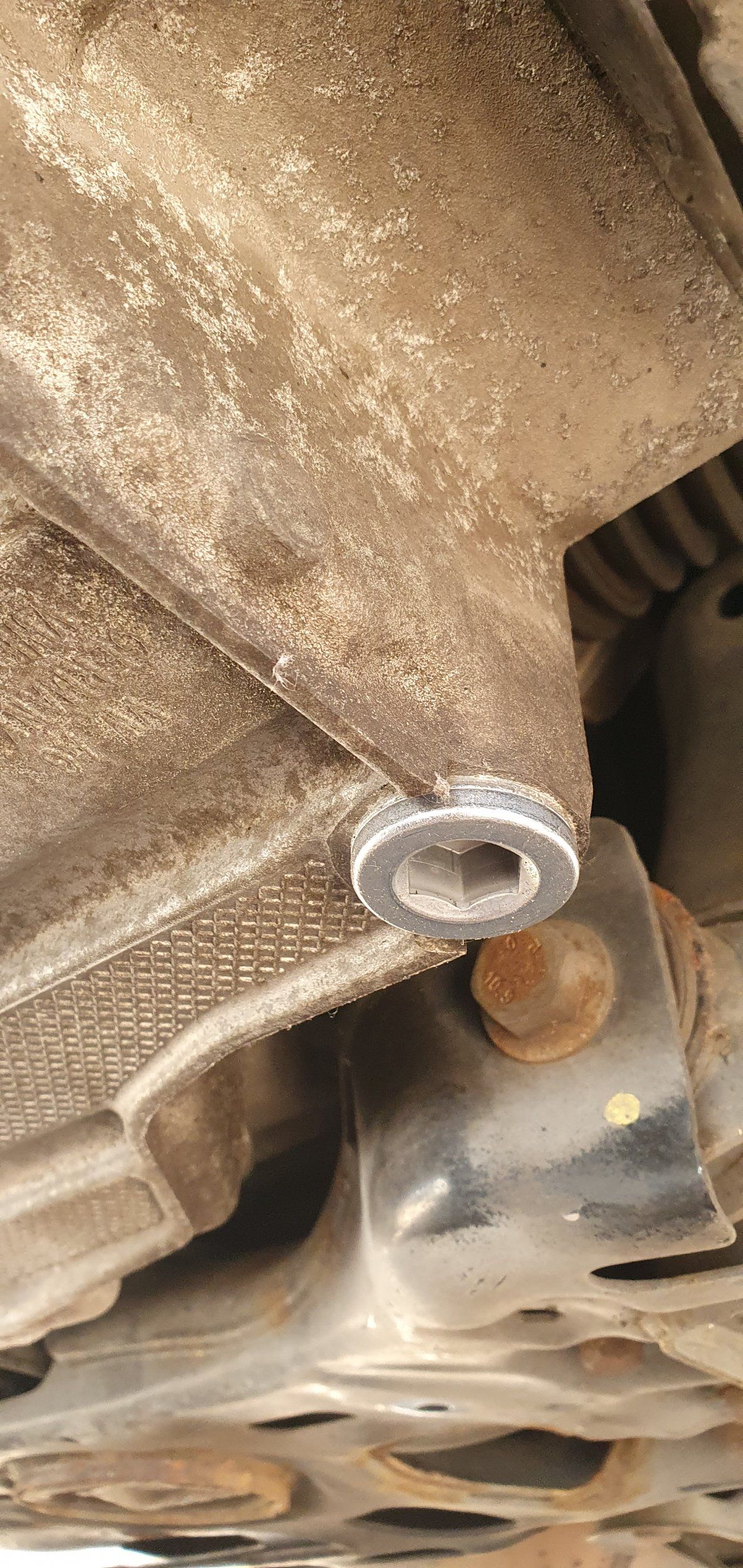

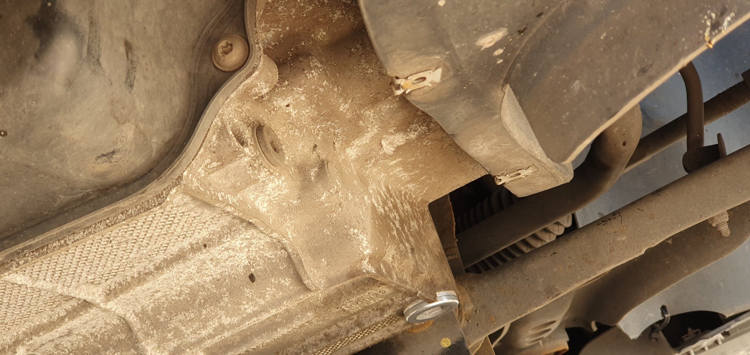

I was going to do the dsg service myself but wanted the service history. Wish I did it myself!
Had it done last week by Seat also had the front diff fluid changed too, since having it done, in D mode there's a feeling of the car holding back when going up through the gears. Also holds onto the gears longer too.
I put it up on the ramps this afternoon just to see if it had actually been done correctly...
I was quite annoyed to see that there was no sign the filter had been changed and also the mechatronic drain plug had not been touched. No sign of oil drips any where. The front diff seems to have been done as there's two new plugs plus traces of oil on subframe.. done correctly I do not know! šŸ˜‚
I've emailed them today and I will be ringing them tomorrow morning when they open to see what they have to say.

According what i know, during oil change this idiots not changing oil filter. It's absurd. You need to tell them to do it. I have 30 kkm and start to worry about what they will do to my car in Poland. ;/

I know it's poor practice. Especially when they have charged me for the filter change to as its on the invoice! I'm sure there's no way they could of changed the filter without getting a drop on the gearbox casing as the filter is horizontal.
I'll see what they have to say tomorrow when I call them. This is the first time I've taken any vehicle to a garage to have work done! Safe to say it will be the last time! Idiots.
