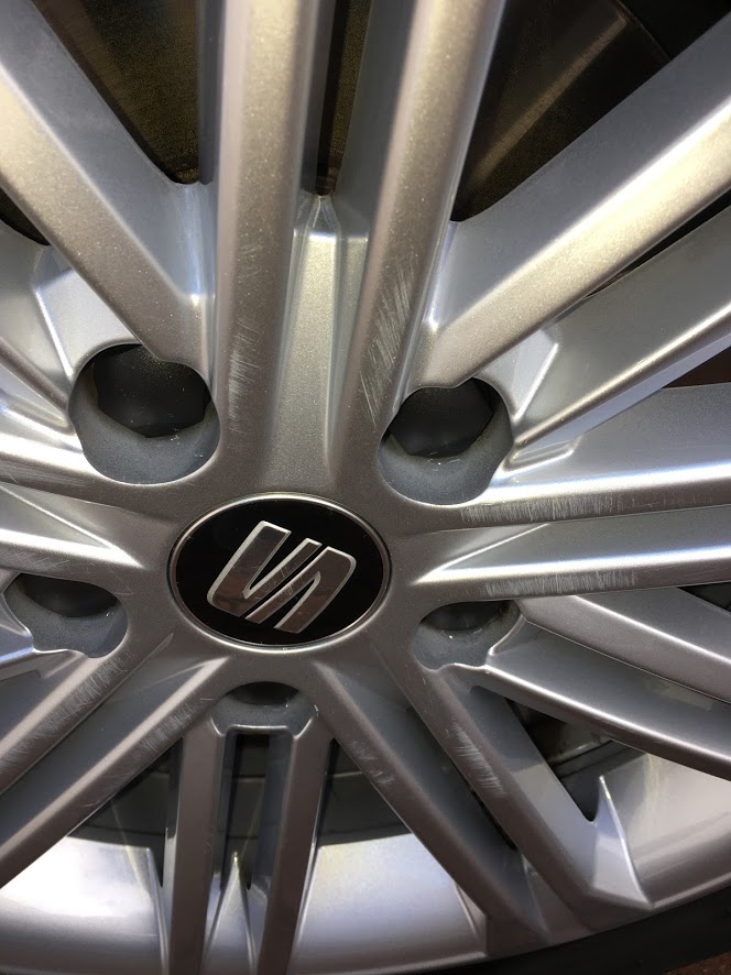

Discovered a slow puncture last Thursday so took this to a local garage which I've used a few times before for tyre replacements to get it fixed.
Washed the car yesterday as car was filthy following Storm Ali and discovered all these scuff marks which are concentrated round the centre of the wheel, you can't really feel them by hand and I've certainly not hit anything that could cause this. I'll be raising it with the garage in question first thing tomorrow though they'll probably deny.
Best bet for fixing this? Refurb or maybe a polish?
Not a mark on them previous so pretty gutted at the mo.

@nokiauk, your picture isn’t showing for me, so I can’t really advise on the best way to fix it, based on the extent of the damage.

Thanks, guess I should have been a bit more careful but having been a previous customer due to replacement tyres on 2 previous occasions and they are a Black Circles premier partner I expected better, I was in a bit of a rush due to the weather etc. but maybe I should have just gone to the local Kwik Fit. Hopefully pic is now attached and I'll see what happens tomorrow.

I can see it now.
That’s quite a lot of surface scratching, and it does look as if it’s been laid face down on a rough surface (concrete floor?), although the good thing is it doesn’t look like deep scratching; just light surface scratches.
If you have access to - or know someone with - a machine polisher, I think that’ll probably polish out and bring it back to the pre-damage state. I’ve seen more severe scuffs on car bodywork over on the Detailing World forum polished out and you’d never know they were there.
Probably worth speaking to a professional car detailer for an opinion. If it can be polished out, it’ll be less hassle than having to get the wheel refurbished and being without a wheel while the work’s done, especially if you don’t have a space saver spare.

Cheers will get original garages take on what has happened and fingers crossed they accept some responsibility. I have a detailer near my work who gets a good rep so will check with them tomorrow to see if the scratches would polish out.
Well original tyre fitters while not outright denying the damage basically said it couldn’t have been their machines and alloys are placed face up for tyre changing. and mechanical or dropped damage would be worse.

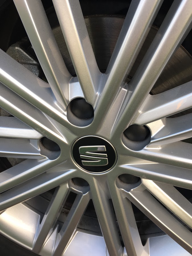

So took it to a detailer beside my work who machine polished it this morning while not perfect it is better.
With winter approaching I think I’ll leave it to the spring and possibly get it re-painted/powder coated then, with luck it can be matched.

It does look so much better. It’s just a shame it got damaged in the first place.
