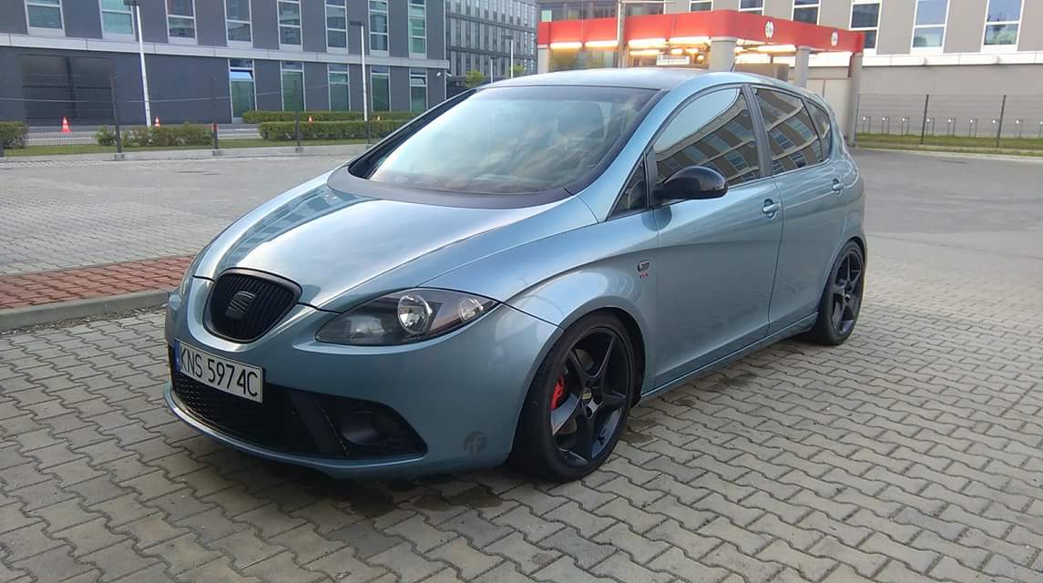

This might sound silly/dumb, but I'm deeply considering fitting XL roof rails to the standard version. Anyone maybe did or thought about that already ?. Don't want these sh**ty roof bars that go under the door seal.
Already have couple of ideas, but would be good to hear if someone tried it already.
Cheers,
Maciek
Here's my ride by the way :)
