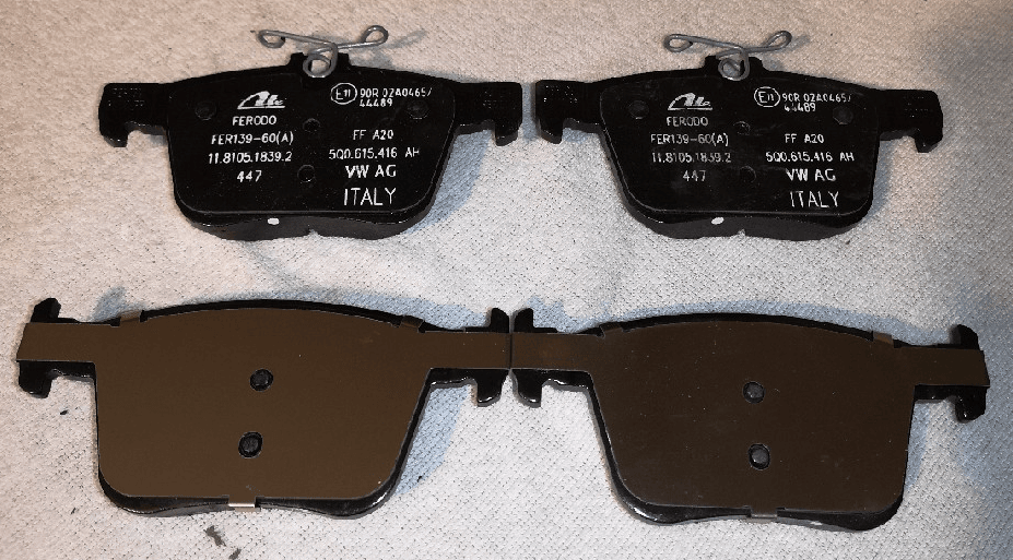

On these later VAG pads the stainless steel shim folds around the edges of the pad in contact with the carrier so will effect fitment, to help reduce the chances of the pad binding in the carrier.
I couldn't tell whether the carrier is modified over the previous version. I'm fairly certain the inside dimension of the 'hammer head' ear of the pad is unchanged which is the critical dimension of these type of ATE pads.
Example: 5G0698451
Yes, you have just reminded me of these "hammer end" shim/springs bits, I'm sure that the Polo with 288mm front discs has that type of pad. I think that my plan is just to buy a of the SS clips that fit over the carriers for the rear pads - like VW Group used to provide on earlier rear disc braked Polos.
