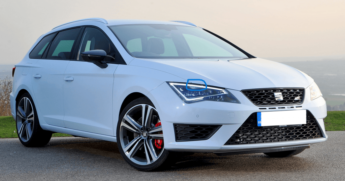

Just something I've noticed, I've seen a few Leon's with the normal looking bulb type front indicators.
On my 67 plate, I've got my DRL's doing the front indicator work, is this standard or maybe the previous owner coded it in?
I’ve not owned a Leon but I think on pre-facelift Leons, some trim levels had halogen headlamps as standard, and I suspect on those cars the front indicators are a normal bulb.
Reactions: nd-photo.nl
The pre-facelift cars with LED headlights had DRL's but with separate halogen indicator bulb.
If you have a little orange section (where i have highlighted in blue) then you have a bulb is my understanding.
Update for future reading - No its the rear that has bulb on LED Lights, front is LED.
Reactions: Mo_86
On your facelift (generally 2017 onwards) LED headlights the DRLs and indicator are combined.
On the PFL (up to 2016 generally) LED headlights, the indicator is a separate LED at the top of the light unit, as pictured by @tracktoy.

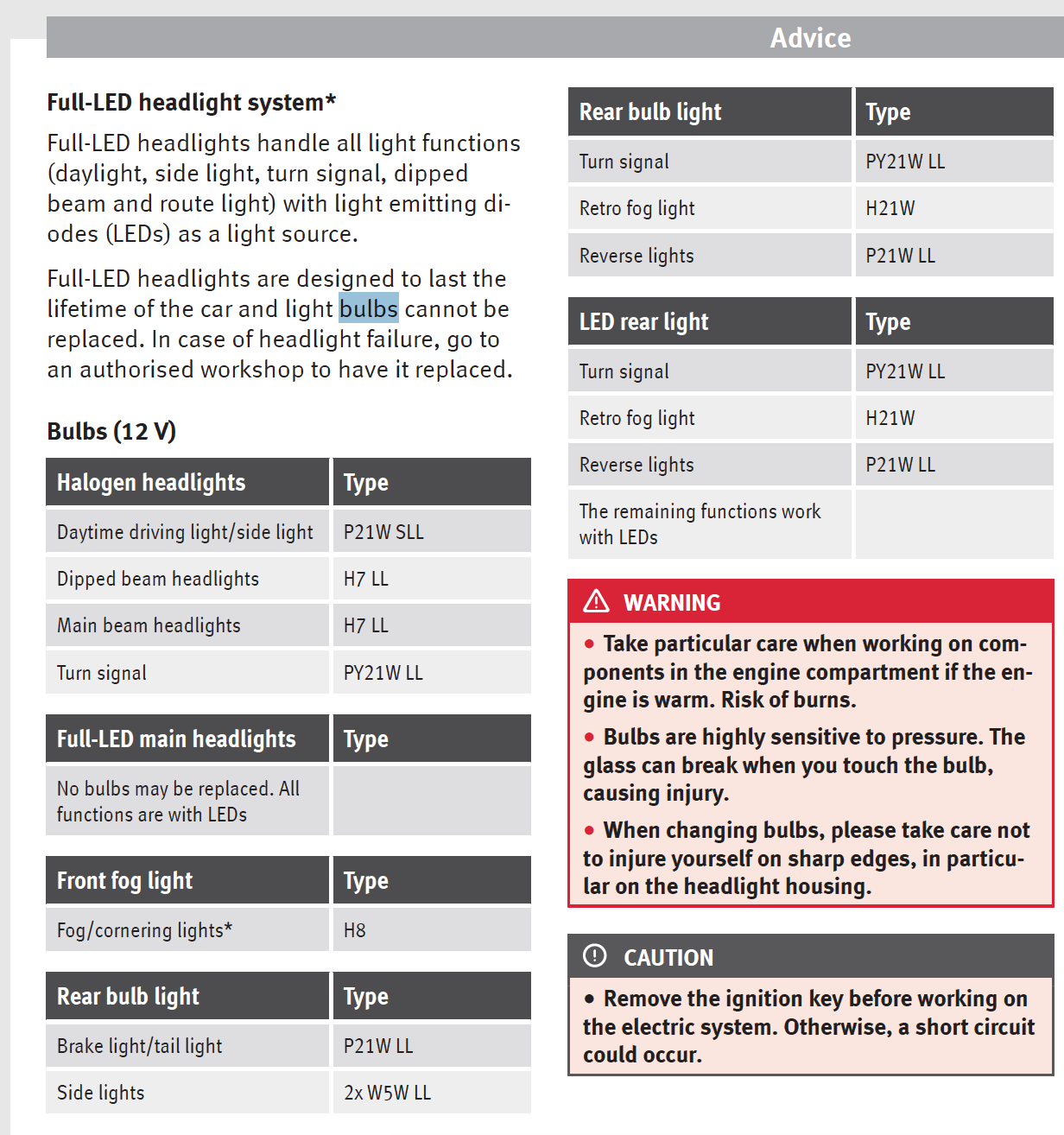

Yes my bad its the rear LED lights that have bulbs
screenshot-2019-01-11-at-09-04-43-png.3923

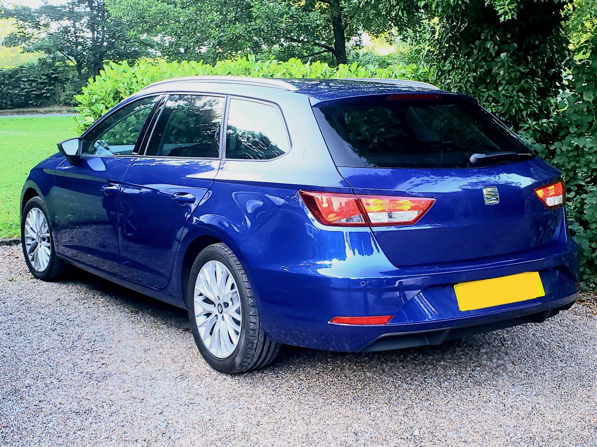

I didn't even look at the rear indicators, so these are the standard ones on the face lift?
Reactions: Craig.
Without checking, tail lights come in 2 flavours, full normal bulb or LED/bulb mix (FL only have a bulb for the reverse light) and you have LED/bulb mix and what looks like an aftermarket LED replacement bulb in your reverse light.
Yeah the previous owner did a few little mods, led bulbs, some obd stuff like dials illuminated all the time, needle sweep etc

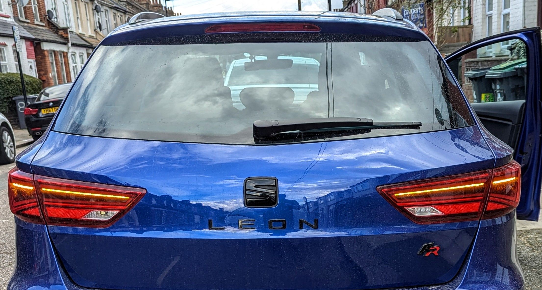

Standard for LED light package. Without the LED package (halogen not LED headlights) the rear lights have standard bulbs fitted
