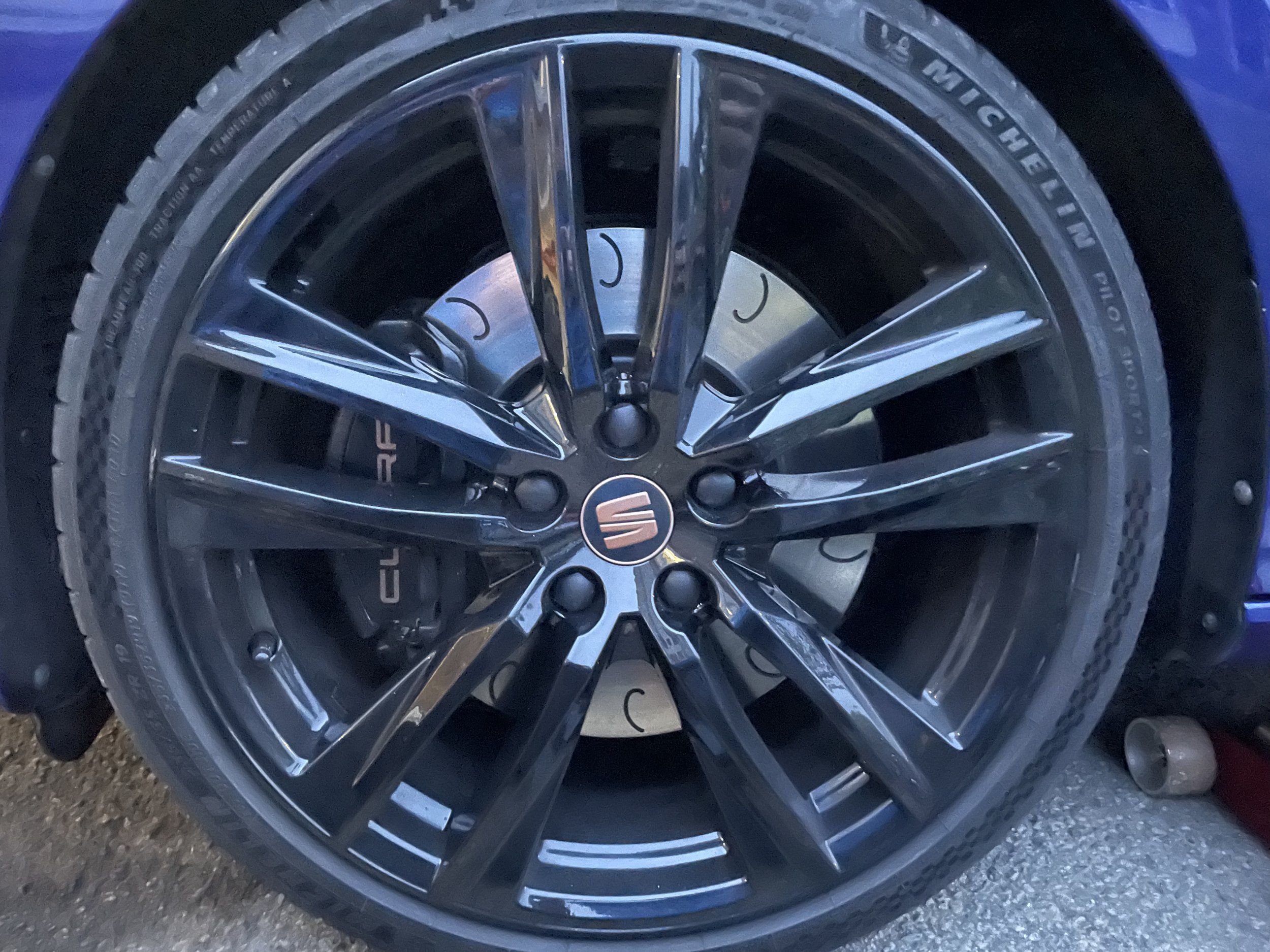

My RTS performance discs have straight vanes and a similar design to MTEC.
The specialist that fitted them had them on his own Mk7.5 Golf R Estate and I was informed that they were directional (but for the J hook design). Long story short they’ve been fitted in the direction as per the photos below.
Albeit, the AP racing design upon which they’ve been copied has the J hook with the opposite orientation (but these will have directional vanes).

This gets weirder for me.
Because with the Mtec you can not fit both discs the the J facing towards the front of the car.
With both discs flat on the floor one disc has the J like that and the other has the L that way.
Errr
So they are handed
J will go on left side, L will go on the right side.
So they will face front of car.
Or am I missing something
Reactions: Compo1
Might be worth posting a photo.
I would be inclined to agree with at @Damo H but depending upon which disc is fitted to what side you can change the orientation of the J to an L or vice-versa.
There on the car now. I'll take pics tomorrow and post them i hope im not been totally dumb here :oops:
