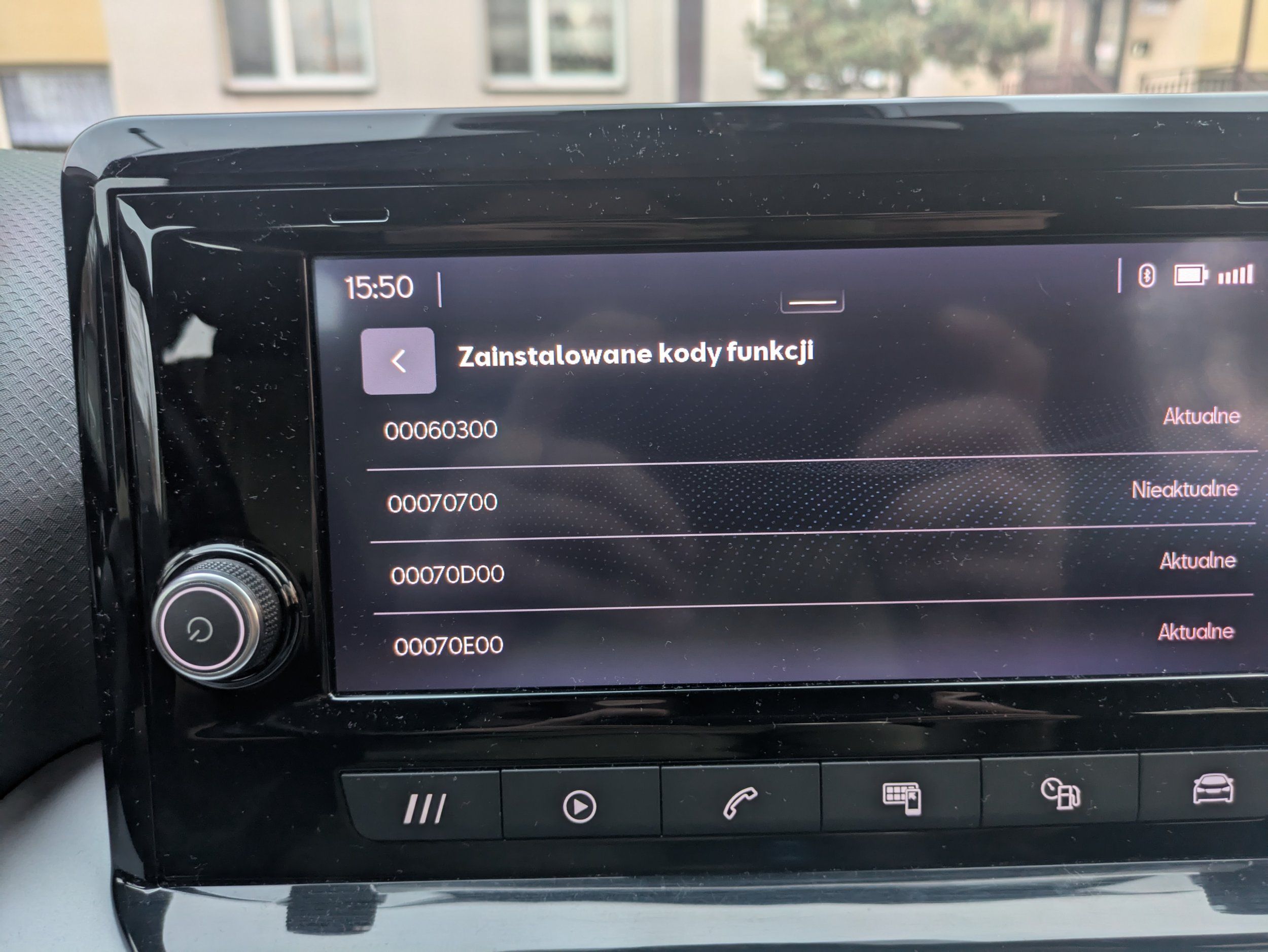

Hello. In my car settings I do not have the Wifi Hotspot option. According to the instructions, there is a Wifi module in this car. I have a Seat Connect and it works normally. I also purchased a data package. I have System Media 8.25'.

FeC Code is normaly 0x00070700

It's 2021 manufacter but its model for 2022 year. I have OBD11 and i on all option in 5F with LAN.

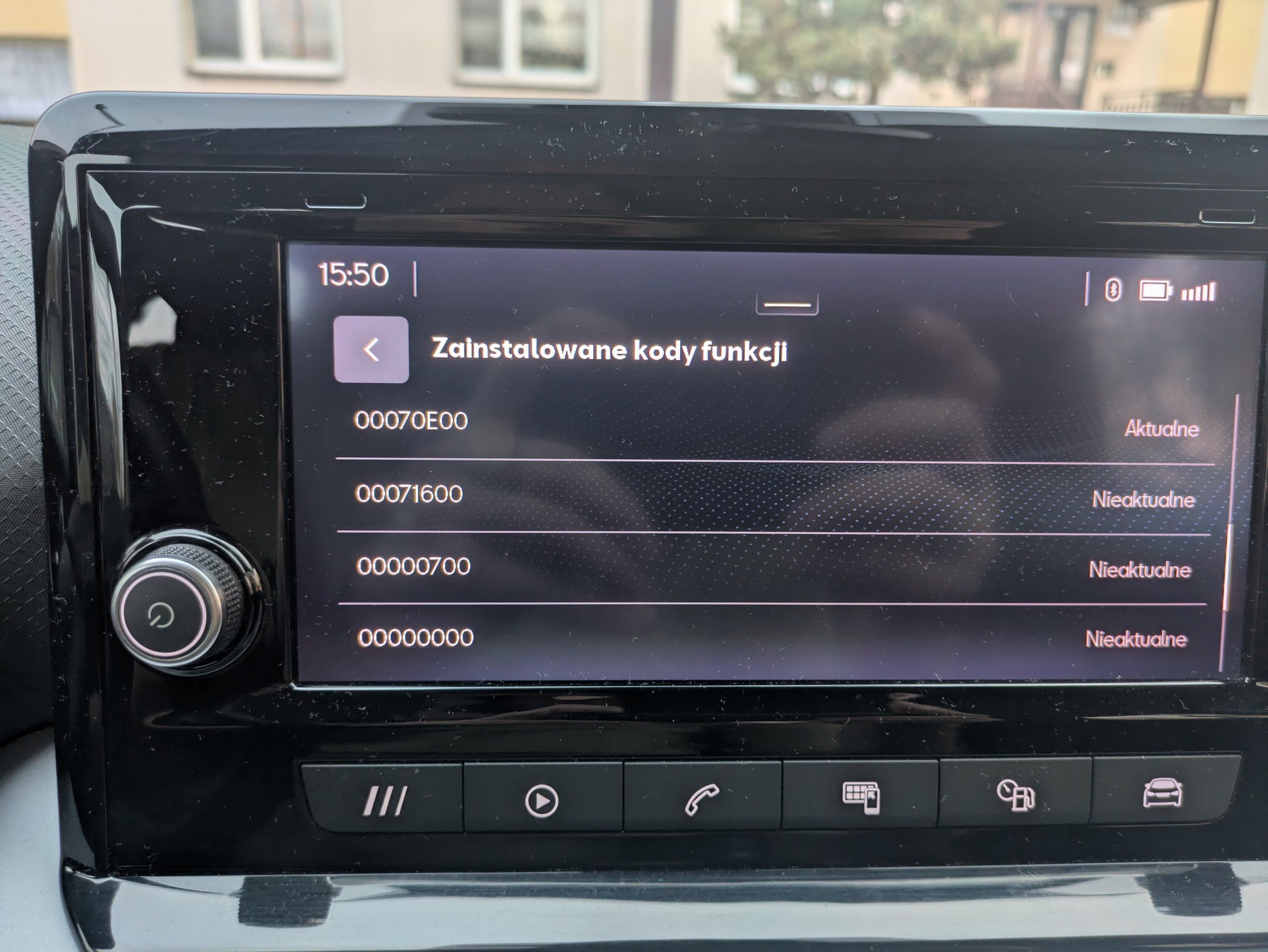

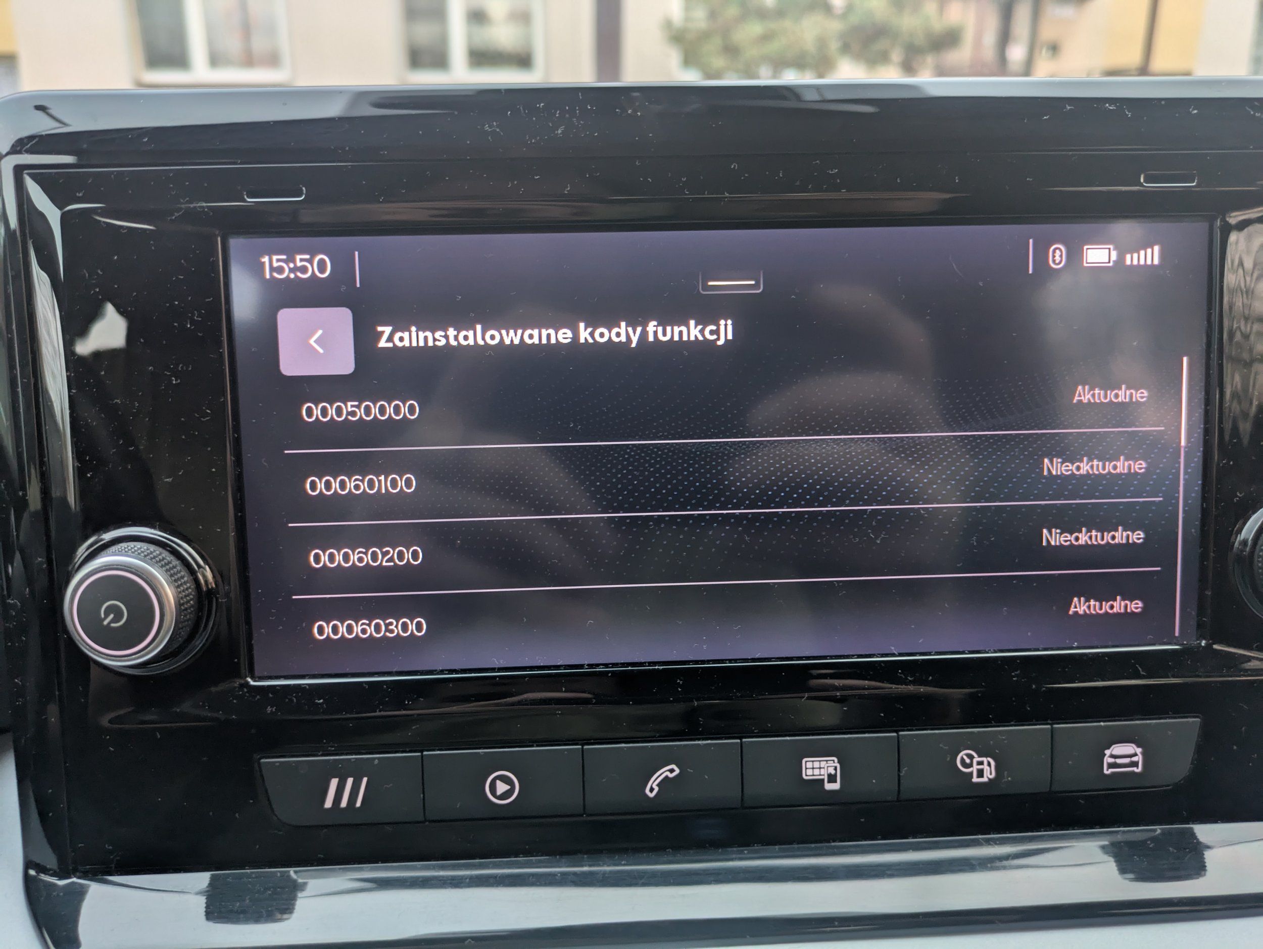

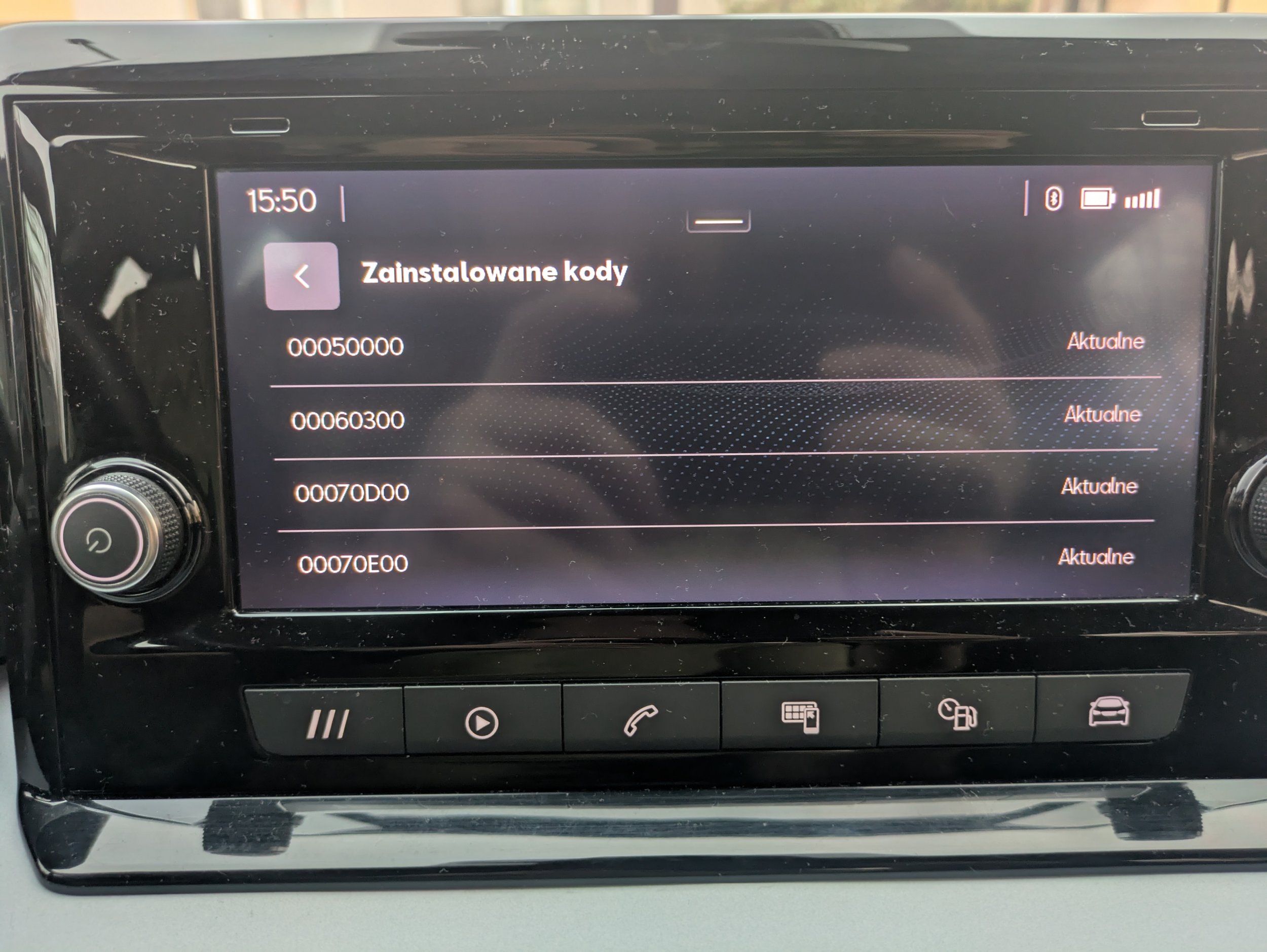

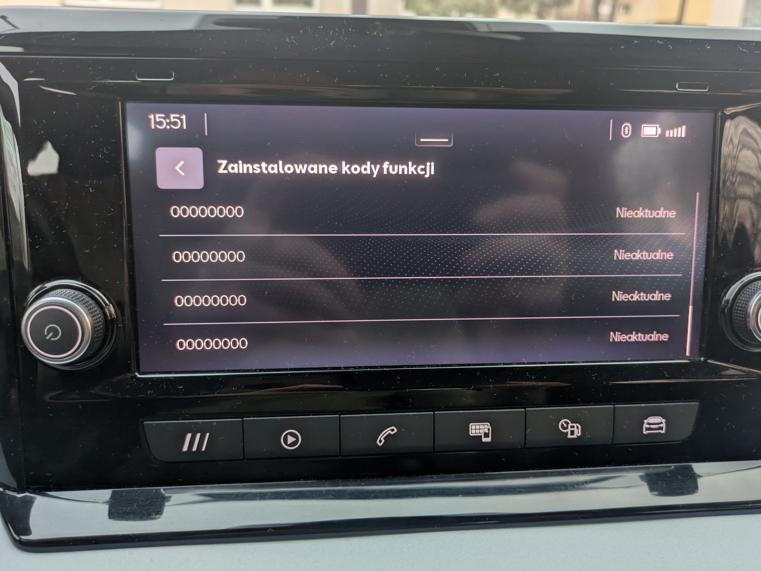

The first photo is instaled.

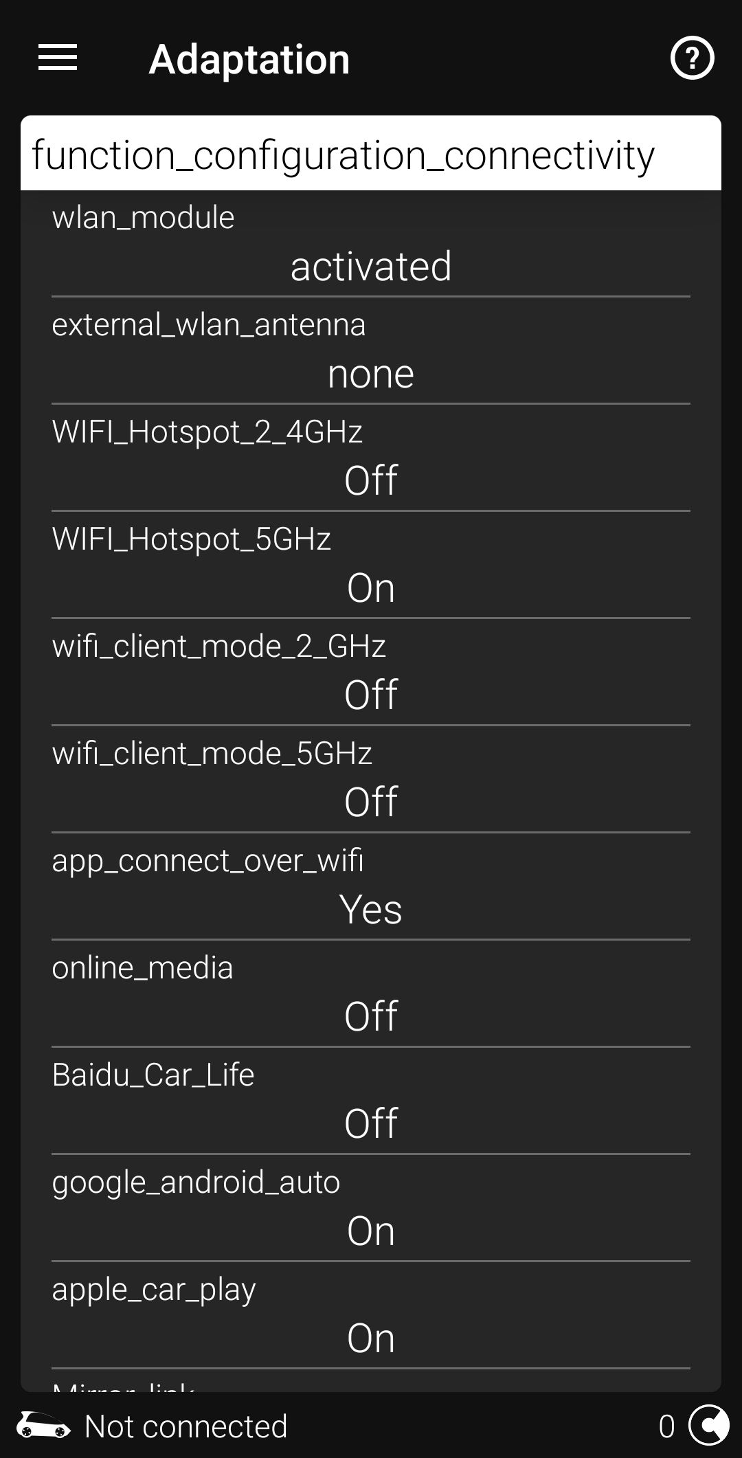

If you have obdeleven, check module multimedia 5f go to adaptation, search for function configuration connectivy
I will attach a screenshot of my configuration. If you don't have android auto enable try to enable it and maybe you get wireless android auto.
I don't think it's possibly to activate a wifi hotspot in the entry level system, I tried and I have searched alot about it.
