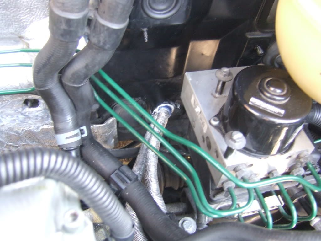

where did you make the hole for the cables to go through the firewall?? have you got any pics of it from inside?? and also what size is the hole??

Did mine today. Very happy with the result!! Removing the shifter box was a right pain in the ass but I managed to remove it without removing the downpipe........
The hole I made for the cables to run through the firewall provides a nice sound of the turbo spooling and the dump valve :D
