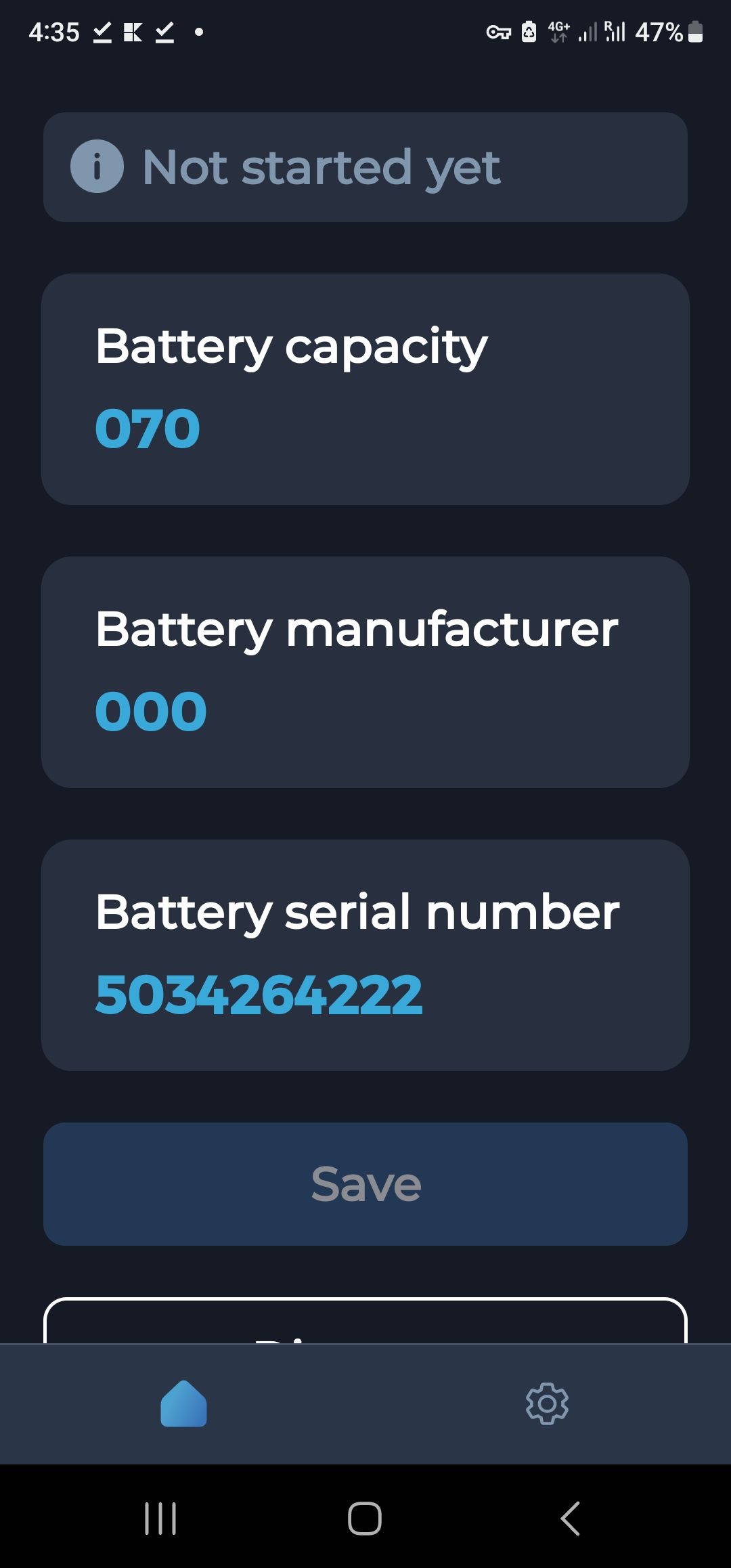

Thanks for answering,but which OBDII have these options or which one is good for this purpose.the good and cheap one.thankscheck out http://www.cupra280.co.uk/Battery Coding.html screens are from OBD11 But the basic attributes are the same across all tools I believe.
OBD11 is a make of OBD2 Reader that supports basic scanning but also if you have the pro license then you can code in battery and make many many changes to the cars setup. https://obdeleven.com/de/produkte?carBrand=Seat.Thanks for answering,but which OBDII have these options or which one is good for this purpose.the good and cheap one.thanks
Where I can find the battery serial number of my CONTINENTAL amg 70ah.OBD11 is a make of OBD2 Reader that supports basic scanning but also if you have the pro license then you can code in battery and make many many changes to the cars setup. https://obdeleven.com/de/produkte?carBrand=Seat.
Basic OBD2 readers dont normally support coding, if you have VCDS or access to it you can code it yourself and I think that Carista also supports coding new battery
You dont need the physical serial number it just has to be different to the previous one so the car knows its new. Just increase the last number by one that will work.Where I can find the battery serial number of my CONTINENTAL amg 70ah.

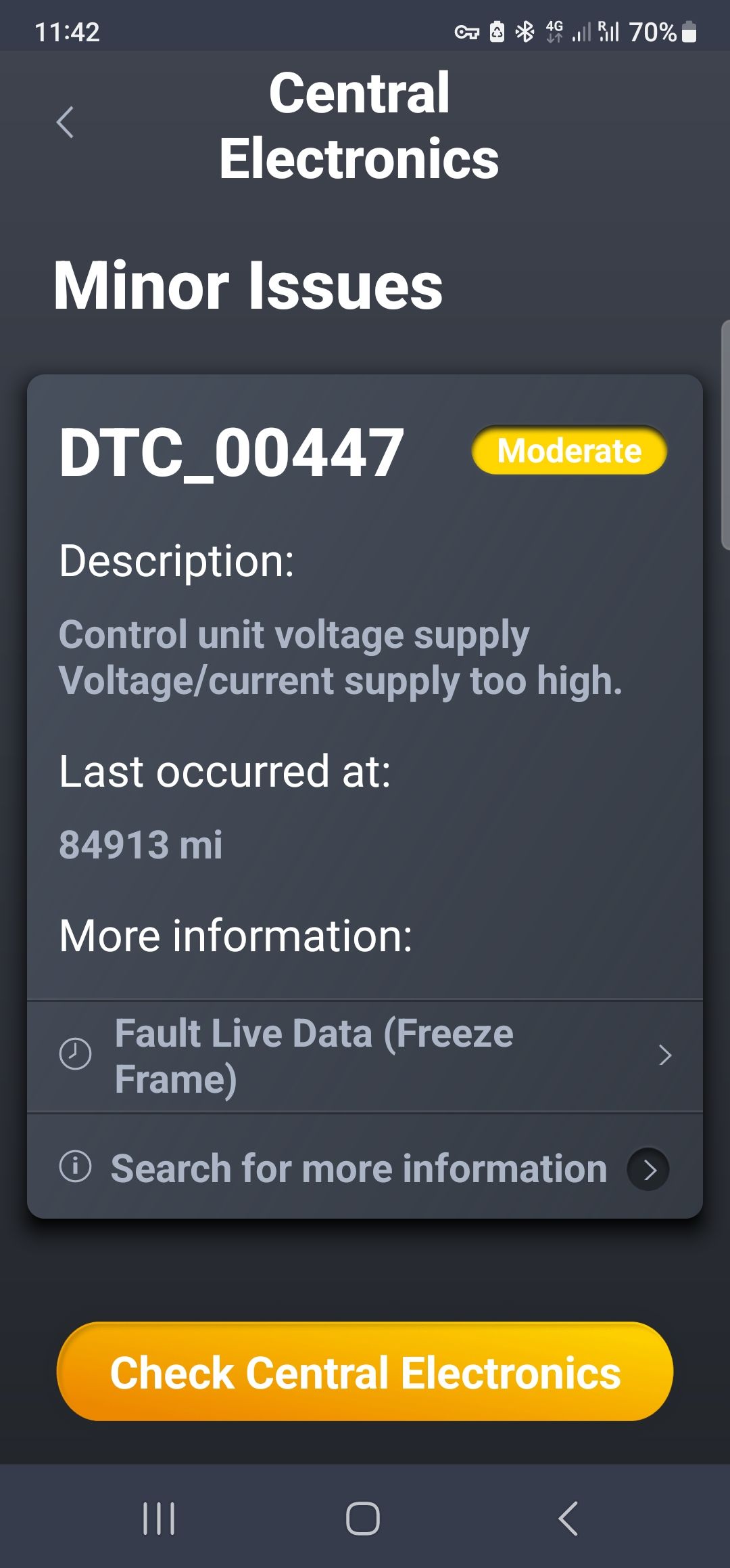

Thanks,for your reply,and what about below pic battery manufacture?and I scanned with OBD2 and says that you battery voltage is high.You dont need the physical serial number it just has to be different to the previous one so the car knows its new. Just increase the last number by one that will work.
does it give you a DTC Code, does your car have start stop, have you tried clearing error does it come straight backThanks,for your reply,and what about below pic battery manufacture?and I scanned with OBD2 and says that you battery voltage is high.
Yes ,I have Seat Leon 1p 1.2 TSI 2012 start Stop.does it give you a DTC Code, does your car have start stop, have you tried clearing error does it come straight back
I don't know the before one.here I can share the code.i will share complete scanned codes.Not seen this before but if you share the DTC Codes that might give us a clue.
