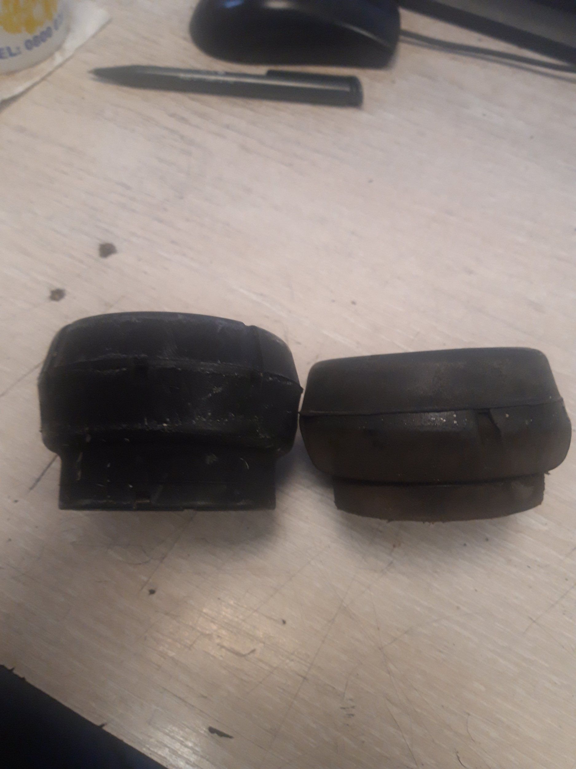

I replaced my strut top mounts recently with OE items from TPS. Made the car feel a lot more mmmm.........
Cant put my finger on it but it feels better.
New and old v v v
New and old v v v
I'm sure it's just psychological or something. No difference there...
