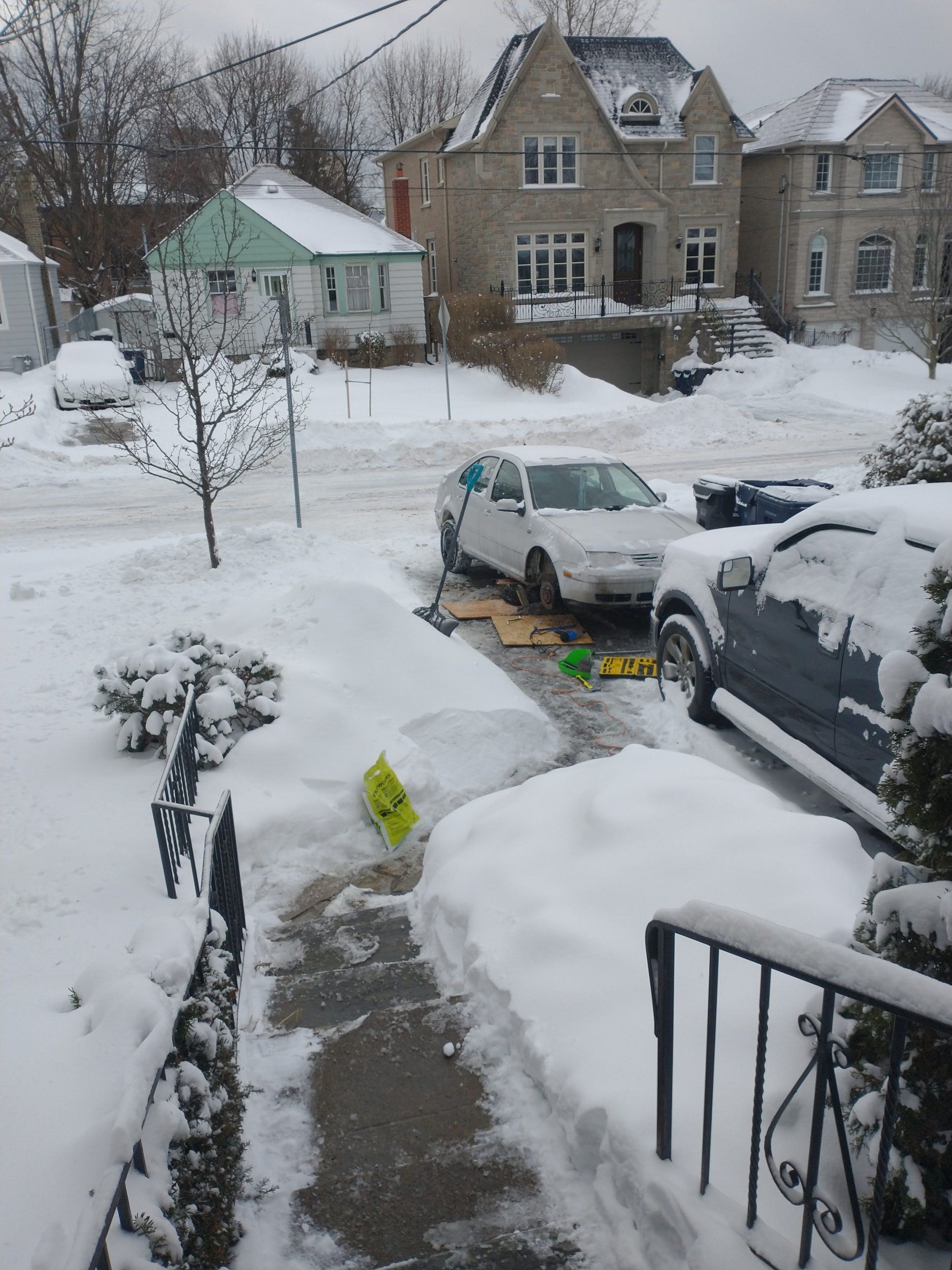

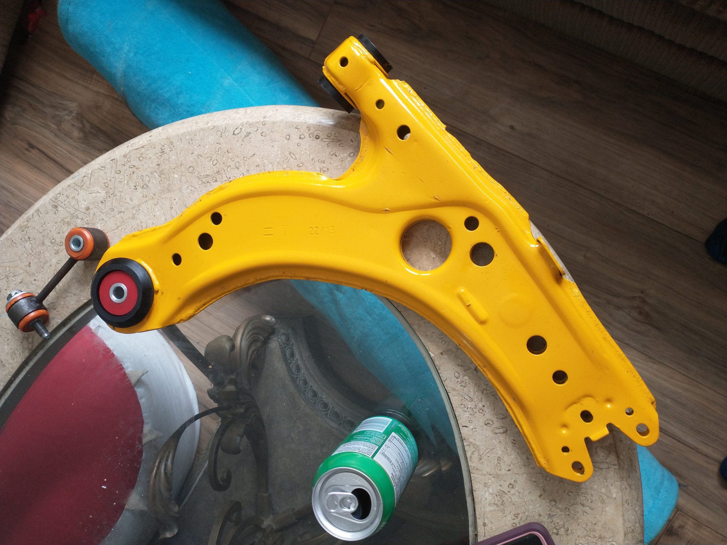

So last week I ended up fitting the following parts to my Jetta back in Toronto.
PSB mk4 pressed arms kit
PSB 21mm ARB bushes
Flowflex ARB droplink bushes
Brand new Meyle golf inner and outer tie rods
It feels so much nicer to drive. The front end now tells you where it is and what it's up to. Just gotta sort the dogbone mount as 1 bolt snapped, new strut topmounts and bearings.
Then front brace, rear ARB, maybe a TT rack and solid bush and maybe a 1.9tdi swap in the summer
With 16 inch steelies on and winter tyres the car still flops around a lot but at standard height and with said wheels it does feel better.
Let's see how Toronto's roads treat those new bushes. I'm going to purchase a set for my Leon and the TT arms I have.
