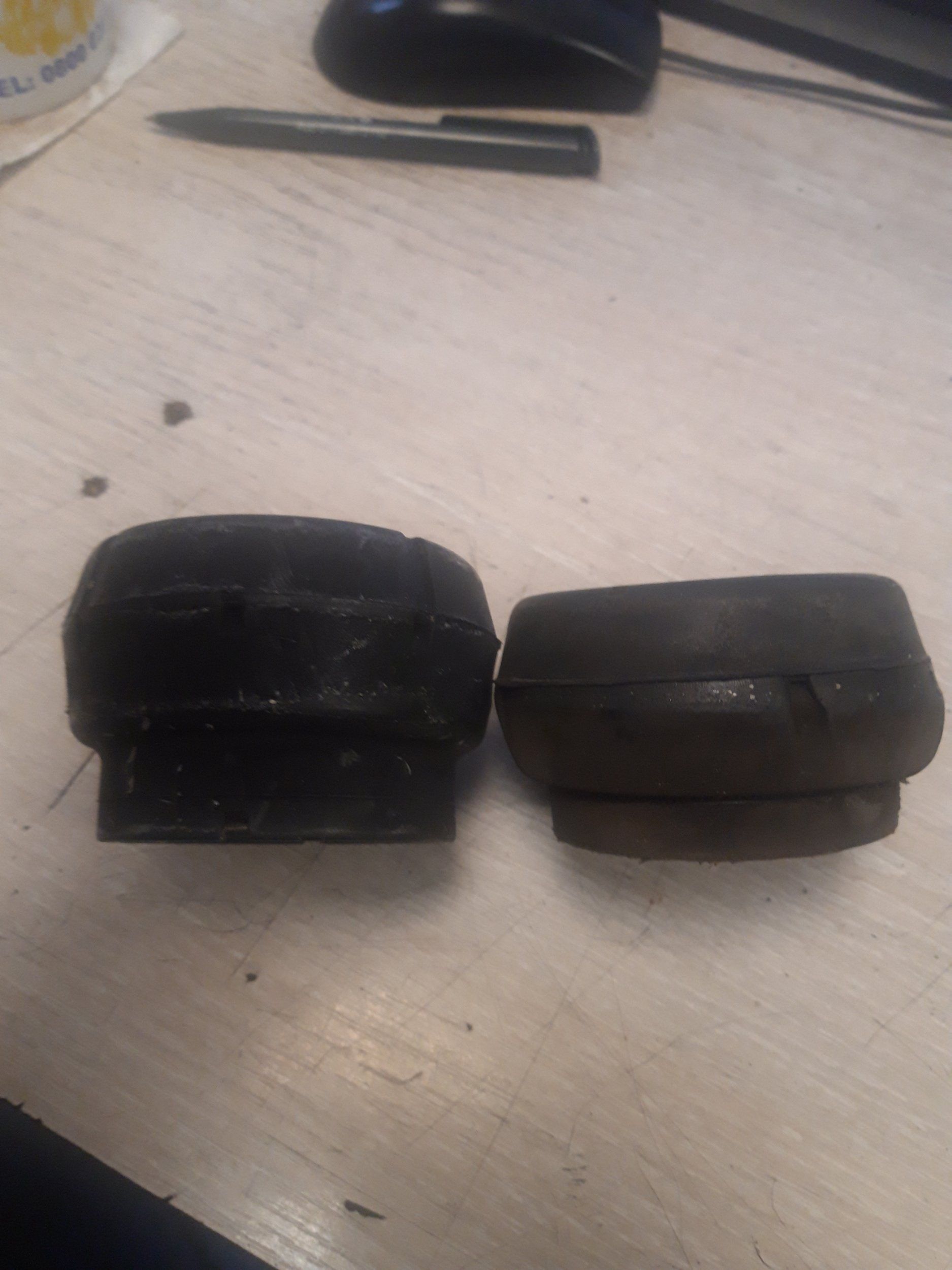

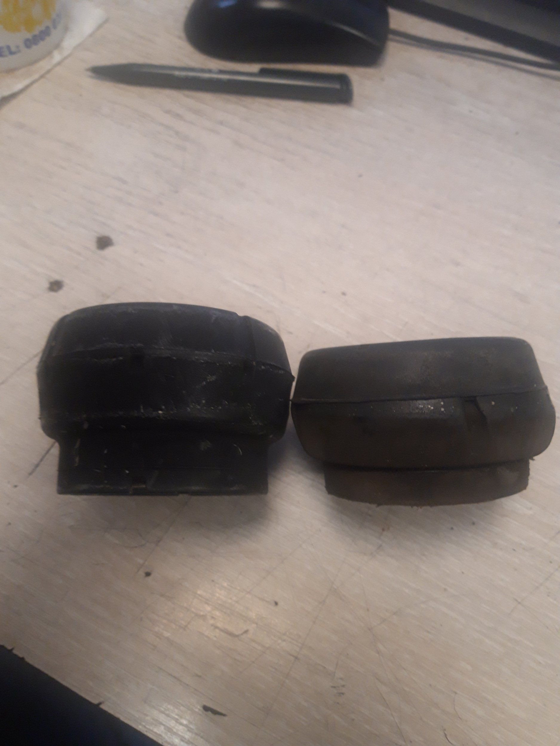

Old v New lol

I bought complete strut top kits from TPS.
I think the oe ones are made from a stronger compound rubber as the cupras are a sportier car.
Id go oe if i were you.
You may buy some off Ebay etc or aftermarket that'll fit but you wouldn't be sure of the rubber quality/compound.
Think the kit is new bush, top bearing, nut n washer.
Was about £100 for the 2 kits if memory serves.

Hard to say. They both look the same
A definate hidden horror though.
To be honest it looked better than I was expecting and the bearing was fine. Nearside still needs to be done though - had a van blocking the street so I couldn't work in the road without getting buzzed by cars. It's definitely squashed though. Looking forward to a road test tomorrow.
