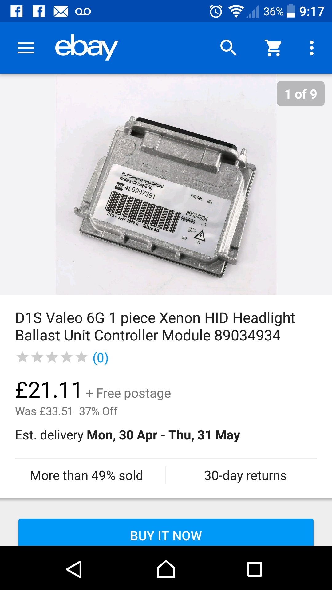

I've been told this will sort my headlight problem.
As far as I'm aware, the ballast above provides the power for the xenon bulb. The cornering function is done by the AFS module which sits behind the bulb (thin black box) and the levelling is done by this module: https://www.ebay.co.uk/itm/Audi-A4-...807737&hash=item1c9f3b719f:g:ANsAAOSwRQxaaGAq
A scan with a good reader will tell you the part number of the faulty component. I use VCDS, it cost me £270 but it's worth its weight in gold.

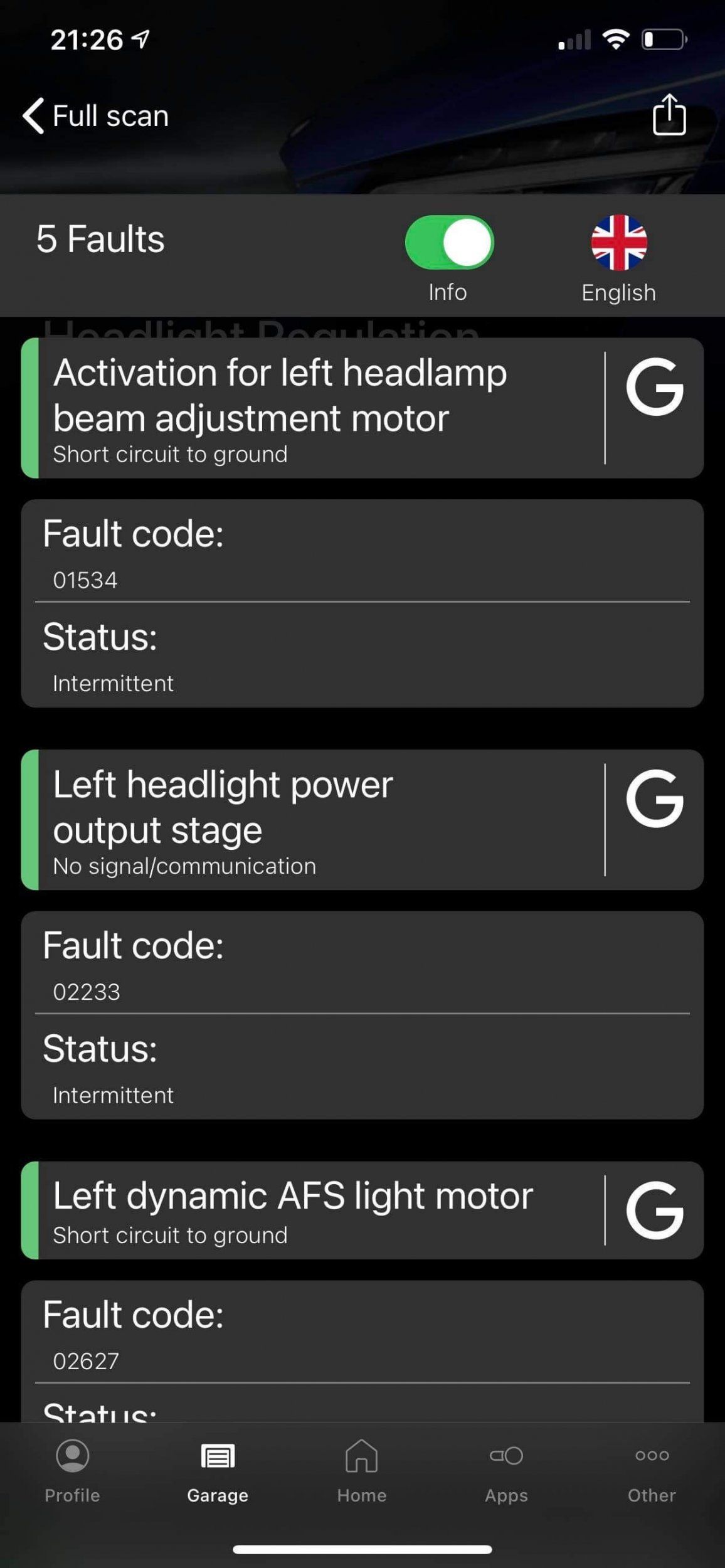

When the AFS module gets a fault, it takes the insane action of pointing your headlights inwards and down!! You would have thought a better "stock" position would be centred and low. But anyways, this was caused by water ingress in my xenons which shorted the AFS module. The big issue is, if that is the case, you need to find and stop the water getting in before replacing the modules as they aren't cheap.

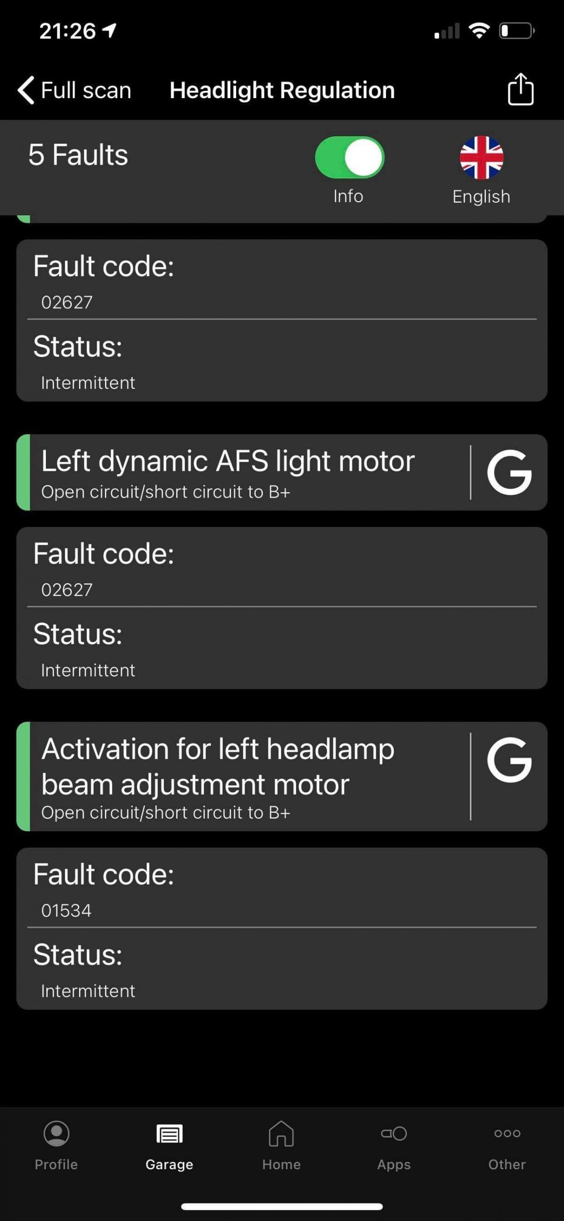

soreplaced my battery today and there was loads of water under the battery tray not sure if this is a cause but I noticed water build up under neath the passenger side headlight, thinking maybethe water could of been leeking from there down..?! I have now learnt aboutdrawing water from under tray, I scanned with a decent obdeleven and it came up with below codes so thinking about replacing module...any ideas or knowledge in this wouldbe greatly appreciated,
thanks Andy
