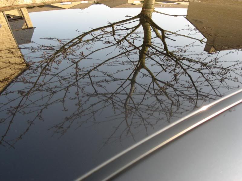

Anyways i still had to deswirl my roof as i was saving that for rotary practice but couldn't wait any longer
So SFX 2 pad with IP soon sorted the Swirls, although there is plenty of deeper scratches on the roof which is alittle dissapointing, will need wet sanding to really sort them, damn prevoius owner with a water blade !!

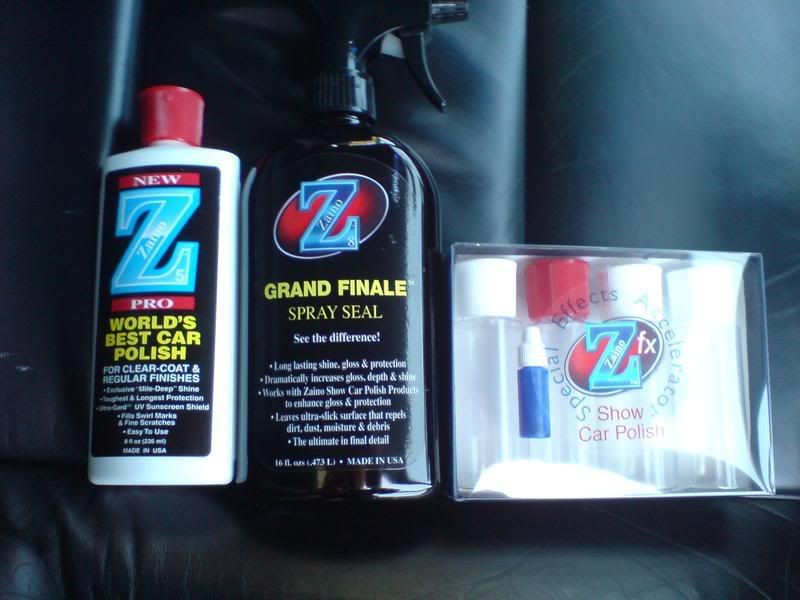

Next I applied a coat of Z-8 to the car in prep for the Z-5 Pro
Now the Nerdy bit

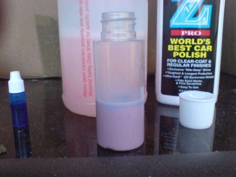

Z-5 Pro in the Mixing bottle (coincidently that was exactly enough to give the Leon 3 coats, which was abit of luck)
ZFX added to the Z-5 Pro .... 4 drops worth
A couple of the Zaino mix curing

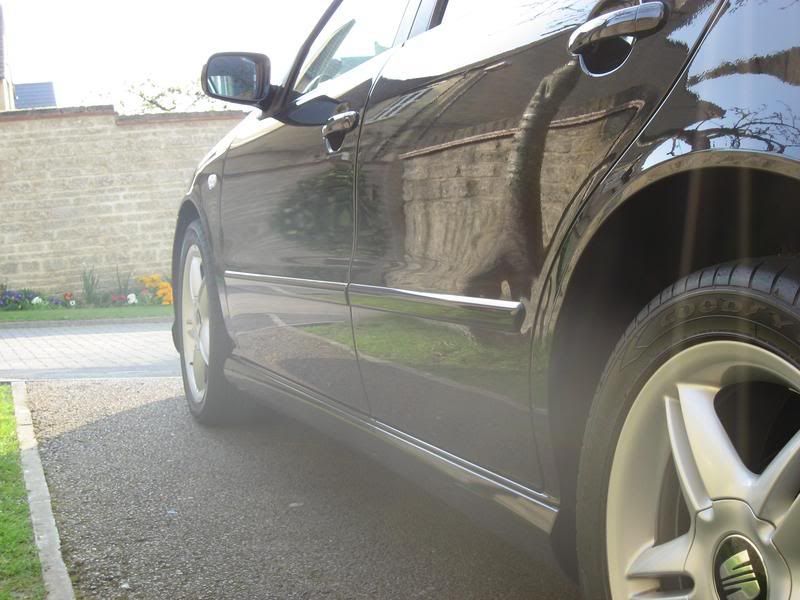

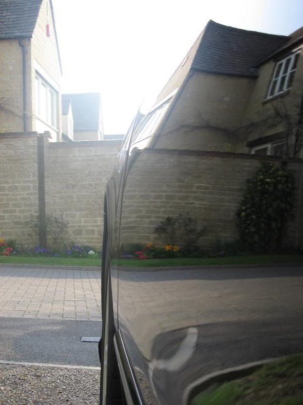

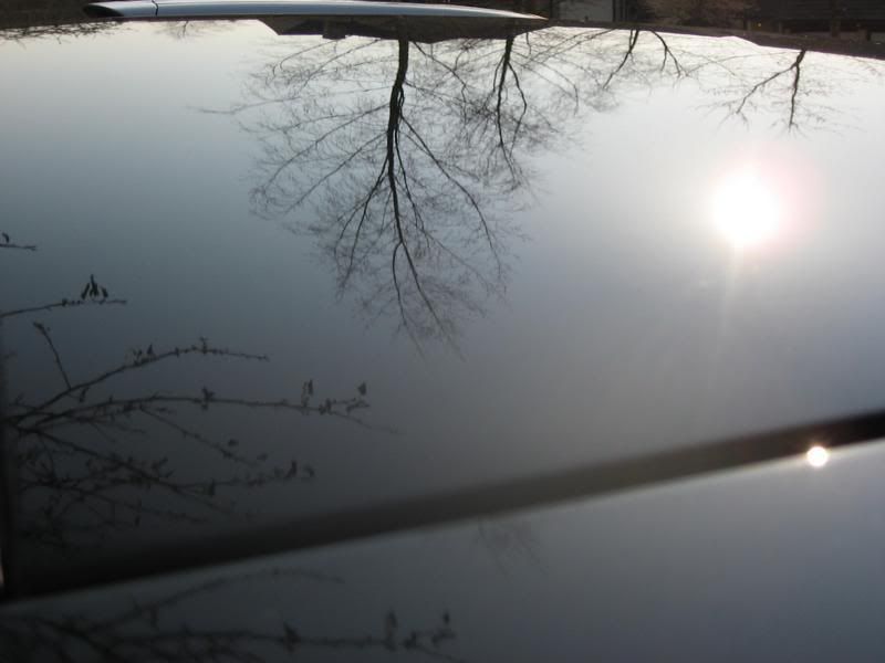

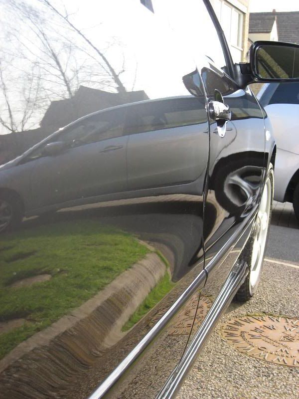

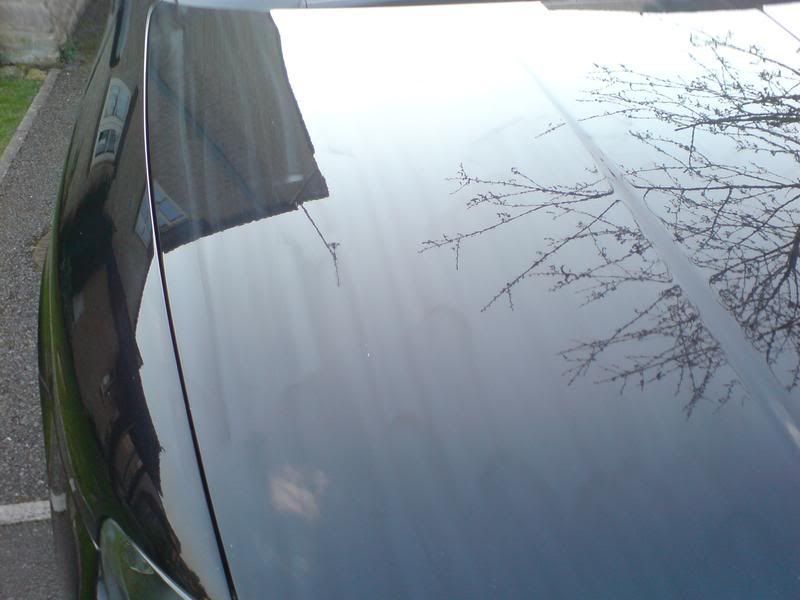

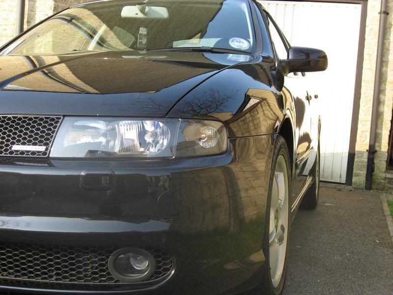

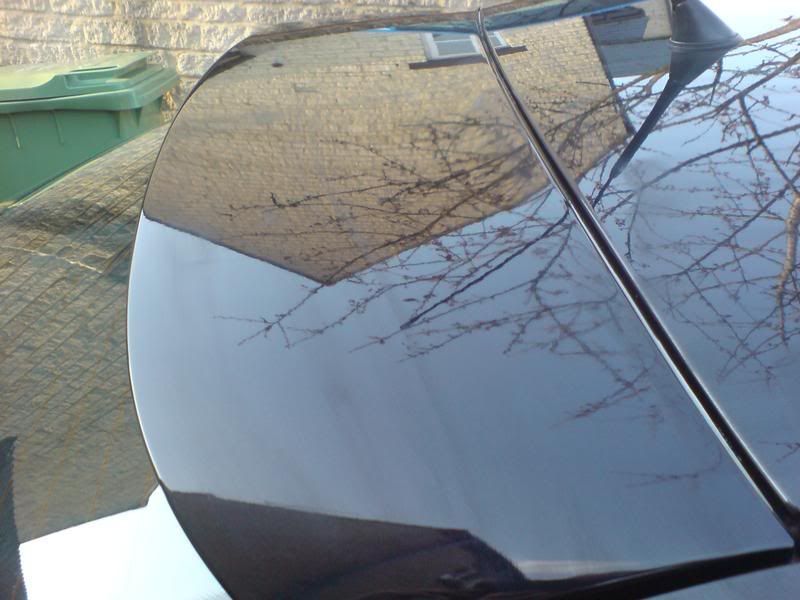

So got up this morning a took some piccies, pleased to find i hadn't missed any bits either
Tyler Owen
Overall i'm dead chuffed with the slickness of the finish, worth all the effort as well, If anyone is thinking about doing it, i'd recommend them to go for it

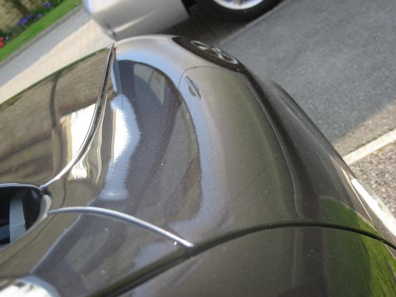

I seem to be able to get a mirror finish on all BUT the boot - the paint looks like it's covered in lots of tiny dimples whereas the rest of the car comes up a treat.
hmmm i'd suspect a respray or a smart repair by the sounds of things :(
does it get rid of swirl marks?? or anyone know anything that does??
No Zaino won't remove swirls you'll need a polish like Menzerna Intensive Polish (P091L)
Has enough cut to take out swirl but doesn't has as much lubrication as some of the other Menzerna Polishes so will be easier to break down by hand :)

Badges weren't straight so i took them off .... there's 2 marks on the bumper either side of the number plate where it looks like something has been repaired ... dunno but i'm sure once the PC arrives i'll get it looking like the rest of the car :)
