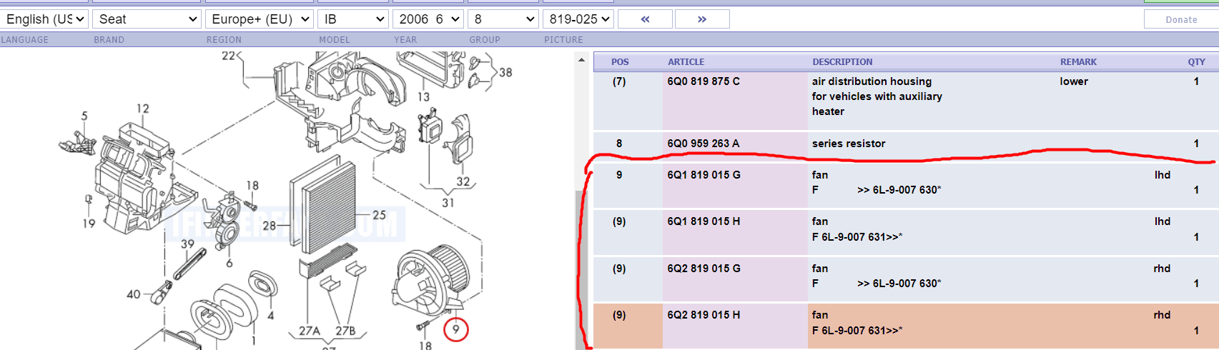

I went to ETKA to see the fan references to go to the auto doc to see prices and what was available, the references on ETKA are these:
6Q1 819 015 G - lhd
6Q1 819 015 H - lhd

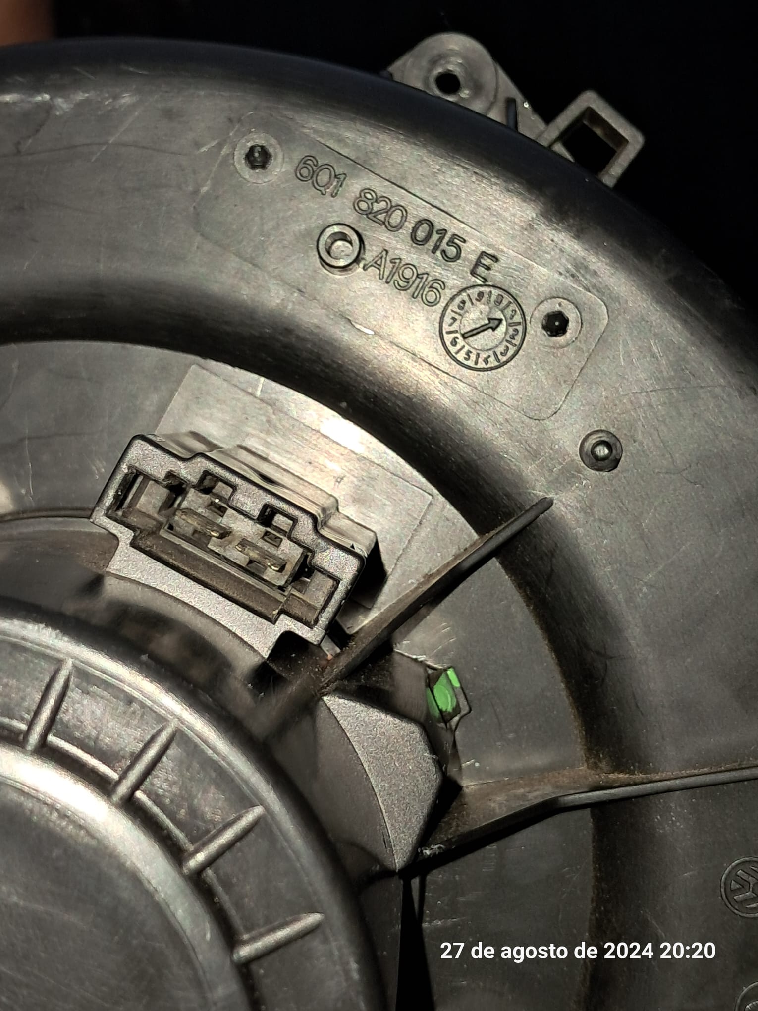

With all this, I decided to dismantle the glove box and start by taking the fan motor out, to try to understand if it was working or not, with the motor out, I took the opportunity to check its reference, and here is the reason for my confusion, the The reference for the part I took is (6Q1 820 015 E), this part has the VW symbols etc. so I assume it is original from somewhere, now when purchasing should I buy the reference for the part I took? or the references that appear in ETKA?
Whats the different between all the part numbers? and the letters?

Go with the part on ETKA - it should always give the most up to date or revised part numbers, unless you can find on that's exactly what you have and its cheaper. its probably just a small change or revision
