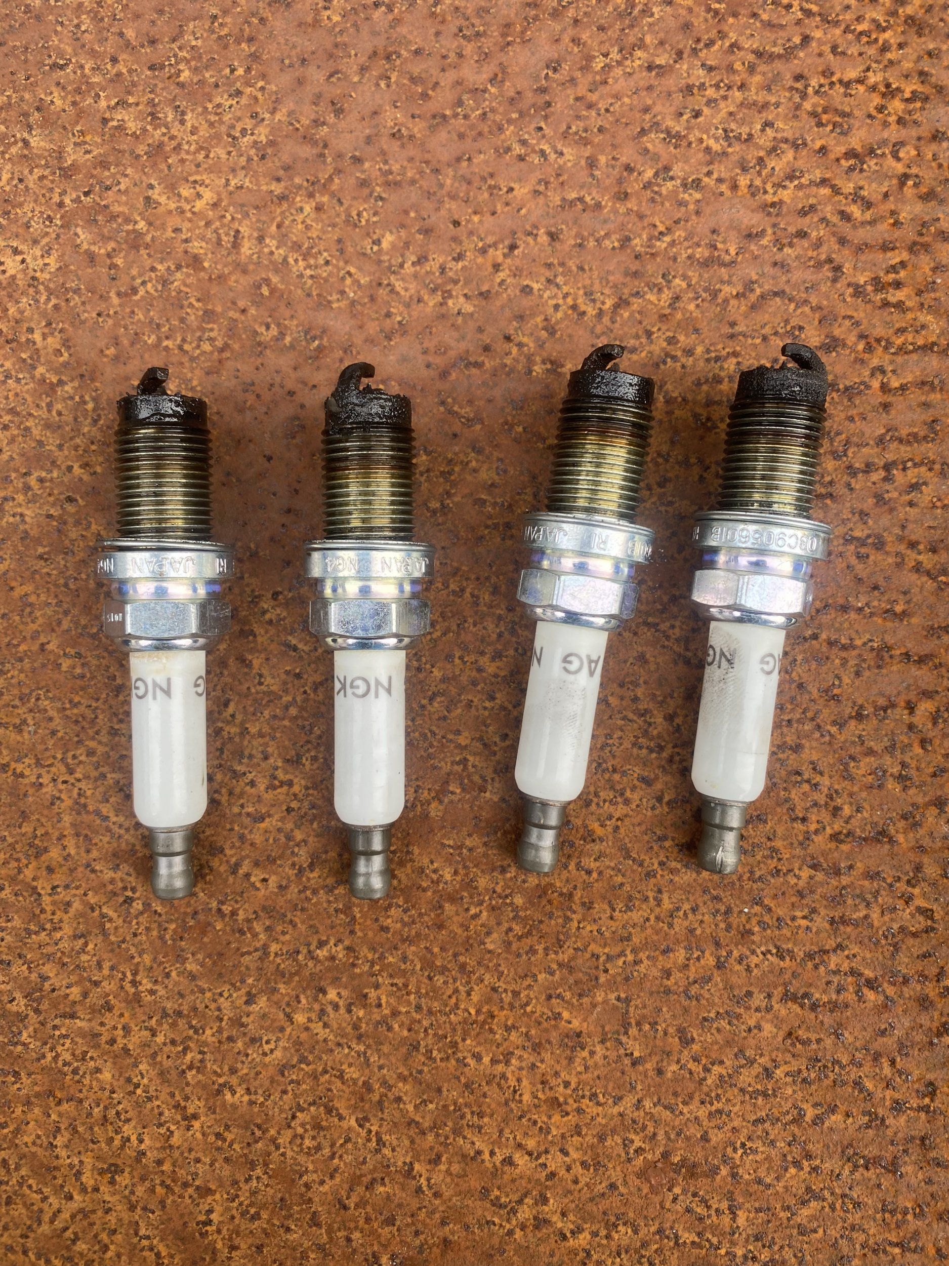

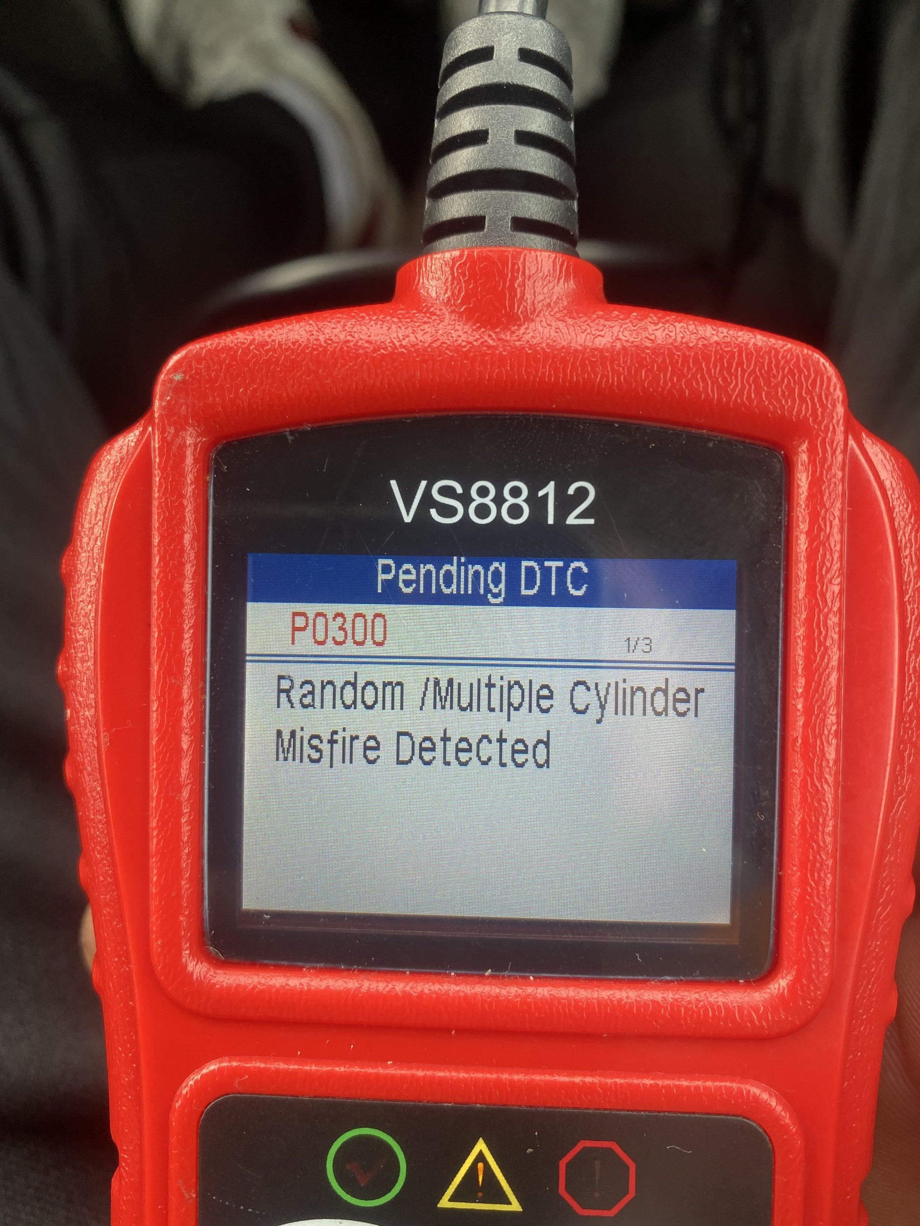

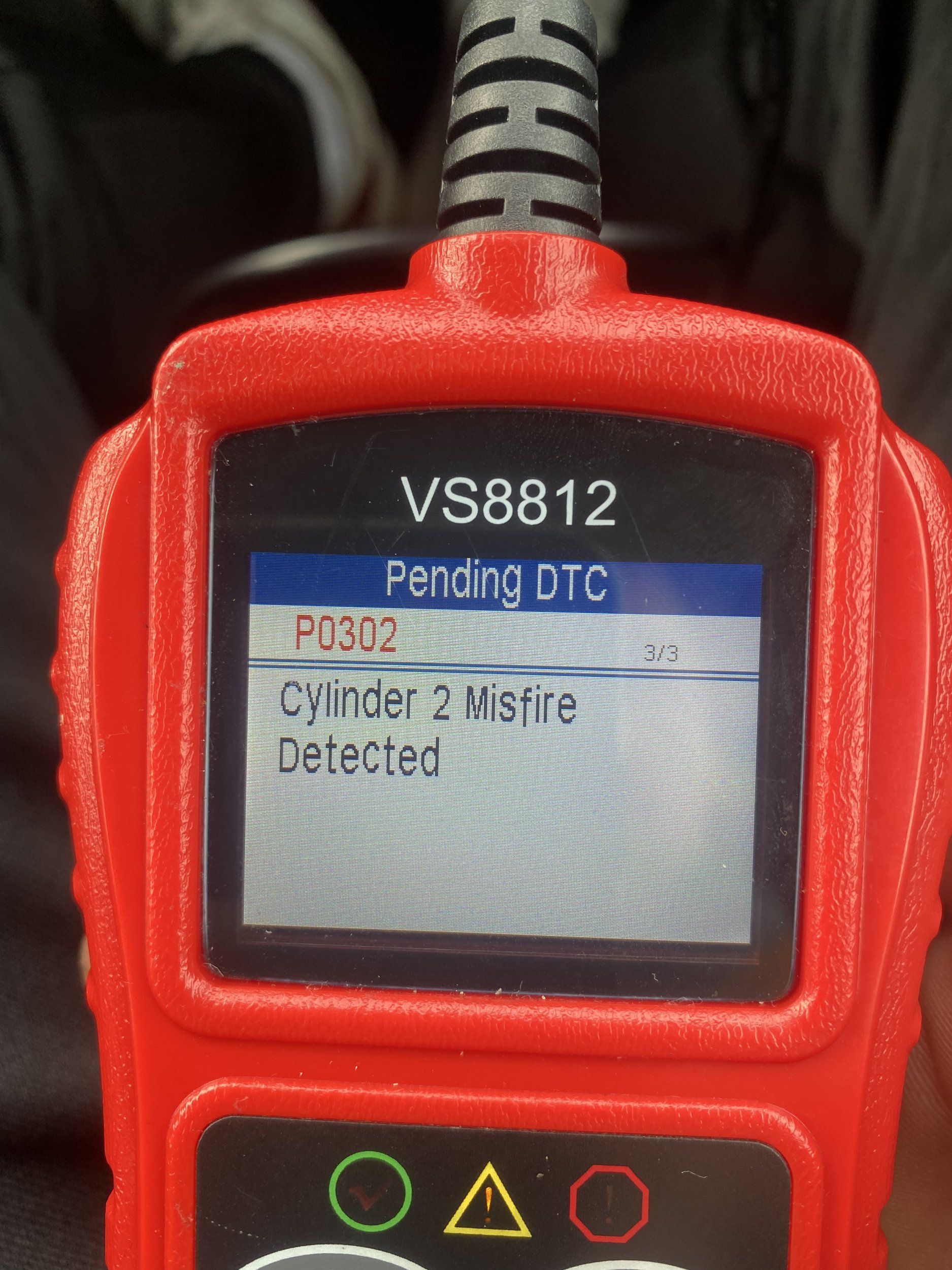

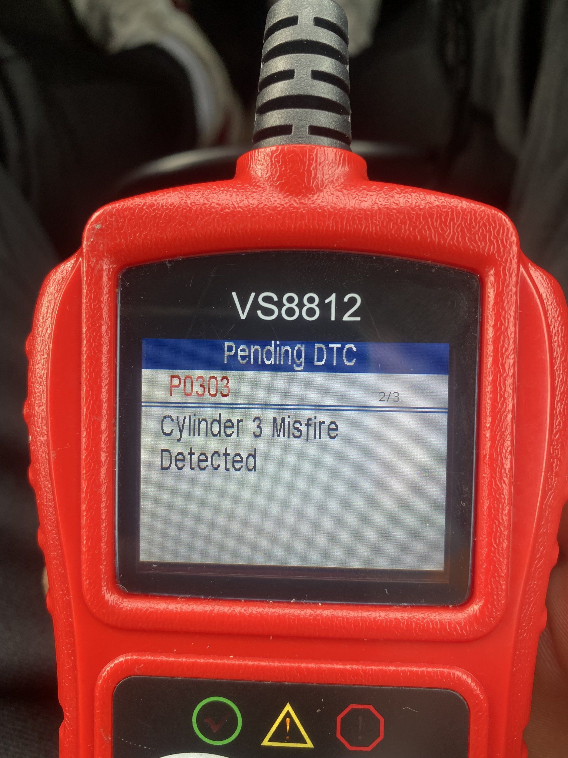

Has a miss fire at higher revs occasionally, I’ve changed the plugs the NGK ones gapped at 0.6. The old plugs (pictured) from 1-4 L-R any ideas on them? I done a comp test and they were all around 150-154 psi. Not sure what to do with misfire now, maybe coils? But my biggest concern is oil. I must of put 2L over 600 miles in it. Seems mental to me. I also get a puff of smoke when pulling away from slow speed, but it’s not there long enough to see if it’s grey or blue. Any ideas on what is happening? Cheers. Misfire is resolved by turning car off and on again
