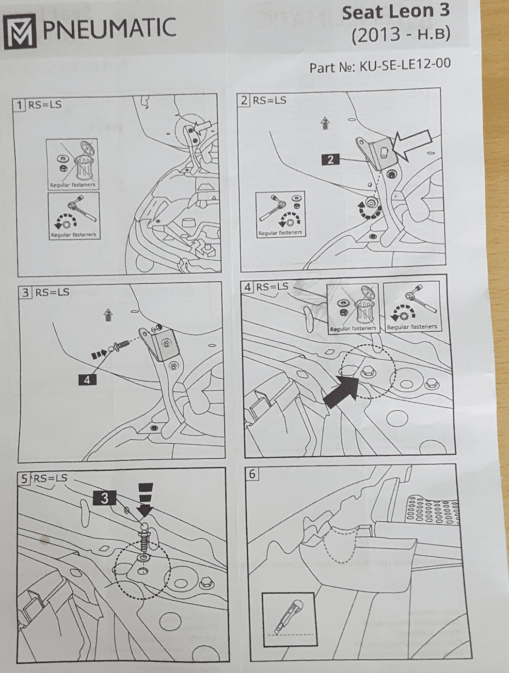

Guy's anyone tried fitting them on the Mk3 with the tube on the inner wing and piston uppermost and avoid cutting the insulation?
[Instead of as vid with piston on wing tube to Bonnet as on my Astra, [may be a clearance issue]
and some pictures of on the Mk 2 I saw.
Cheers Andy
it comes with instructions (i have scanned then on a thread way back) and i followed it with exception of cutting and had no problems at all
Thanks 'oldboy.
Interesting
Come on
don't leave me wanting more!! lol
What do you mean by 'with exception of cutting'
Cheers Andy
The instructions say you have to cut a bit out of the insulation at the top of the bonnet, I did not and never had any issues.
Here is a bit of the instructions and bottom right is the big I did not do
