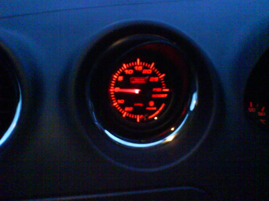

Having owned the car just over a week now, i've decided to replace the cr*ppy unconnected boost gauge that came with the car. So here we go :
Before :
After :
Now two things :

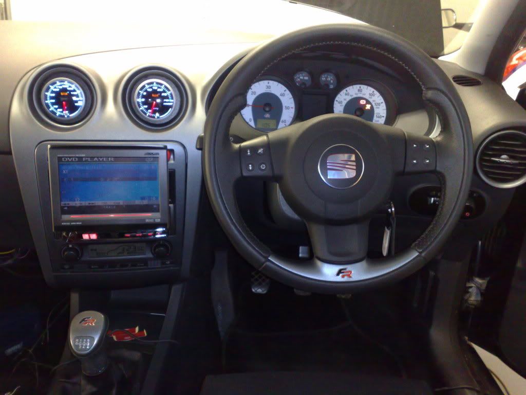

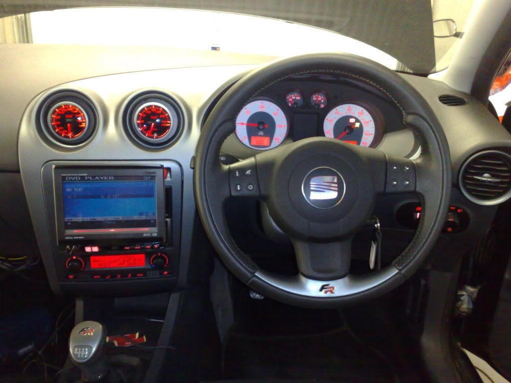

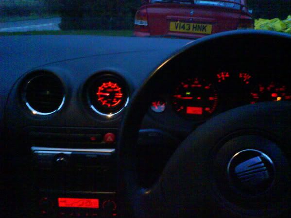

1) Placement - As its currently in the air vent, im unsure if it looks right there. Do I either buy a nomad pillar pod and add ann AFR gauge, or make up a custom fibreglass vent pod?

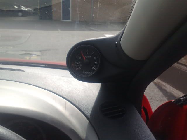

Heres a blurry picture of mine:
Custom pillar pod I done myself anf then got it covered in leather. More pics if needed.
