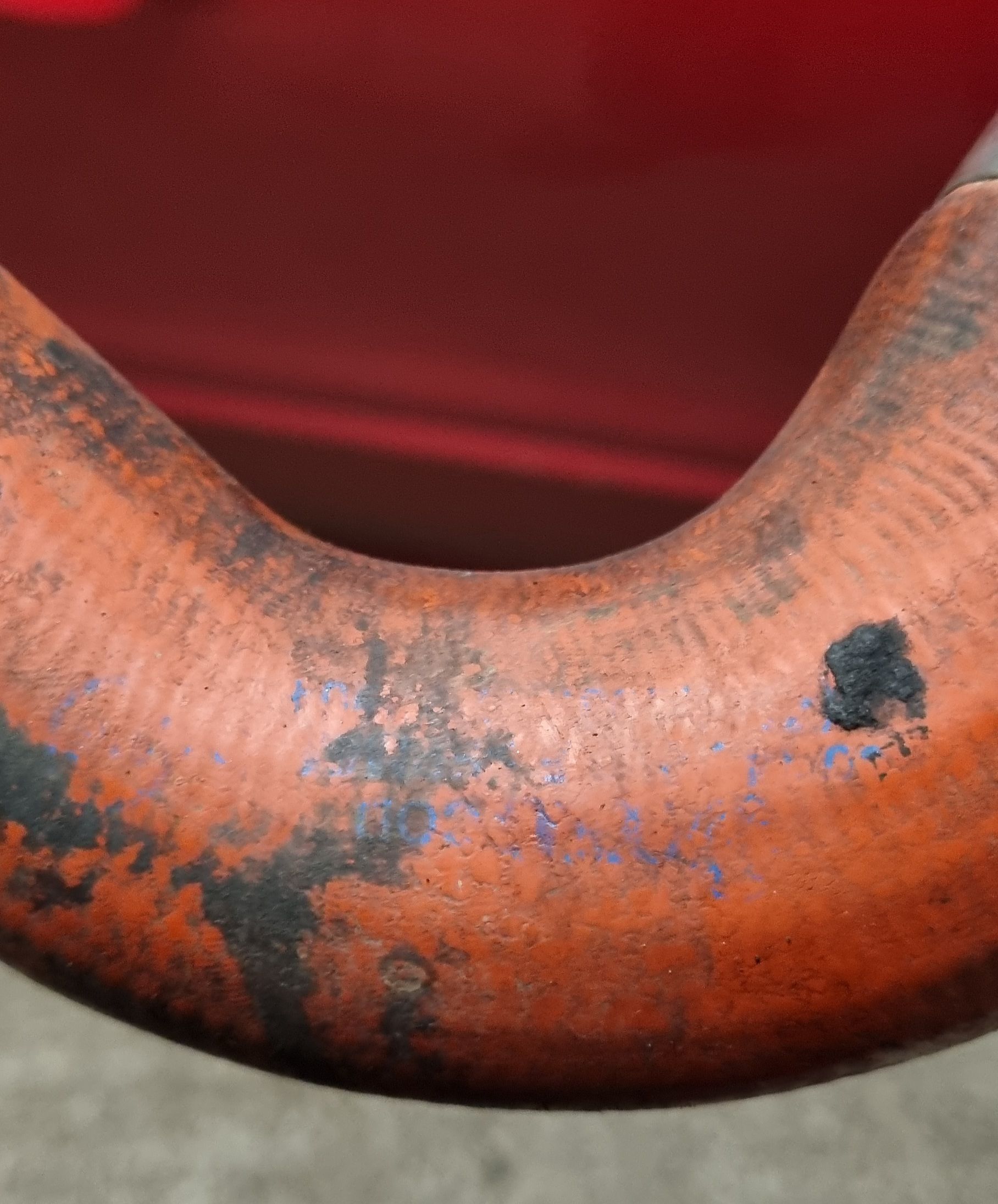

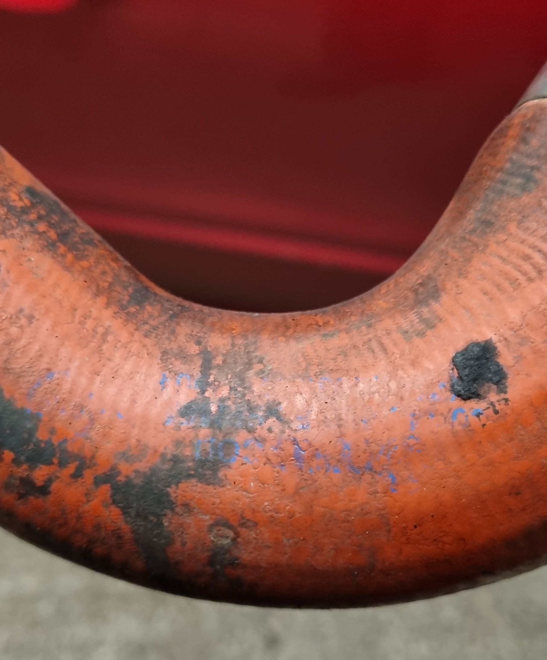

Spent a couple of hours today trying to get the horseshoe clip off the top of the red turbo hose (the one that connects to the turbo) but gave up after a while. I tried to go in above the CV shaft through the offside wheel well, but it's really hard to get the clip popped off because of the lack of access.
My options now seem to be to either take the undertray off and try to reach around so I can do it from the underside, or to take the TIP out so I can get to it from above. Both involve a certain amount of faff. The red pipe does seem to have some play in it at the turbo side. All the other connections are firm and don't move, but in this one I can definitely feel it move when I pull on it.
