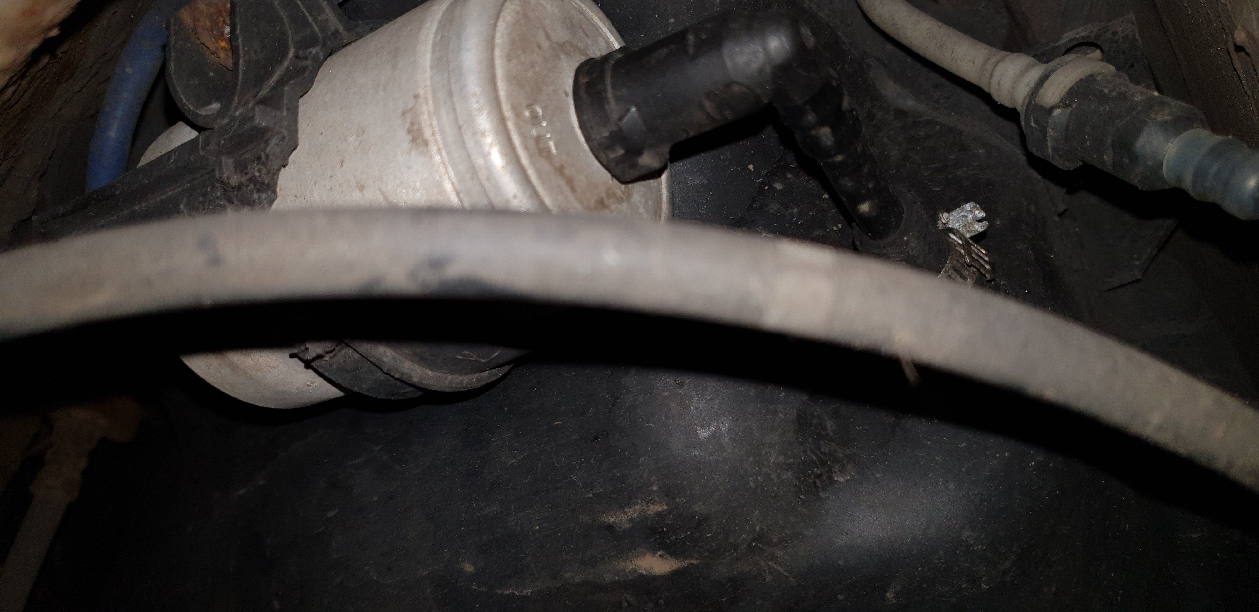

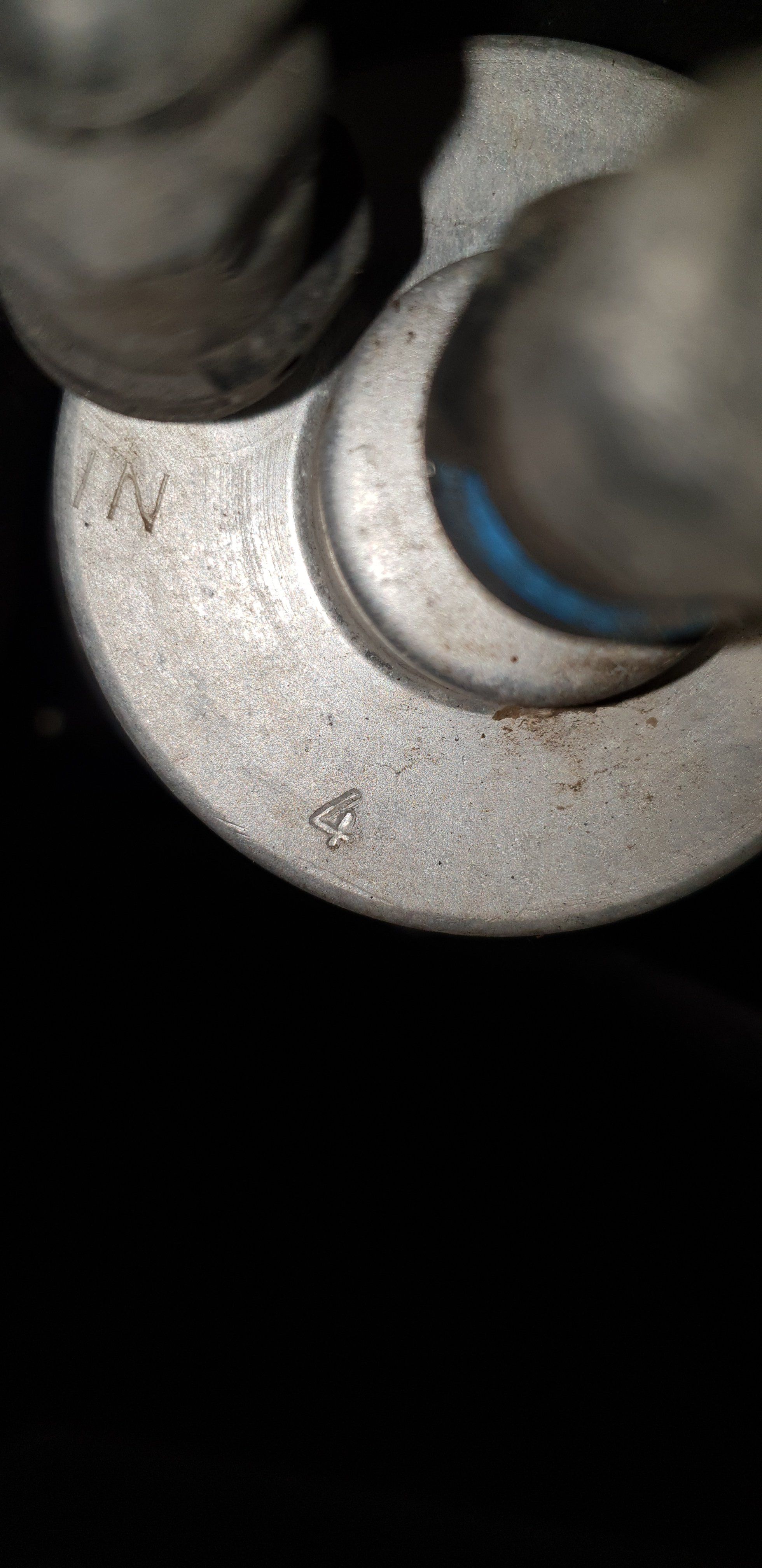

I'm in the same boat as you, same engine code as mine and i need to change the fuel filter. It's definitely a 3 pipe one as i now have a useless 2 pipe one as i didn't check properly (doh!)
Had a look at my filter and took some pics, bad news is that my filter is totally blank so i have a cheapo generic one. The only good news is that it has a number 4 printed on the end so i THINK its a 4bar one. I might be completely wrong. Pics below

Had a look at my filter and took some pics, bad news is that my filter is totally blank so i have a cheapo generic one. The only good news is that it has a number 4 printed on the end so i THINK its a 4bar one. I might be completely wrong. Pics belowView attachment 3645 View attachment 3646
kanyewest let me know if you figure this out. Hope this helps
yeah i actually found out earlier this afternoon
the OEM part number is: 6Q0 201 051 B
