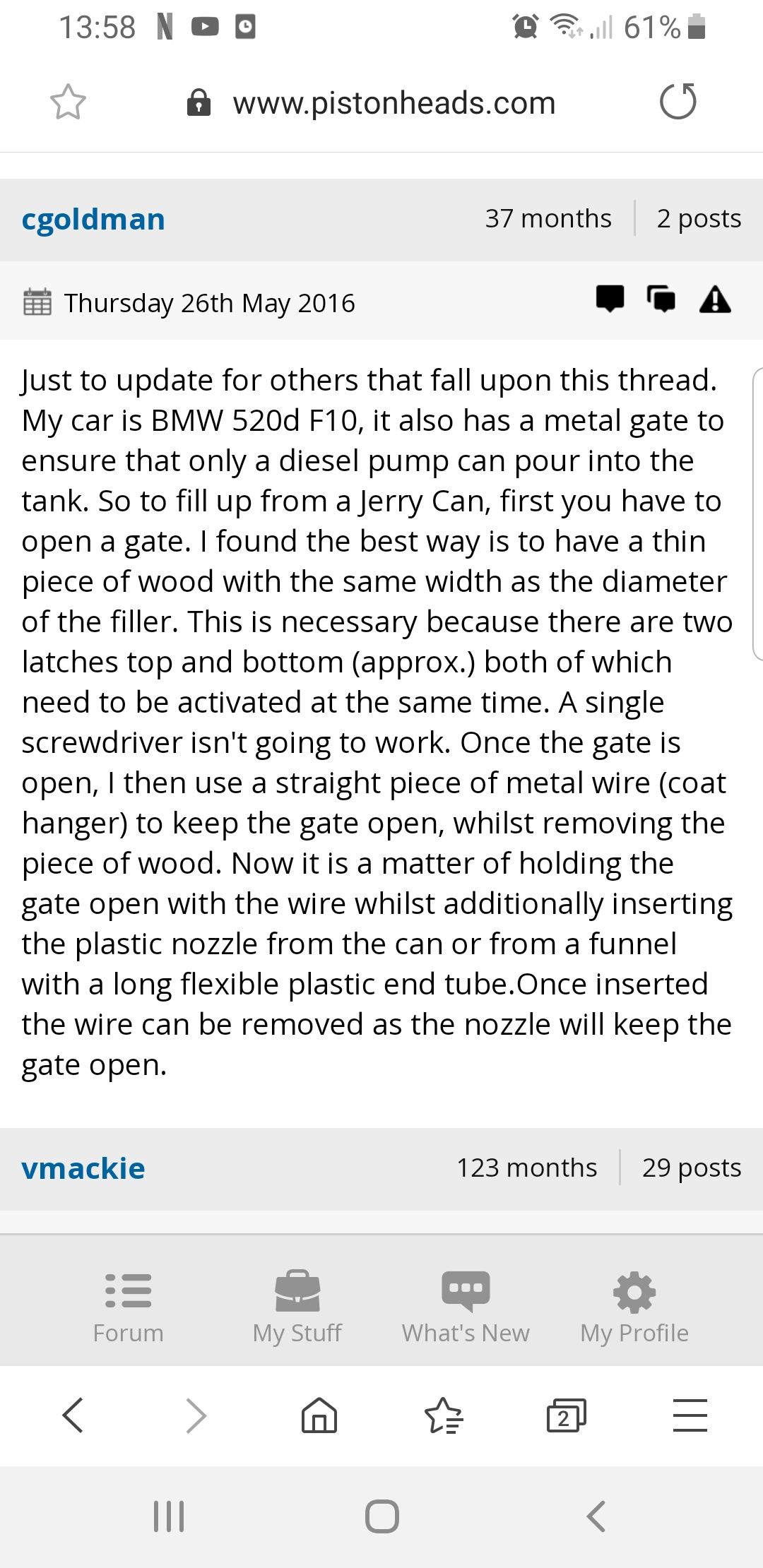

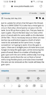

Found this on pistonheads, might help

It looks like I'll need a tube or funnel that has a 25mm diameter which is the same as a UK diesel nozzle.
