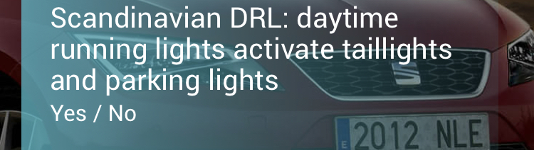

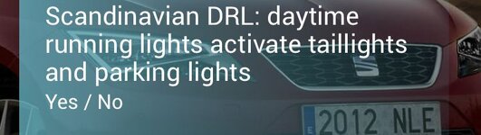

You can set the tail lights to be "Daytime Running Lights" as well by turning on the "Scandinavian Lights" option. Or atleast that was what it was called when I did mine.
Carista has a month free if you buy their adapter, otherwise you have to pay a subscription but you can get most of your mods done in a month. If they bring out anything else you want, just use someone elses phone for another month or create another apple ID.

Only downside to Scandinavian DRLs is that it activates all the interior lighting too, so unless you have auto lights you have to check whether or not your headlights are on during the day or not
I
ive not noticed it do that, I have auto headlights. Do you mean it turns all the lights on the dash on? Because I only noticed that it turns the lights on the headlight selector on even when just in auto. Easiest way to tell if your headlights are on during the day is to see if the satnav is in night mode or not.
I
In my pre facelift all the buttons in the dash light up red when Scandinavian DRLs are switched on, not that big of a deal. I don't usually have the nav screen on, usually media or driving data.
