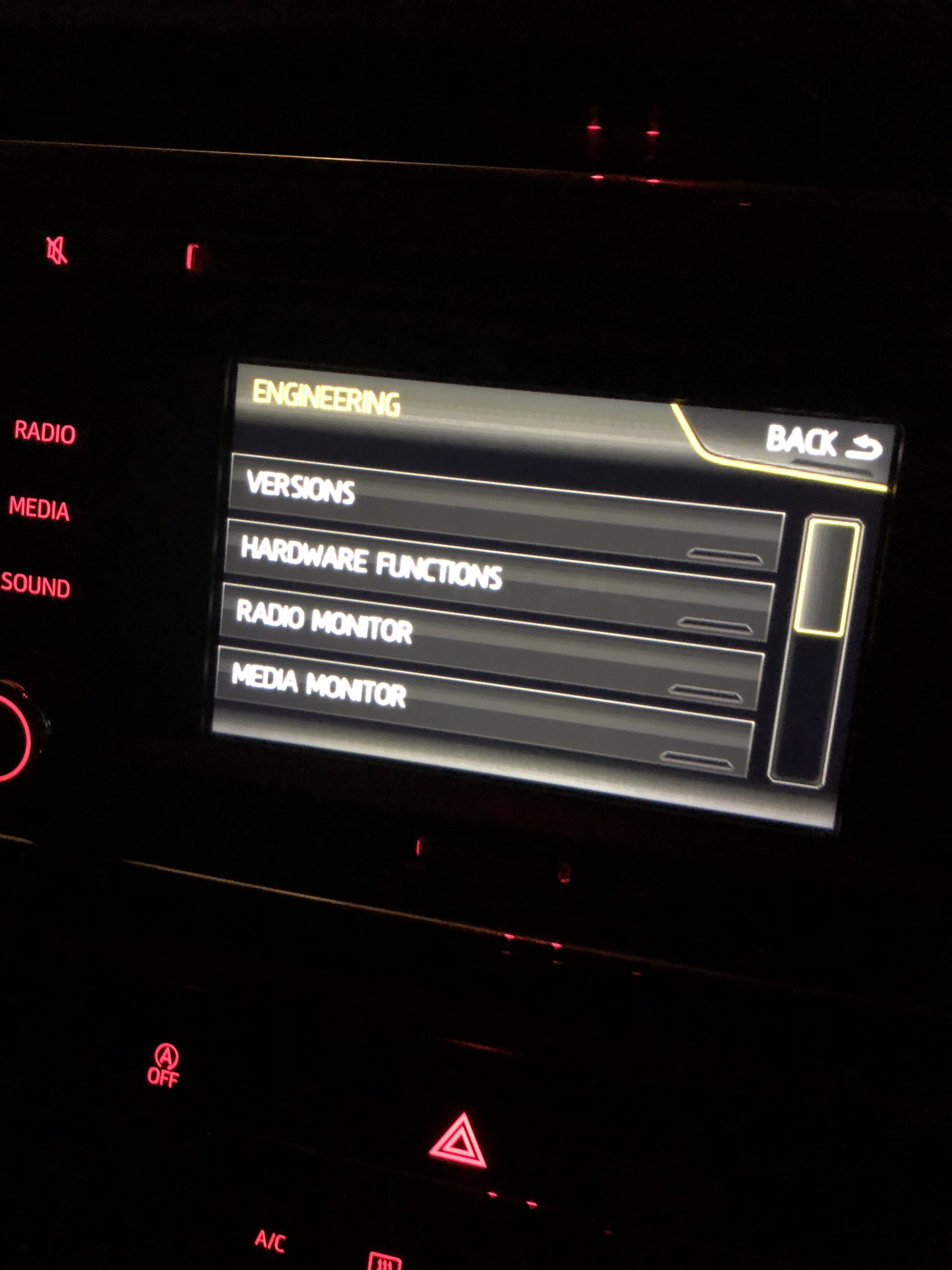

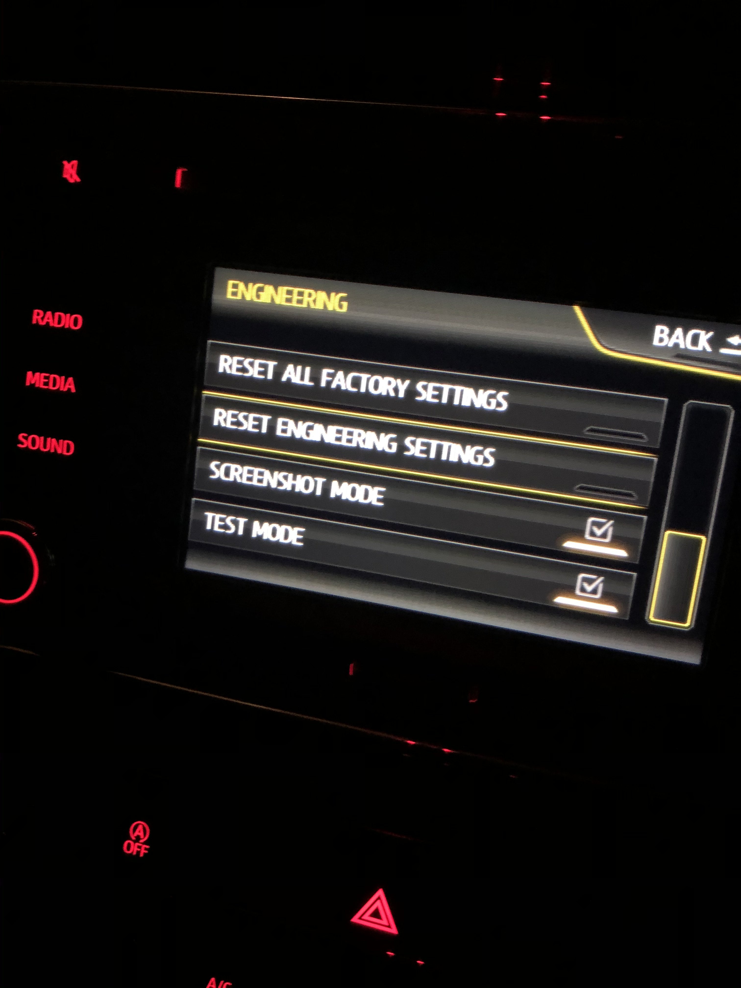

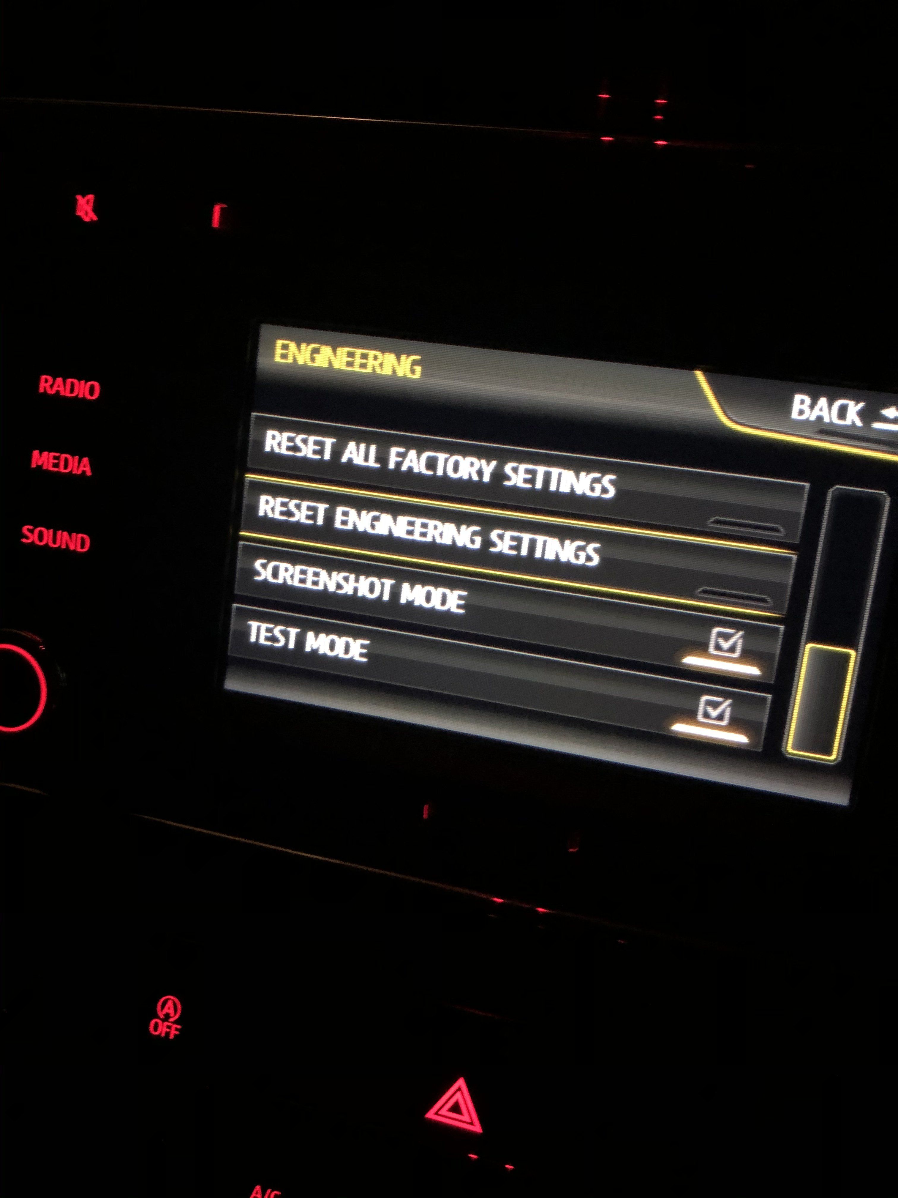

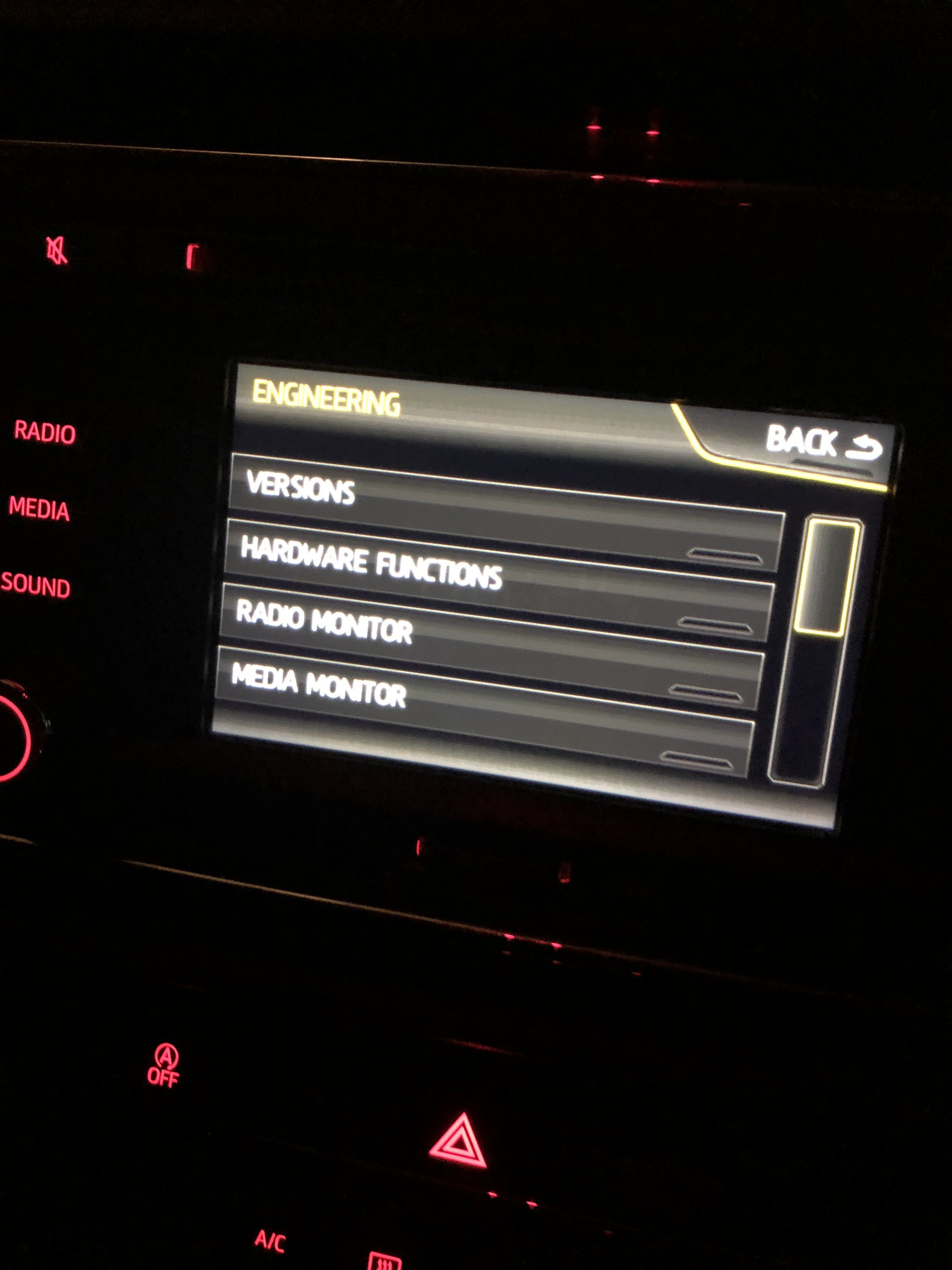

Bit confused about how to enable the carbon background in mfd.. could anyone explain? I've enabled the developer settings but nothing happens when I hold the menu button on my mfd. It only brings up the settings to update the software etc
Wilkesy
May 1, 2018
255
29
You need the dev menu enabled via the app before anything. Then go back to your MIB screen hold the menu button for 10 seconds that will open the dev menu and on that screen advanced to skins and it’s on there from a choice of 3 I believe.
My car is a 2016 plate so might be different on yours.
N77A
Nov 8, 2019
88
Nope, even after enabling it in carista, it doesn’t appear when I hold the menu button.
