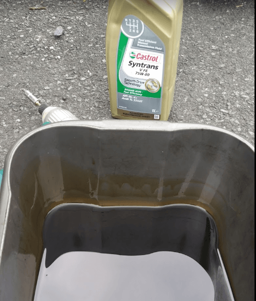

Replaced my gearbox oil at the weekend, car (2014 184TDI) has done just over 90k miles.
Really easy job, went for a drive before to get the oil warm.
Definite improvement in gear change quality/smoothness.

You can see the oil I used in my photo: Castrol Syntrans V FE 75w80.
You can see in the the previous posts for the Fuchs oil alternative and Seat OE numbers.
2.3L required - so 3x 1L bottles.
I found I could just pour the oil in using the small tube with the bottle so didn't need any funnel or tubing.
