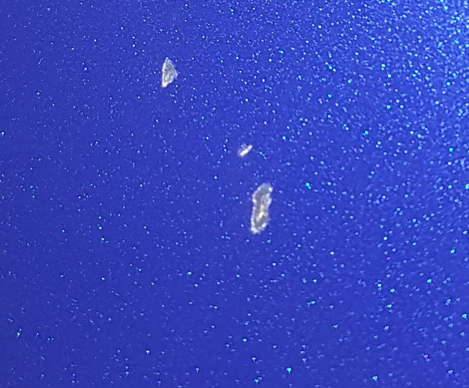

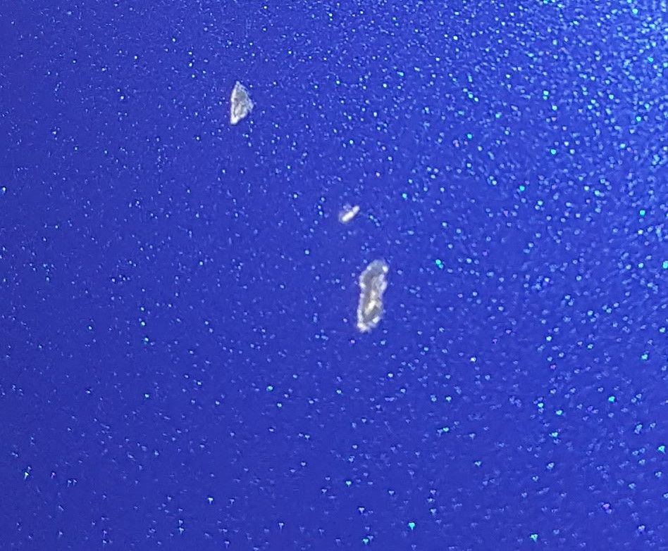

I thought I would never see the day, but I have to shamefully admit I have bought a car bra and it will go in during winter time :p
Will be interested to hear how you get on with it.
Is this the black cover that fits on the front of the bonnet? If so, be aware that if dirt and grit gets between the bonnet bra and the paintwork, it’s likely to cause scratches and swirls.
I suppose it comes down to which is the lesser of two evils; fit the bonnet bra and suffer the likely scratches and swirls or don’t fit it and risk the almost inevitable stone chips from all the grit and crap that spread on the roads in the winter being blasted at your paintwork.

That's a valid point there - maybe if it is removed often and cleaned under it won't go so bad as you describe.
Either way, it is probably easier to polish scratches out than to touch up stone chips, which I am about to do.
In my first 2 weeks of owning the car, I got 2 very large and noticeable chips plus a cracked windshield, which is what prompted me to get this bra.
I never liked the looks of these things, but I also like my paint...

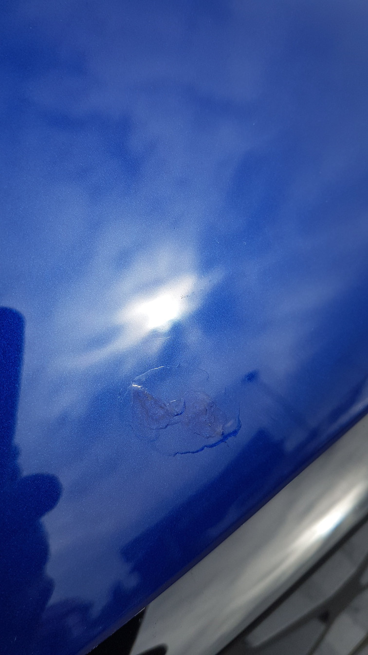

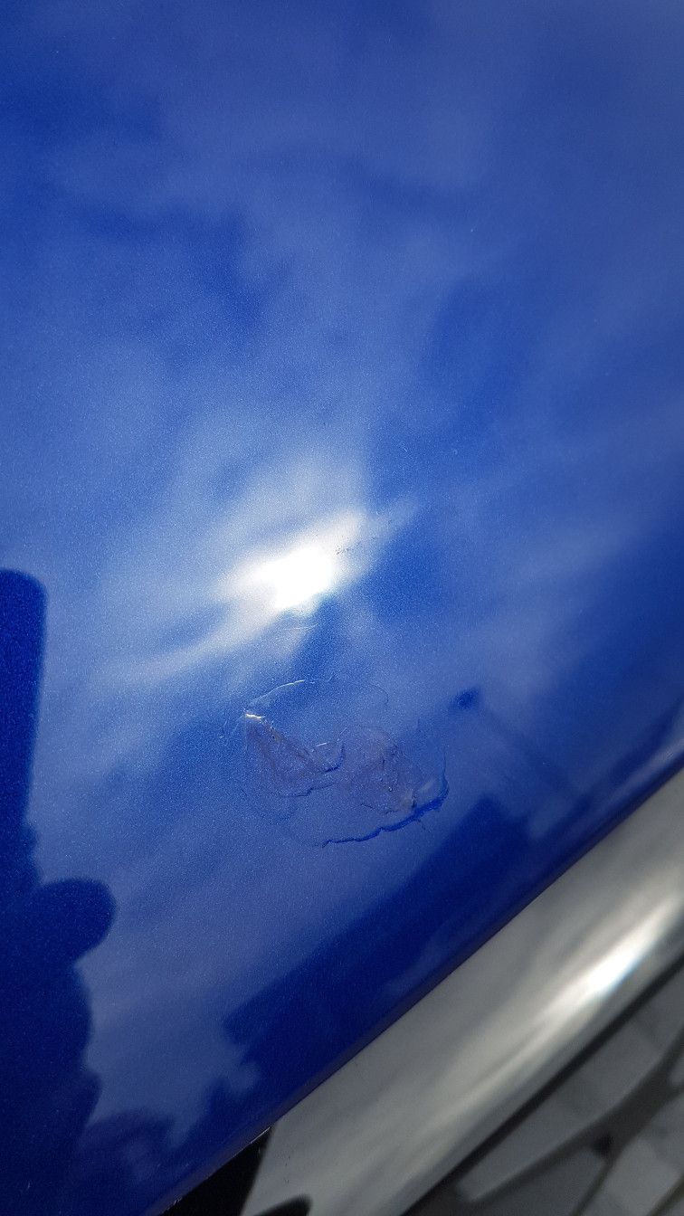

got this surprise this weekend :(
car is 2 weeks old
ordered some touchup paint from seat, I'll try to cover it

Best advice is don't use the massive brush that comes with for example the Seat touch up, buy small model brush. Makes a better job!

The problem with the manufacturer’s touch up paint is the brush is much too big in my opinion to apply paint just to fill the stone chip in the majority of cases. The paint also dries very quickly so once it’s on, it can be quite difficult to rectify a stone chip repair you’re not happy with. When I’ve used manufacturer’s touch up paint, I’ve applied it either a cocktail stick or the end of an unfolded paper clip, so it’s much easier to control the amount of paint you apply, and you can do it more precisely than with the brush inside the cap of the Seat paint.
I prefer the Chipex kit to the manufacturer’s touch up paint. The benefit of the Chipex kit is that if you’re not satisfied with your first attempt, you can remove the paint with the blending solution that’s supplied as part of the kit, and start again until you happy with the results, so no need to go to a body shop. You need to take your time and you probably won’t be happy with your first few attempts, but with practice you can get pretty good results.

yeah, that's exactly what happened, put to much, I couldn't remove it, tried to cover it than got bigger and bigger.
it was only 20 quid to polish it off ,so not so bad. Not sure if i want to try again ..

@silles glad you got it off, as I said on Wednesday get a small brush, and few light coats are better than one.
Not sure how this blender works as I've never used chipex.
I don't ever use the laquer with the manufacturer kits either, maybe I should. But that is even harder to apply IMO.
I have some touch up that's for my other car which is oil based, it's so good.
This new paint for my white Leon is like tipex and soon comes off with the pressure washer so re apply quite often.
