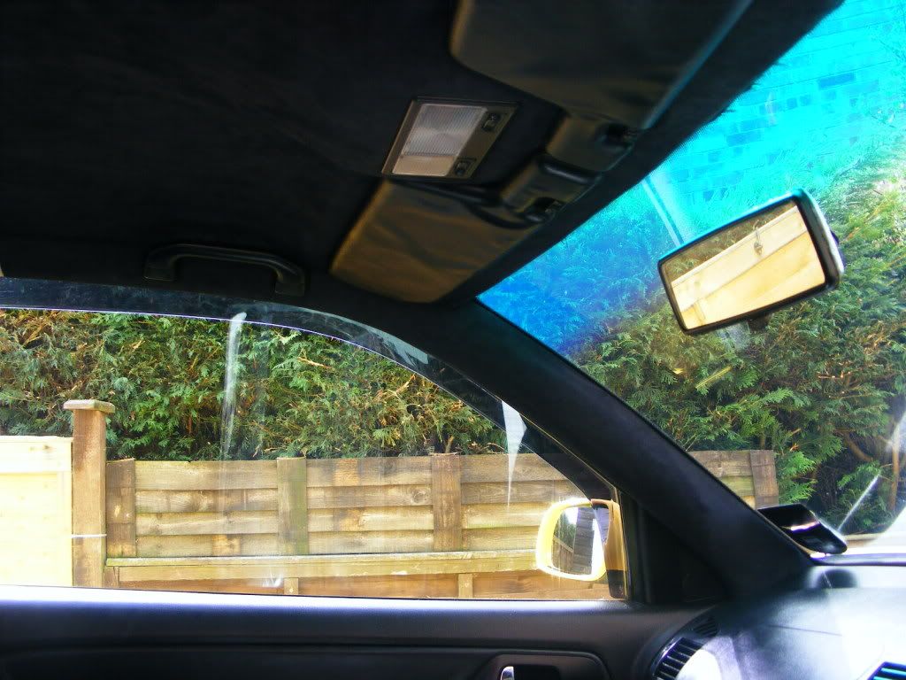

well the day off work so i have managed to do the pillar posts well one side anyways the pass side went abit wrong , but now looks like a cupra again did not like it with the yellow posts
and with the headlining been done in suede for so long started retrimming the plastics plus painted the sunvisors , grab handles and finally fitted my carbon interior mirror
