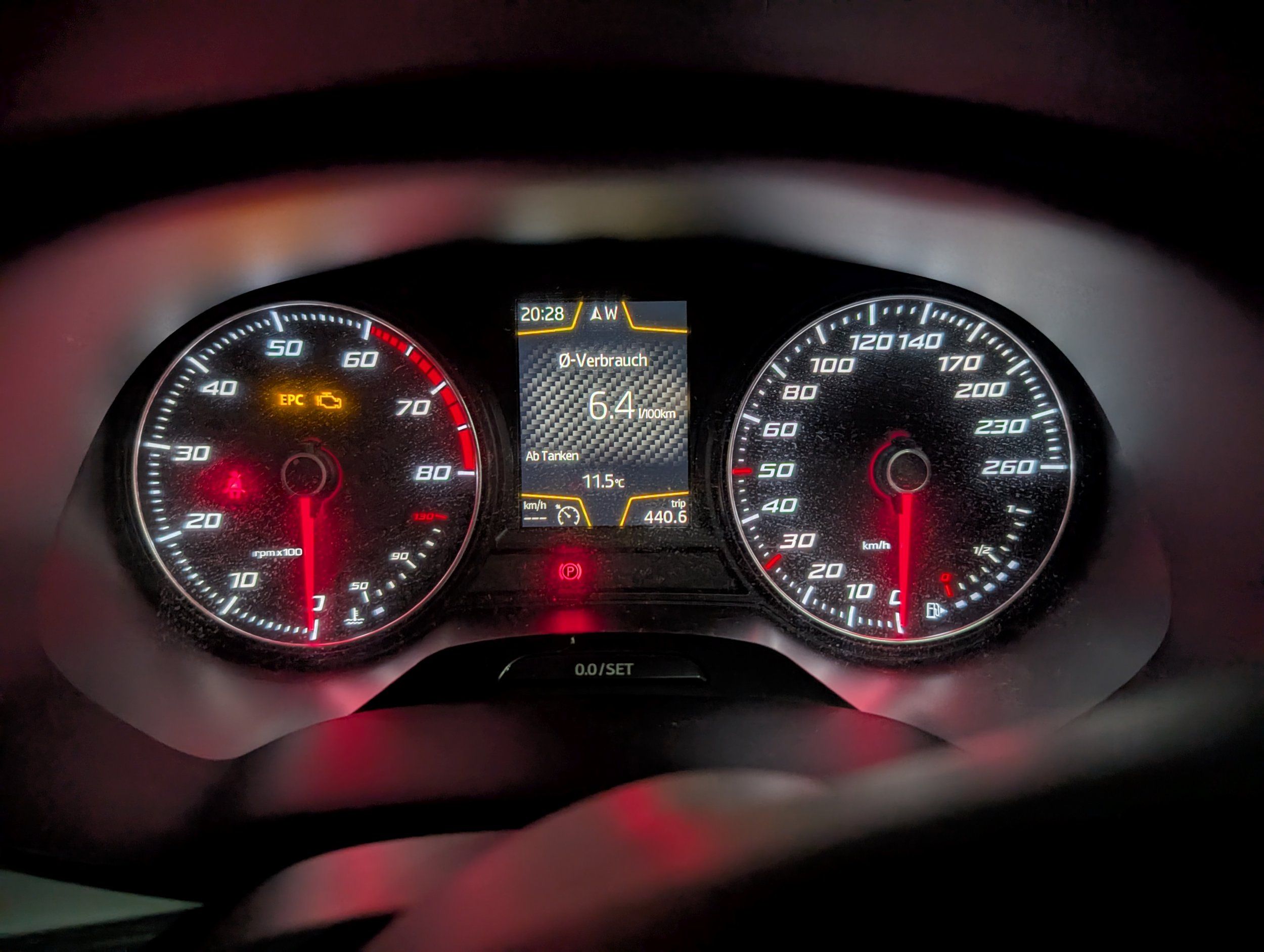

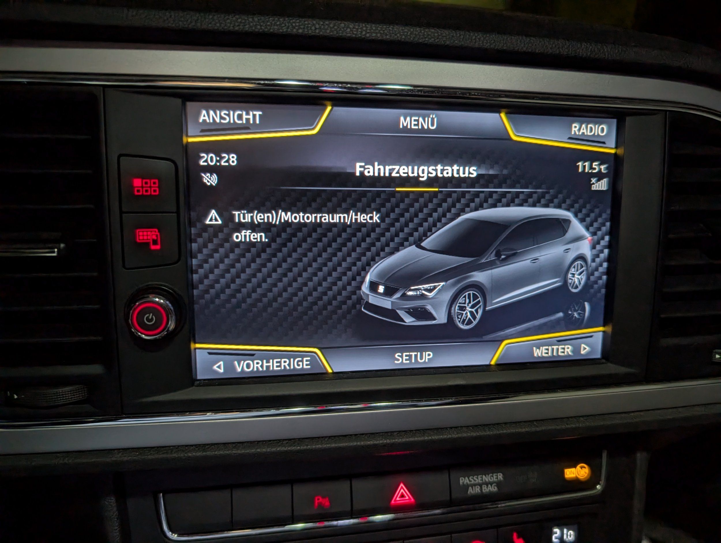

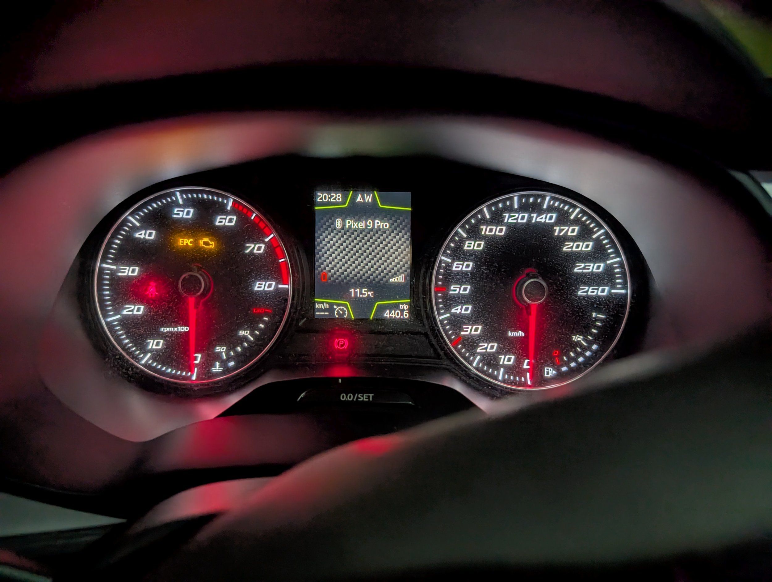

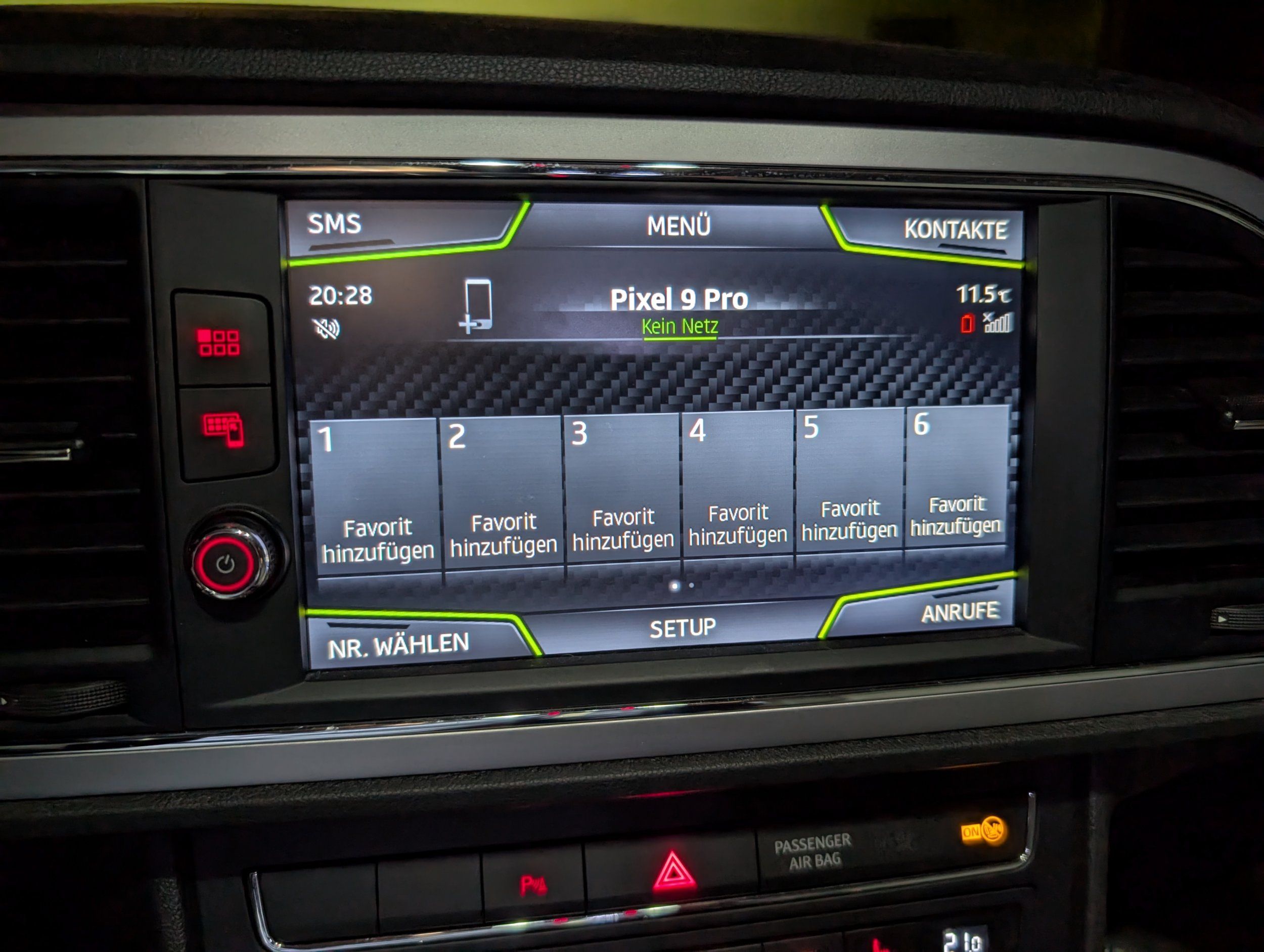

good evening. you mean this behavior of the colors, right?

Yes, wondering why two cars have different colours for the same screen. See photos in top post, both set to driving data, one has red, one yellow

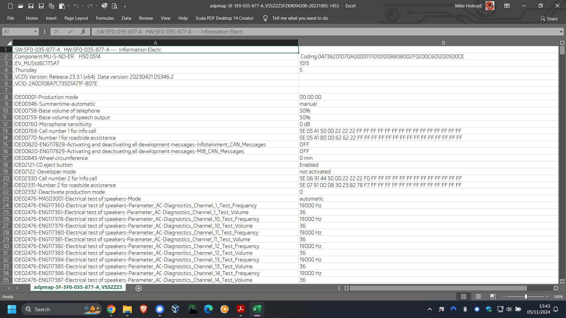

I have had a look at my current car which is a 2019 FL SE Dynamic. I've attached 17, 19, 09 and 5F from scan. Every screen has red lines on the menu, whether it is driving data, navigation, audio etc.

  • New Text Document.txt
Good morning. Send me an auto scan please. Actually you only have newer versions and a diesel speedometer.
It's much simpler than you think :) Color of the lines on the maxidot changes with selected ambient color, that's all. MIB2 units from 2015 to 2018 have version between 2xx and 4xx (I've got 480 version in my 2017 Leon) and have predefined colors on maxidot. H50 (I belive it's only Technisat Preh) and H55 (Harman) units with 5xx version were installed from 2018, have 5xx version and changes colors on maxidot depending on selected ambient color.

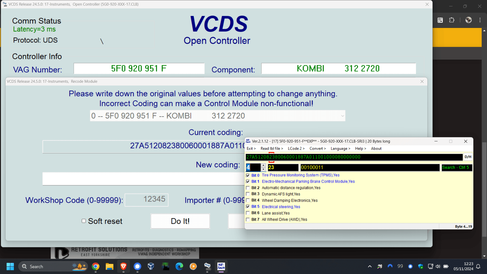

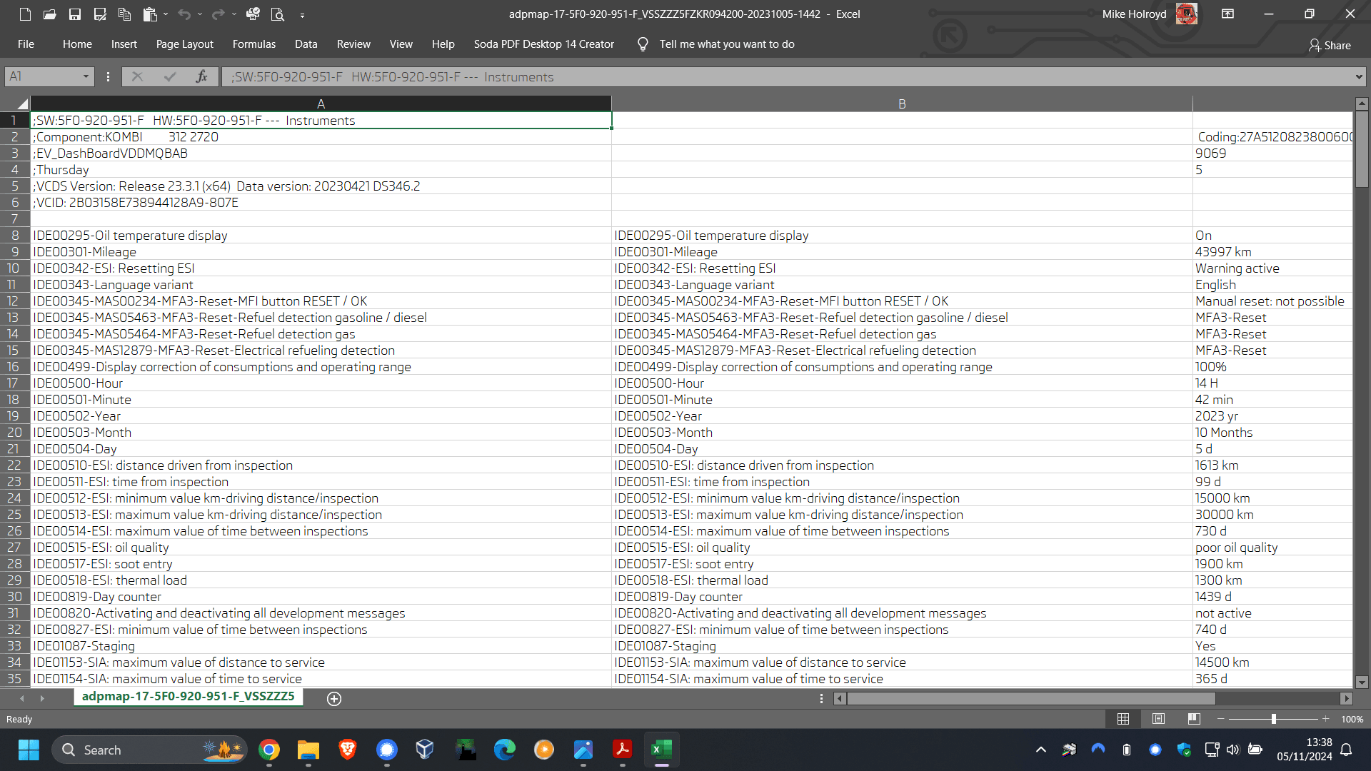

Hi, maxidot version is 5F0 920 951 F, version KOMBI 312 2720, and the car is a MY2019
So I have HW03 and SW0480 in my vehicle with 5F and VC and it changes the color according to the ambience. My wife has a 5F Leon with MJ18 and the desired function works there. Is it really the SW version or the HW version of the 5f?
Yea, this is a screenshot taken when VCDS is plugged in, and a full adaptation map done
