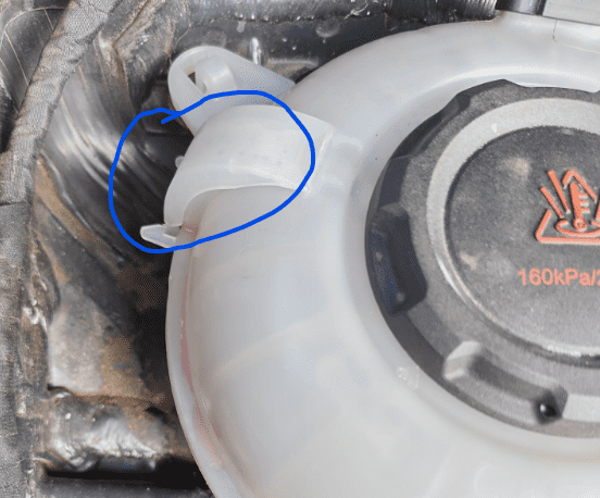

My cap was weak when I tested it, when I was fault finding ultimayle having matrix issues - it leaked at around 10-12psi from memory vs the rated 24psi.
This blue circle is the overflow - If the system over pressurises and the cap vents, any coolant should vent out this spout. I would see a puddle of coolant on the metal work below this spout.
This was exactly why I thought of the coolant cap :cheers:

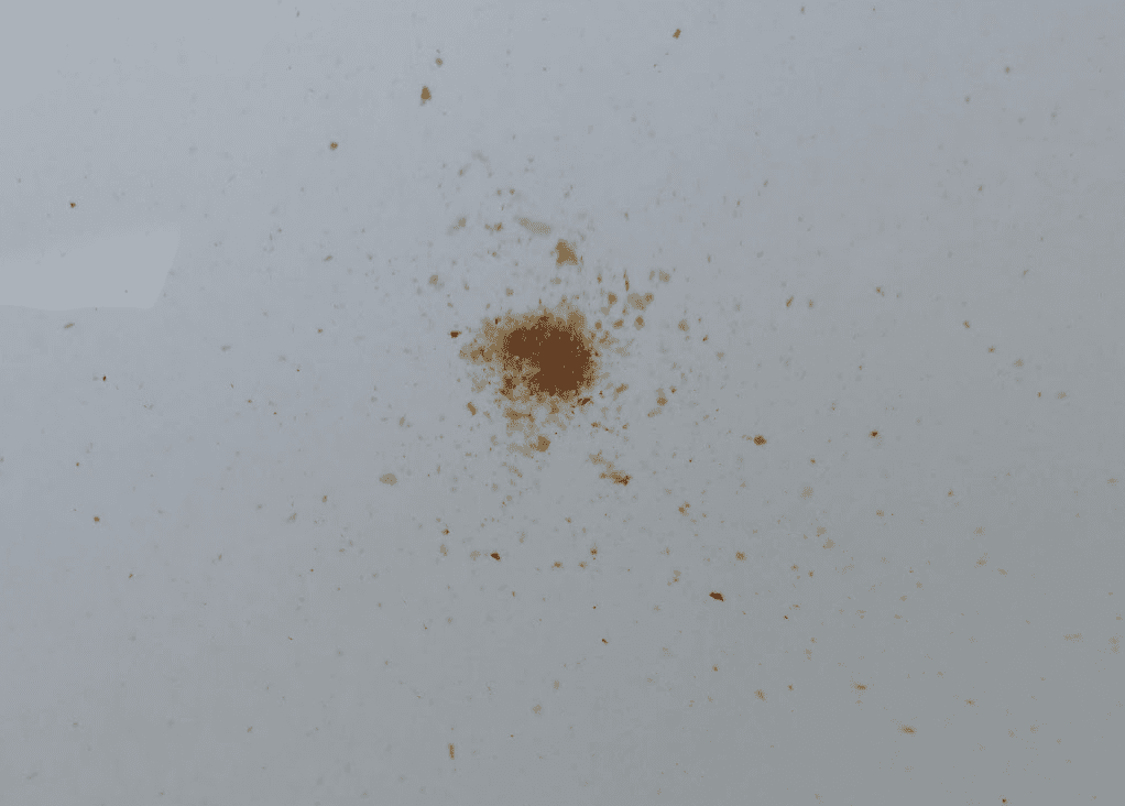

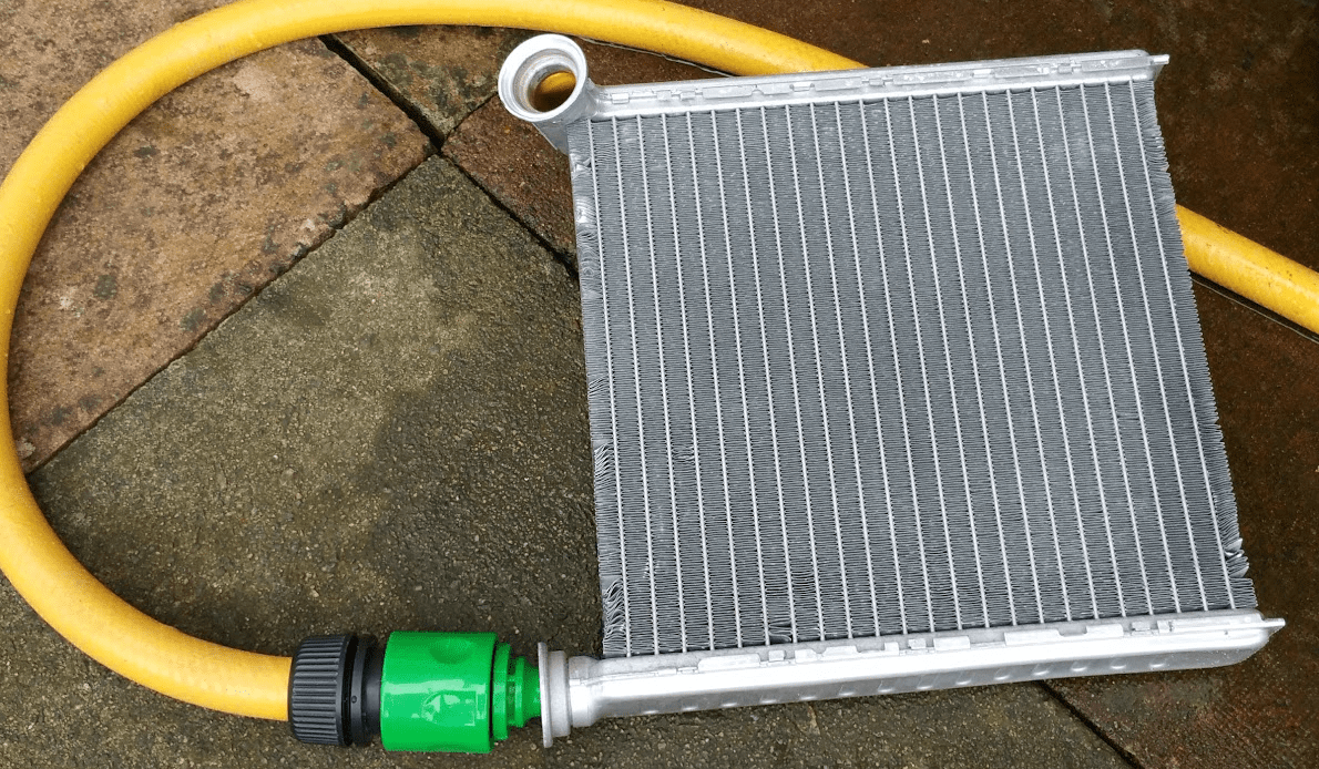

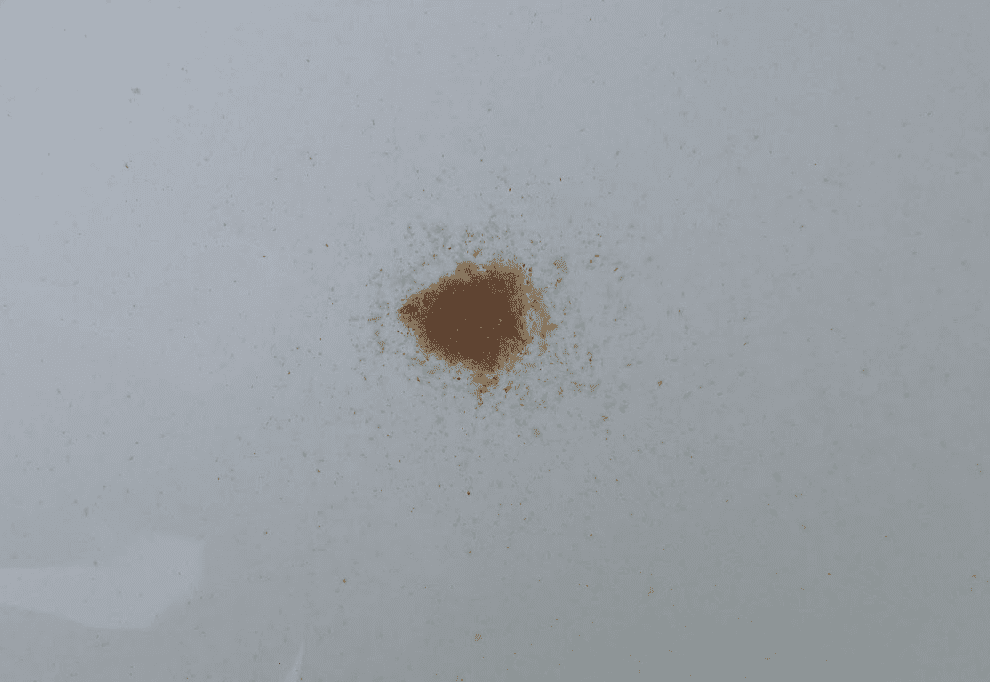

I flushed my matrix out something like 4 or 5 times.
I found my hose pipe adapter + oring fit nicely so I could flush it through with nice high pressure water, and I also vibrated it with a multi tool.
I lot of the 'detritus' I flushed out looked like very fine flakes - I think these over time build up and coat the inner surface of the heat exchanger, so restrict the heat transfer capability - as well as restricting flow.
I hoped that each flush would last longer before needing to do it again (every 6 months) to eventually 'clear out the system!' but it never did, was only ever temporary!
A new heater matrix fixed it and it has been great since (4 years ago)
Easy to DIY the matrix - it slides out from the side of the dash.
