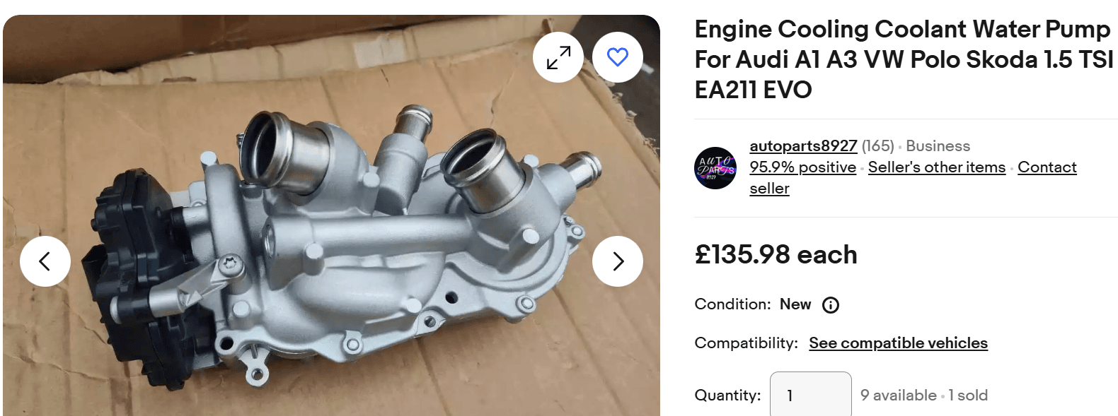

Could be the thermostat misbehaving/sticking. Not sure if you have the electronic switchable water pump on your car. They can play up as well.
Have you put your reg in here: https://www.autodoc.co.uk/
You must be able to find an OEM part number and find what you need somewhere.

Hi
Thanks for the reply, i put my number plate in the website you provided but still it says there are 0 results for thermostats for my car. I guess ill have to find the OEM part number. I just find it weird that no results come up for a thermostat for my vehicle and wondering if my vehicle even has one lol.

ebay or amazon have ‘check compatibility with your car’ functions where the results are supposed to fit?

Unfortunately I've found the ebay compatibility checker very, very inaccurate. Far safer in these cases to go to the dealer - at least if the wrong one is supplied there is a comeback
