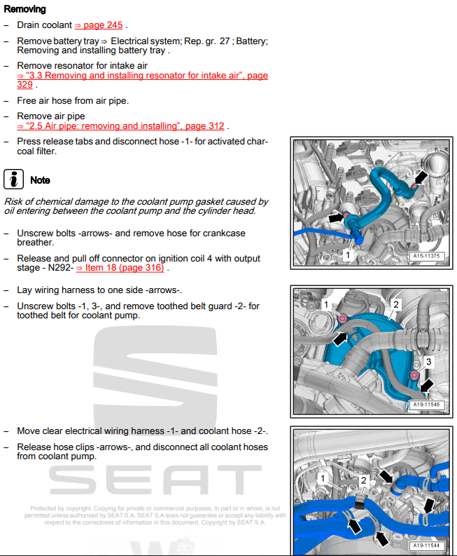

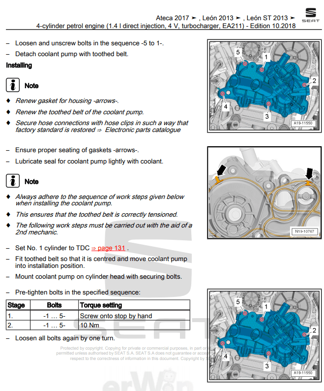

On some models isn’t the water pump on the other end of the engine and not driven by the timing belt but a belt purely for the water pump? Or am I confusing car forums.
Spoke to a couple of non Seat workshops re timing belt change, seems non oe timing tools are not up to the purpose and so these guys don’t want the job.
These are what are in the seat manuals i have for the 1.4 model. not sure if they are of help to you
Reactions: Mr Pig
