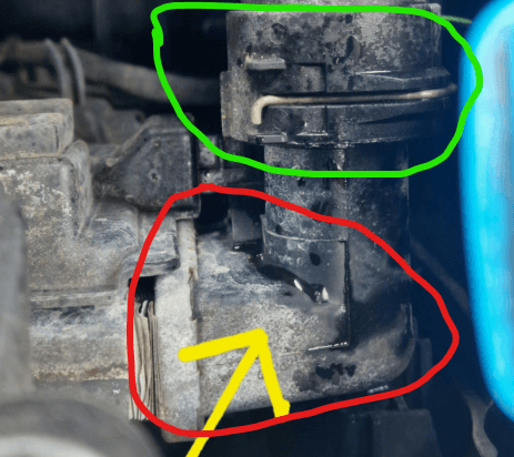

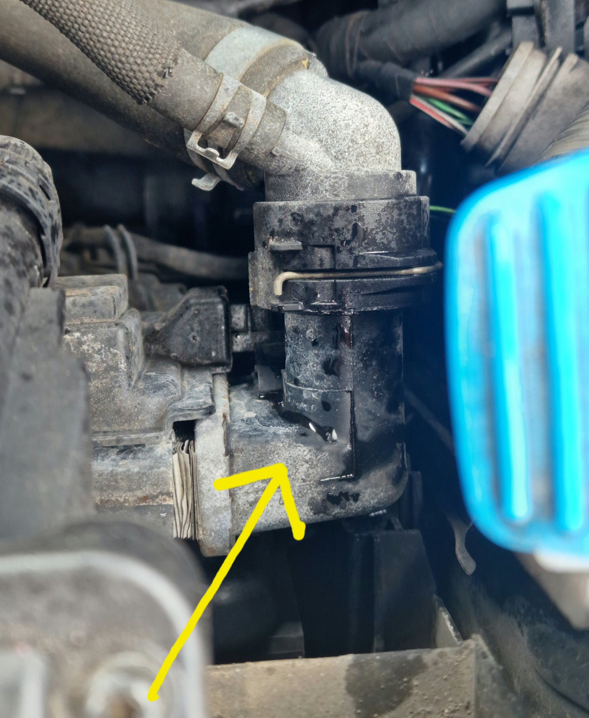

I have noticed a crack in this location... anyone know what part this is or will the entire radiator need replacing?
It it a crack on the part or is the leak coming from the quickfit connector above it ?
You said your coolant levels were fine. Is that still the case ?
Leak is coming from the plastic pipe. The hose is on correctly. There is a visible leak from the plastic pipe. Coolant needs topping up daily. Looks like a new radiator?!
If the plastic 90 degree bend (red) is leaking/cracked then this is part of the radiator so yes it's a new radiator.
If the plastic connector (green) is leaking then it's a new o-ring seal.
