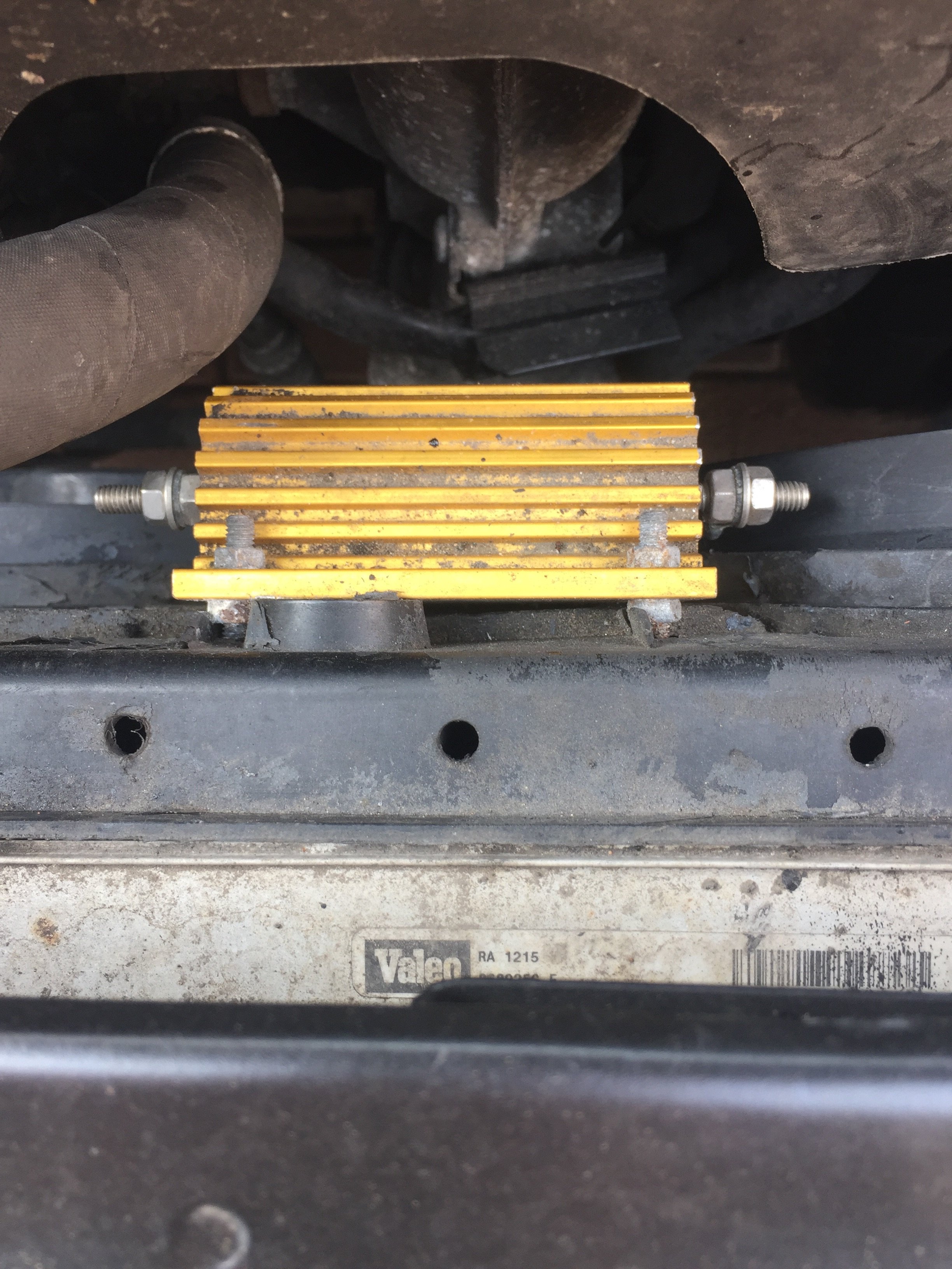

Is this all I need for both fans? I’m still confused having read loads about this problem?
I used two of these units (or similar) and both times it only temporarily fixed it until the unit got water ingress into them and we are talking weeks, I eventually went to Farnell and got two large high power resistors and put them in the circuit instead and 3 years later no issues. The power resistors were like £13 each from memory. I am not usually a fan of big fat capacitors or resistors but in this case it’s the most effective solution imho.
andymc
Mar 20, 2017
13
Thought I would add after looking up what I have, they are 'hsc200 1r0' so thats 1 Ohm resistors rated at 200W and RS Components want £30 per resistor currently.
However using the rs components resistor selector I found 'hs200 1 Ohm' at £19.09 each.
200Watt is overkill for each but for me the biggest downfall in the original resistors was the heatsink setup inside the motor casing and the larger resistor footprint gives some bulk to dissipate heat especially as I've mounted on plastic rather than the chassis or front panel and a decent balance on price as my pennies are better spent on faster parts instead of clever unreliable ways of fixing an old problem.
