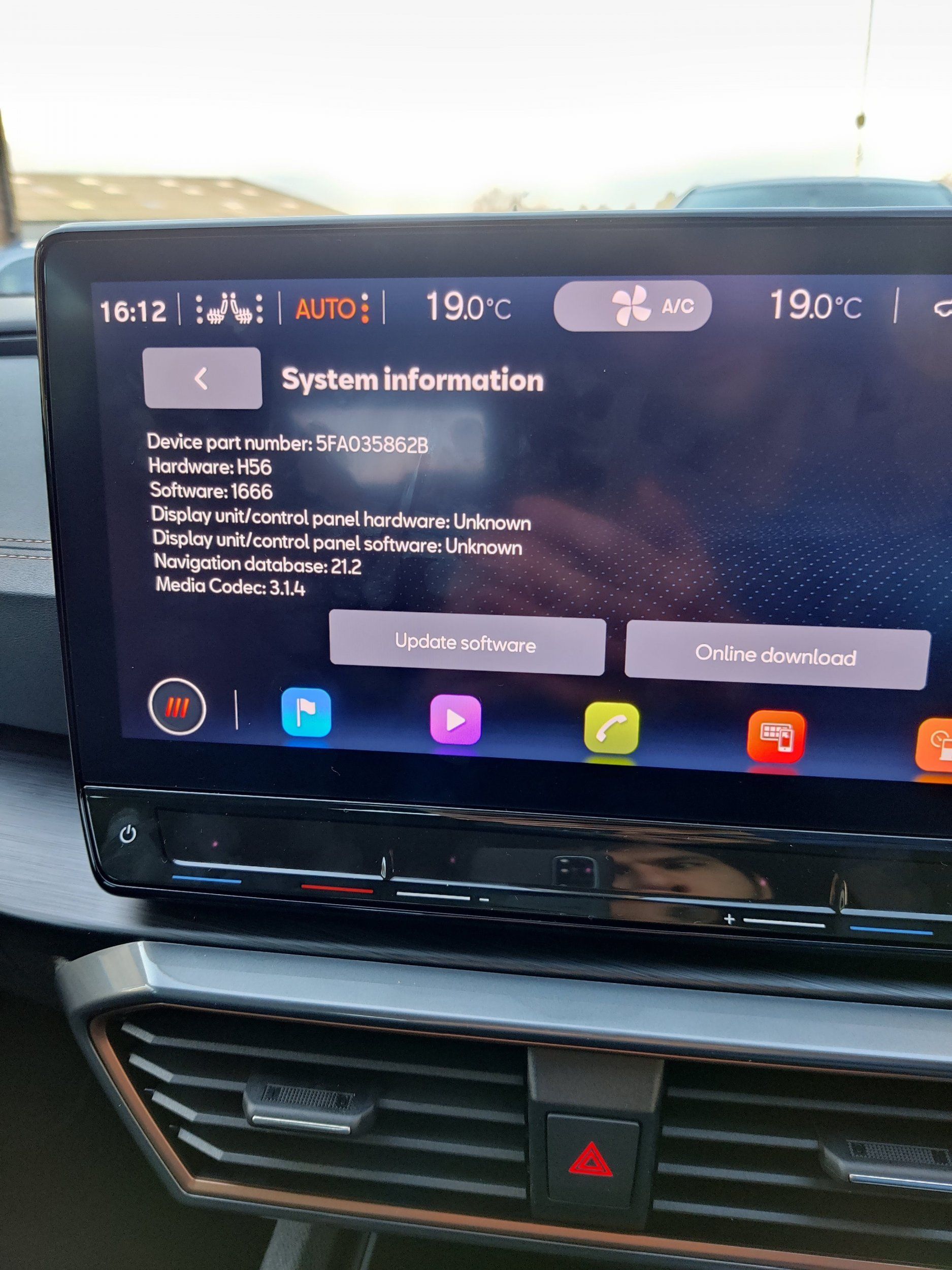

Mine was a bit perculiar when I picked it up. Said there was a software update as soon as I logged in, I accepted it, then it just sat at update in progress for yonks. Left it and went about my day, and when I went back to the car it said system update failed to download, and that notification appeared every time I turned on the car. A reset got rid of it, but now it's not suggesting any more updates and the navigation database version definitely looks a bit old compared to the screenshots on here ?

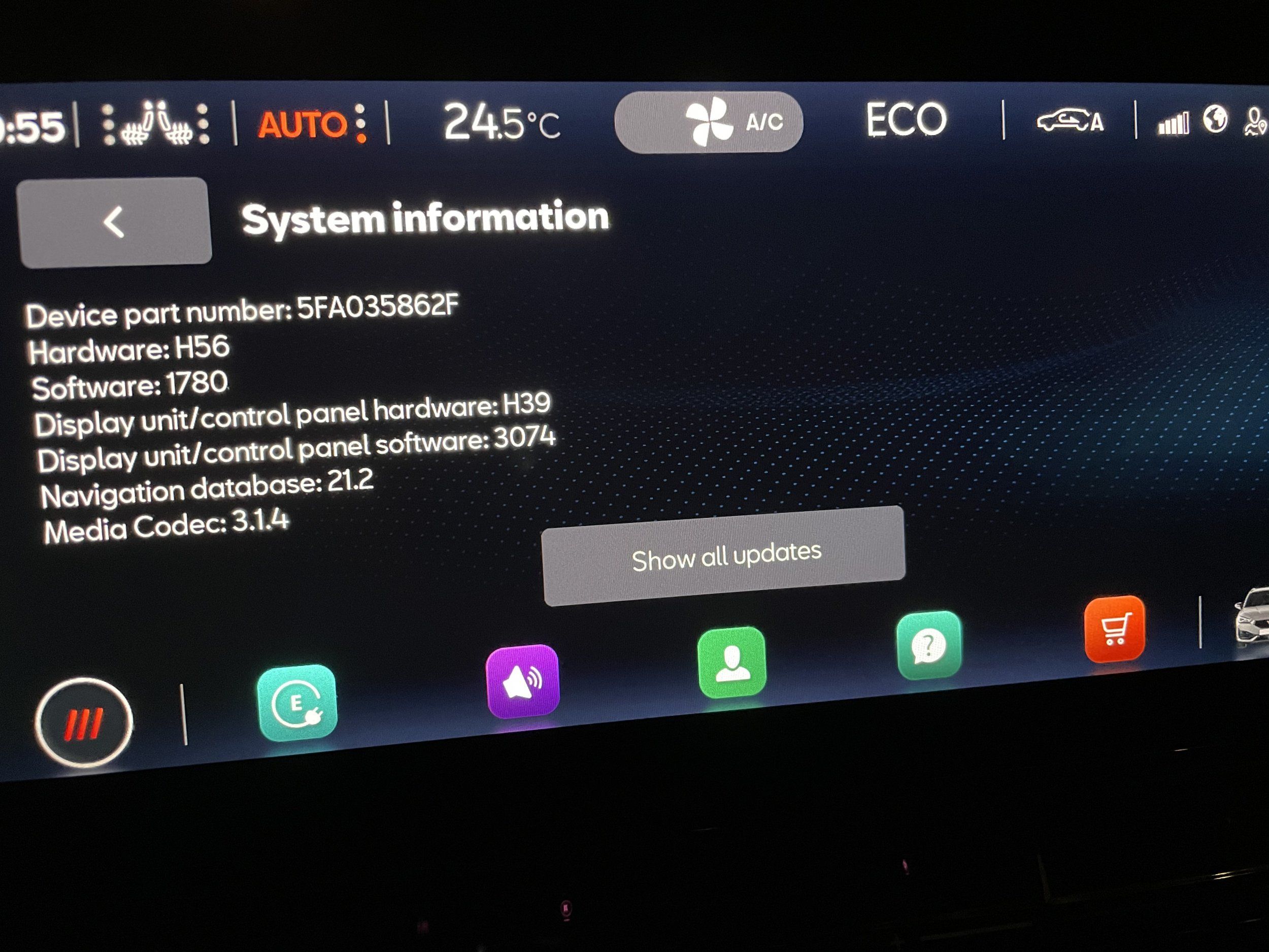

Which hardware part number do you have? Older units have rev A and they suffer from some issues. I read there's dealer update to fix it.
Jan8p
Mar 24, 2021
30
7
Mine is the same as Maypack's on page 1.
Where did you see about a dealer fix? Not good if they've intentionally updated the hardware version because the early revisions had issues, but they're leaving those with the early cars out in the cold because they were un(lucky) enough to buy their cars first!

OK, something seems to have happened today. The navigation database has updated itself to 21.2, but now it shows unknown on display unit hardware/software?
How very odd, it showed H42/6065 before!
