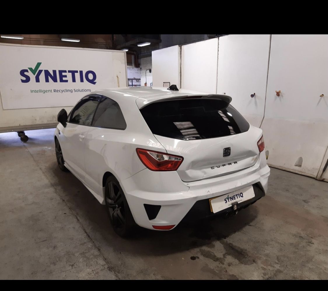

Hi my fellow Seat’ers, so I just bought this Seat cupra, and have realised after paying it don’t start or drive.
My question is any ideas on why it don’t start, when the only damage i can see is too the rear.
Any input is appreciated thanks.
