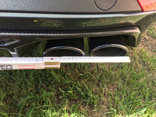

That’s only the pre facelift Golf R estate. The facelift Golf R estate has 4 working pipes. This is what what the Carbon and ST R have. Although the ST R has the GPF/PPF version with no resonator.
@Damo H if i replace the standard rear difuser of my Cupra ST with the oe carbon fiber, would fit the exaust from golf r estate 7.5? I mean is the same for carbon ed and CR ST?
Yes you can, but at a high price.. Alternatively you could modify your current diffuser. It can be cut and heat moulded to accommodate the double tipped back box.
Reactions: Titchy
Like so...
As others have said yes, but it’s not cheap. But as you’ve bought the carbon fibre spoiler I suspect you know that already lol
Yep, arround £700:headhurt:for the CF diffuser.

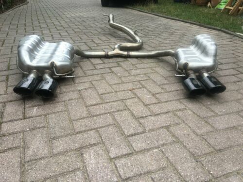

This is the cupra r st

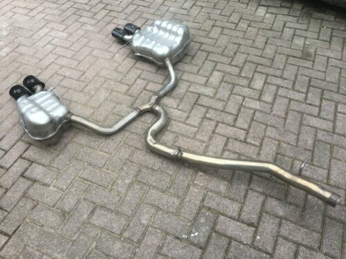

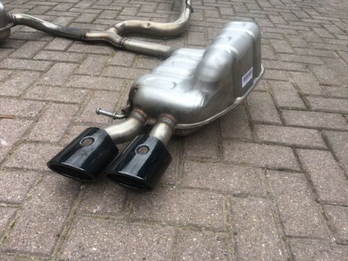

Well there is a golf r estate close to me that apprently has the black pack. Went to have a look today however looks like the pipes may have been sprayed. Would help if your could provide me with an example as a google search doesn’t bring much up. However heres some pics....
Part number which is the same for both and the cupra r st
Black pipes
Standard pipes

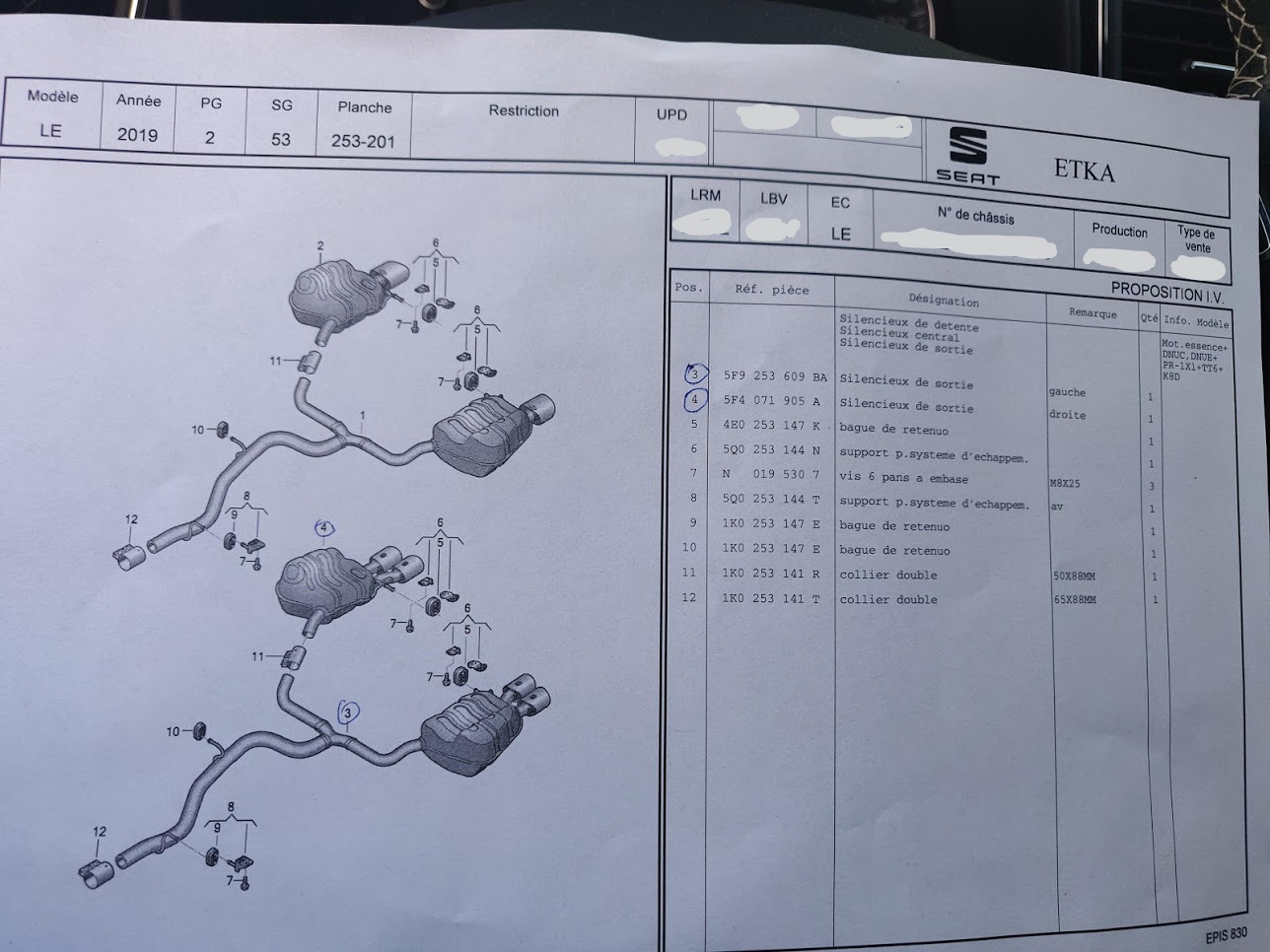

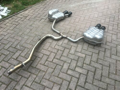

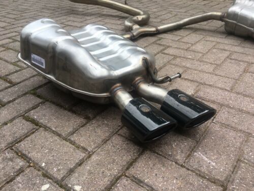

Finally I've got the OE codes and some real pictures for the Cupra ST R/Carbon ed exhaust.
5F9253609 BA left side
5F4071905 A right side
