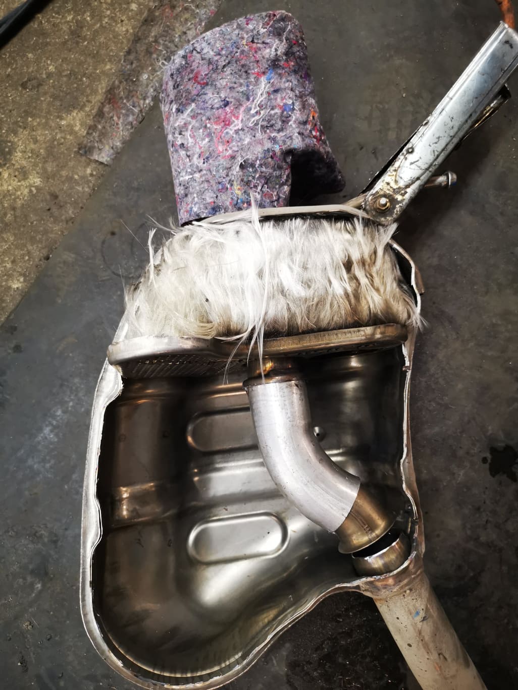

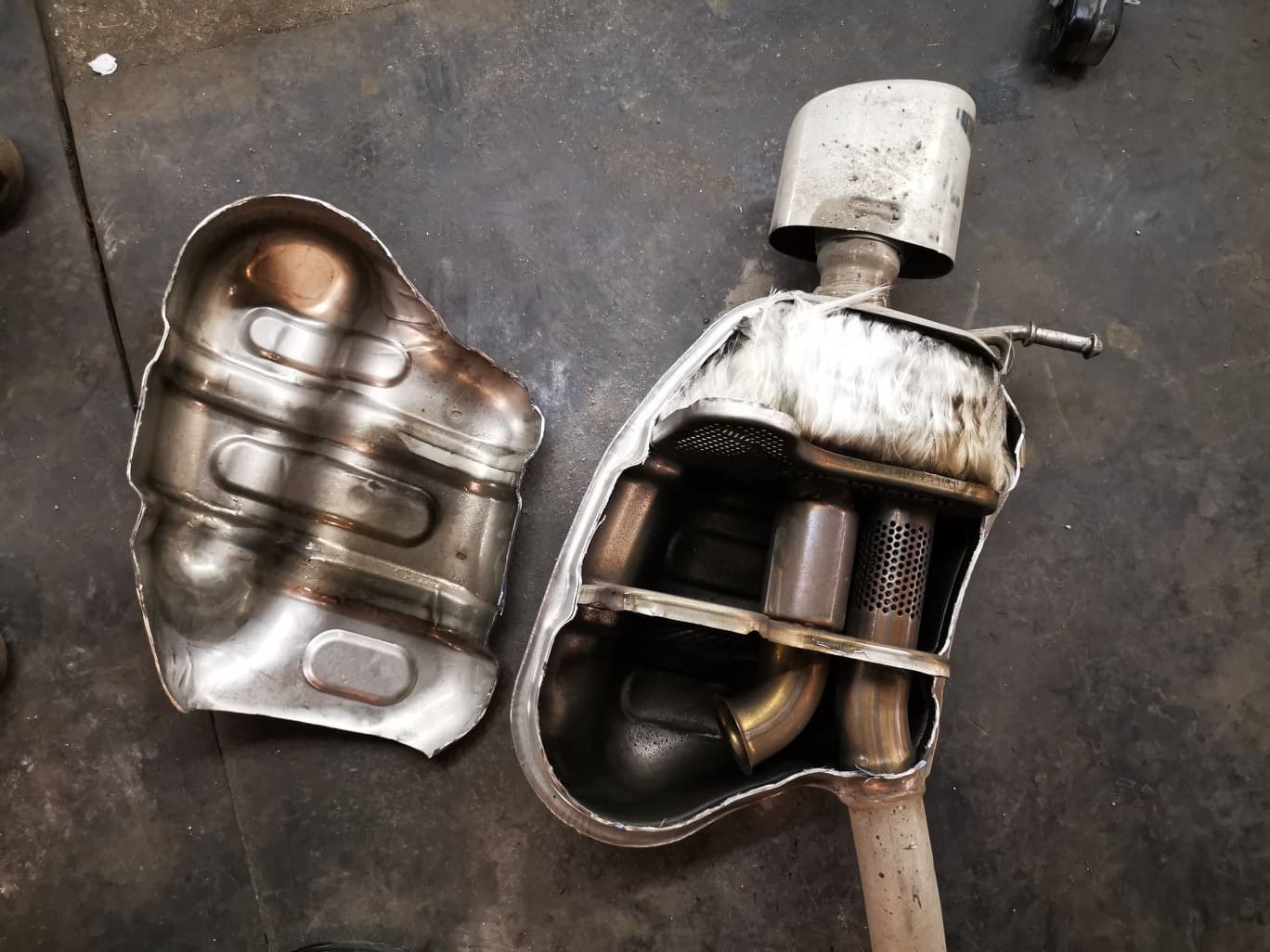

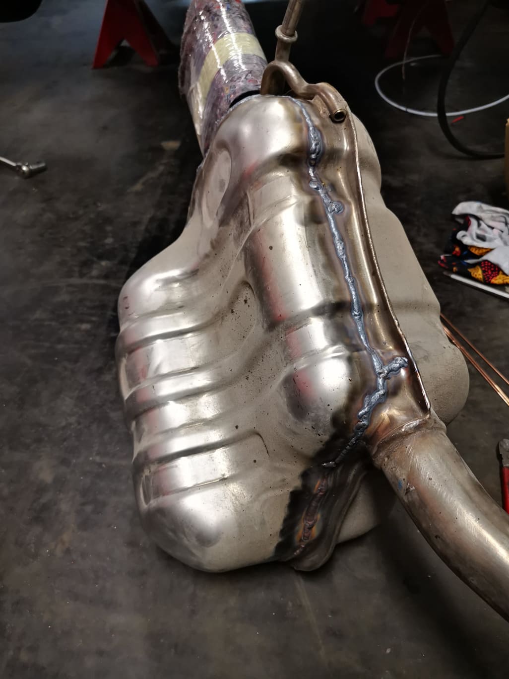

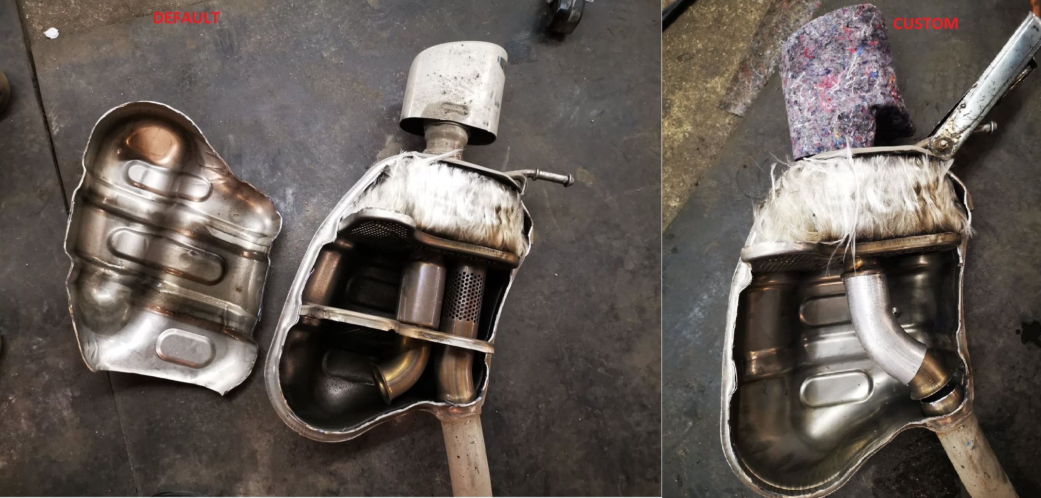

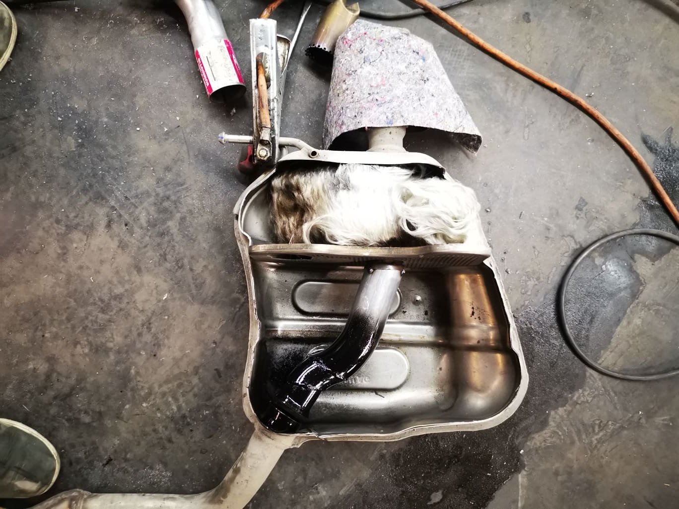

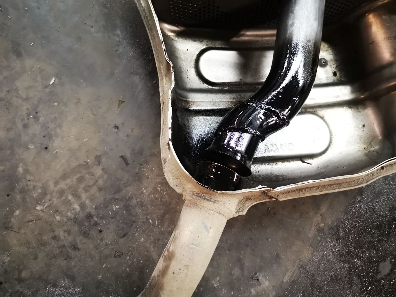

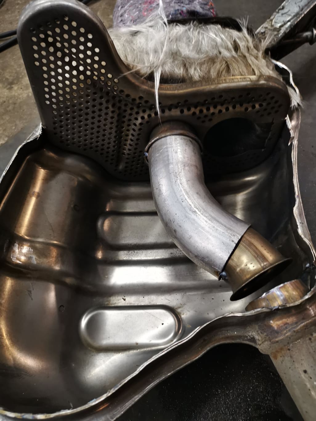

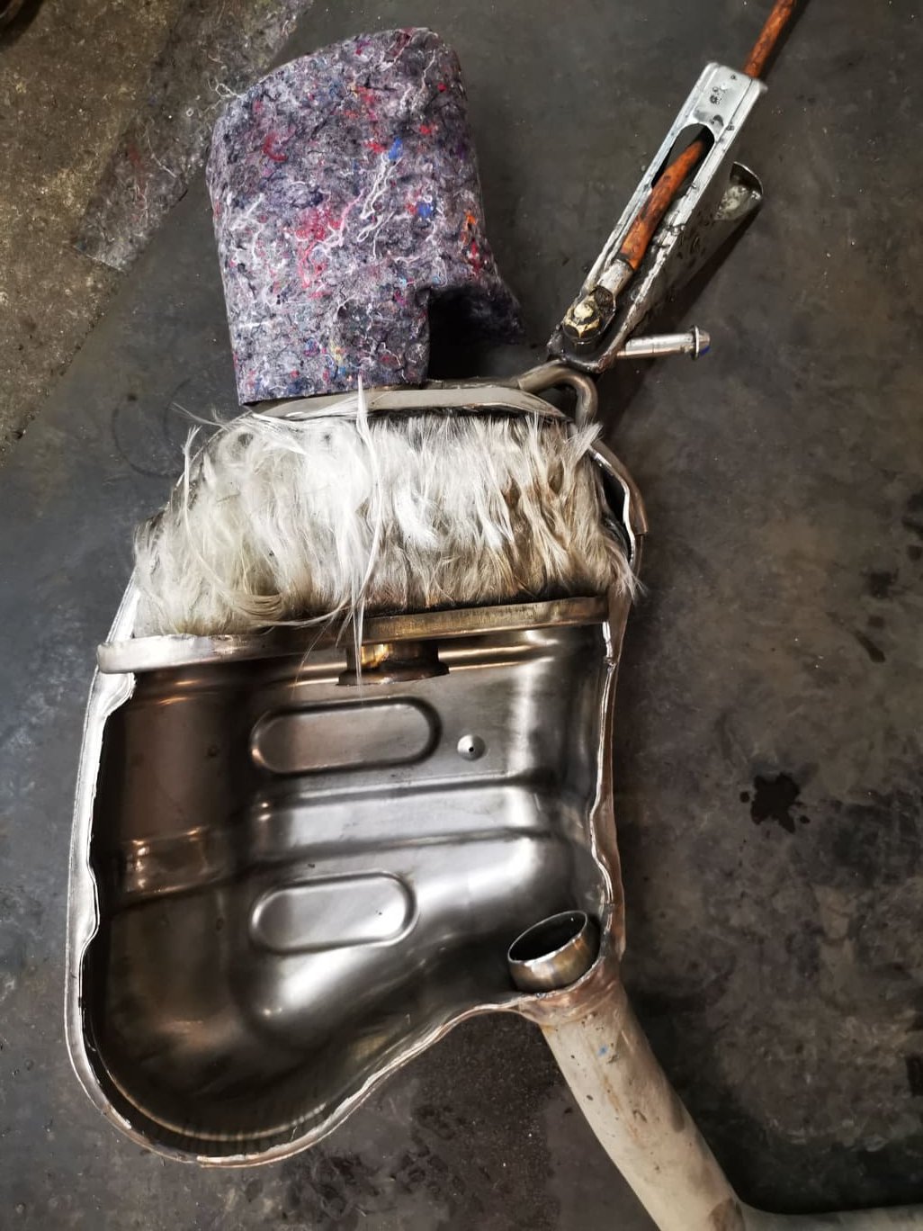

Damn, I can't find the Golf R pictures anymore.. I will share pictures of what I did:
upload_2020-1-22_11-28-28.jpeg upload_2020-1-22_11-28-46.jpeg upload_2020-1-22_11-29-21.jpeg upload_2020-1-22_11-29-48.jpeg upload_2020-1-22_11-30-17.jpeg upload_2020-1-22_11-30-49.jpeg upload_2020-1-22_11-31-12.jpeg
Maybe these will help someone :)
At this point I have not noticed any drone. In Cupra/Sport mode lots of pops & bangs. Comfort mode is little bit louder than before, but not much. Motorway speeds 90 - 130 km/h nice and quiet. Comfort mode also "disables" pops & bangs, which is quite nice if you live in little quiet area.
