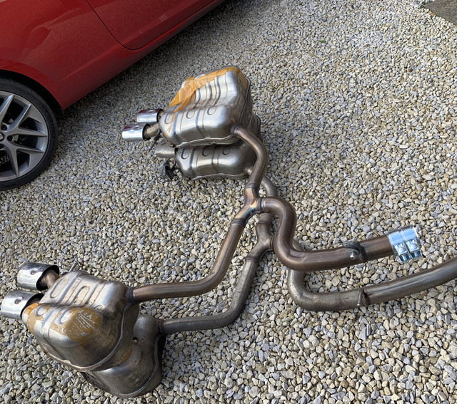

So just fitted the r exhaust on 2019 cupra dpf. Easy just need one cut and sleeve clamp.
Sound the bit loud but i will see.

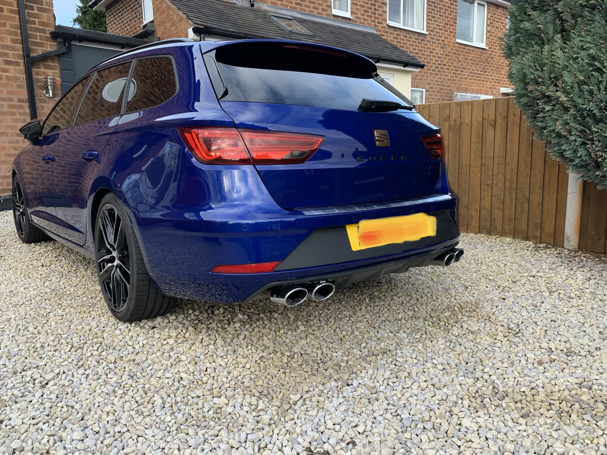

I realized I never put any after pics with the whole thing fitted and clean, so here you go:
You call that clean! Those exhaust tail pipes are filthy! Only joking, looks great. Looking to fit Golf R back boxes next month.
TBH, the guy that cleans my car could not do better than that - there is a lot of baked carbon.
Whoever owned the donor car probably never cleaned them.
When I have time and patience at home I will give them another go, but you should have seen what they looked like!
Hi Norbert,
could you please describe what does "bit loud" means? You mean loud outside or inside?
Do you have middle resonator or just Cat -> GPF -> back boxes?
I'm going to fit the R exhaust to my Octavia RS with GPF, so it think will be pretty much the same result like in GPF equipped Cupra.

Hi Robert
Mine gpf car so no mid box fitted.Exhaust sound much deeper and louder too.just enough loud too me.Shame no exhaust valve fitted because sometimes i want less noise after long day.Plus side when system warm up properly good dsg farts and another banging follow in sport or cupra.
this is cold start with higher rev.idiot gpf car do it every start no matter water temperature full warm and car just parked 10mins.

Thanks Norbert!
What about motorway speeds? No drone inside? Much louder than before?

Louder and possibly same level as r estate inside. you can check some YouTube golf r estate inside video.
I hardly use motorway,city car for me but not so bad around 90-110 on motorway.my car sound insulated (doors,boot and under rear seat)so thats help however st interior louder or echo sounds(i cant find better word.my “little english”)
