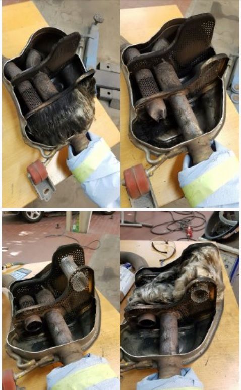

has here anyone pictures of an opened back exhaust of the "Leon Cupra R ST" and "Golf 7.5 estate with dual tipps" ?

And here is what's inside the "standard" ST version

Hi, that's all about gaz speed. Default cupra ST exhaust is significantly different from the golf R/cupra R ST. Have a look at my 2 last posts you'll see the difference. Unfortunately as you already own a R (having a direct exhaust), the best option to improve noise may be to look at aftermarket alternatives.
