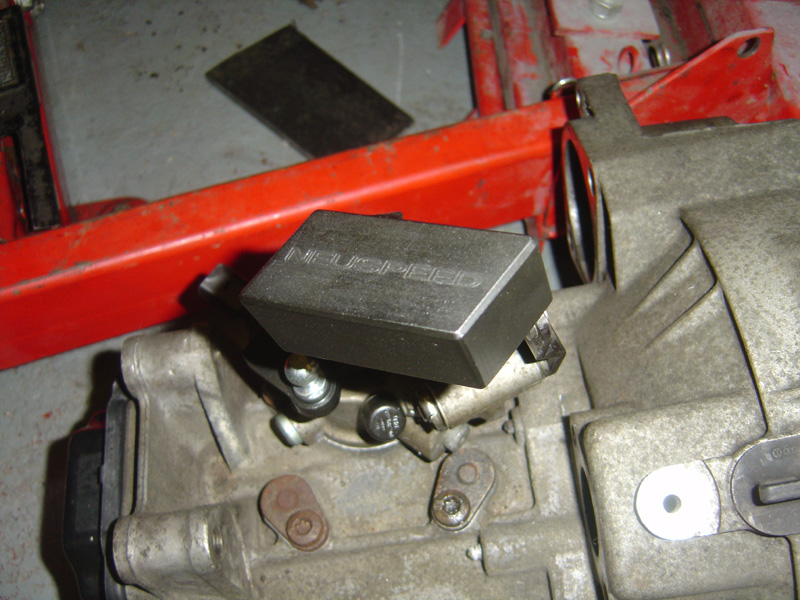

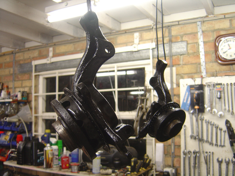

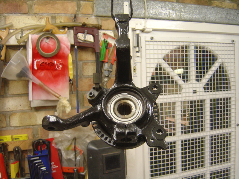

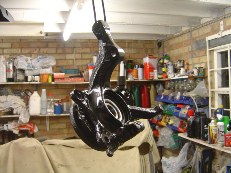

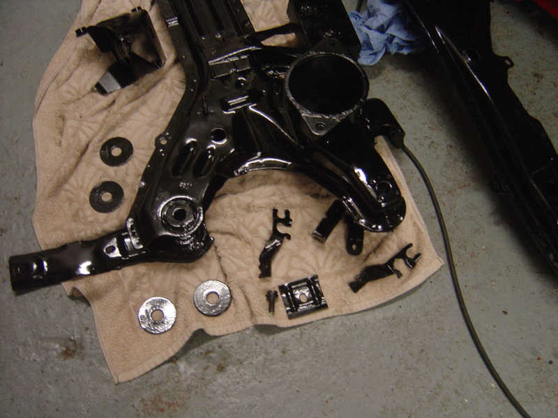

Busy night again last night at work, got all the hub's painted aswell as a few other brackets. Also fitted my Neuspeed Short Shifter to the gearbox ready for it to be re-fitted tomorrow!
Nice and clean, hopefully will stay that way for a few weeks at least... LOL
Few daft brackets after a lick of paint.

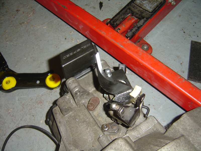

Neuspeed short shifter installed onto the gear box.
If you dont mind me asking how much was neuspeed short shifter?and could you run that with the likes of b&m?
Speak to Alex @ TTS Roadsport about the Neuspeed shifters, although yes you could run it with the B&M I personally aren't going to bother. From gear testing today the throw is sweet, just right and I've kept my OEM gear gaitor.
Car is still a road car, it's still retaining air-con whilst using a large intercooler designed to ditch aircon. And still has it's full Recaro leather interior. It's still 100% road legal but a possible de-cat may throw that spanner in the works.
A Leon Cupra R with an E.I.P shifter, was really nice and precise hoping for the same experience with the neuspeed one, and it has more throw reduction than the B&M one.

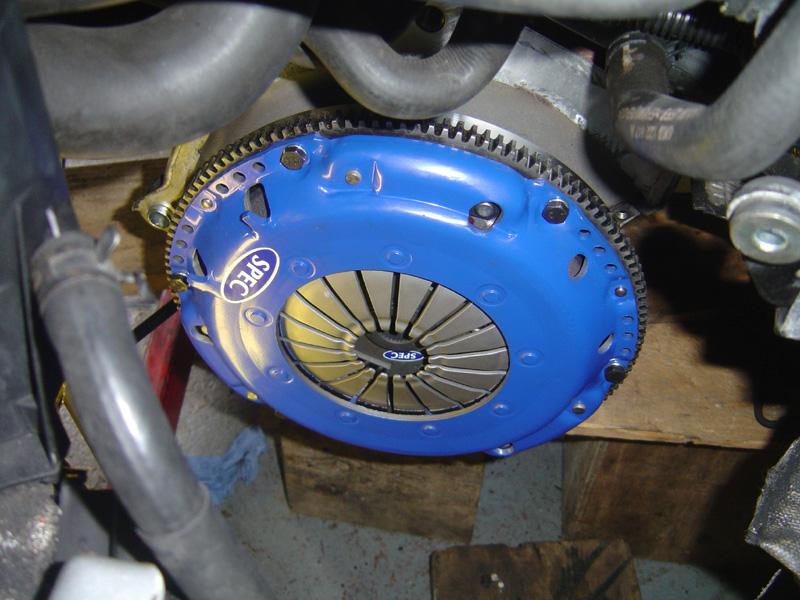

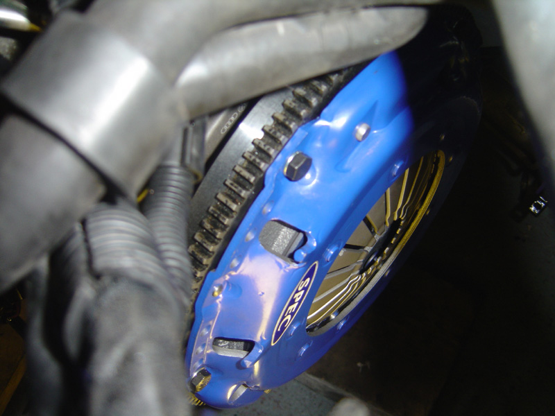

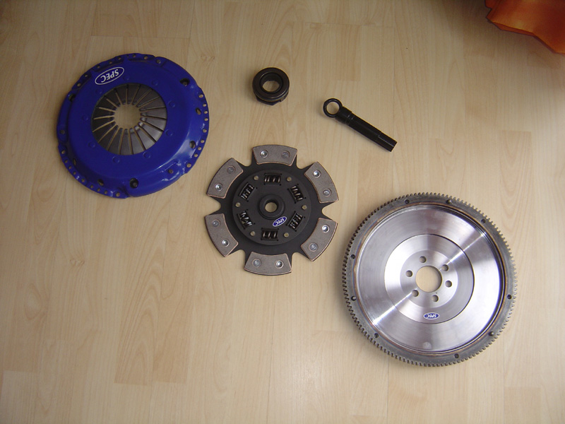

New flywheel and clutch.
Installed on the car.

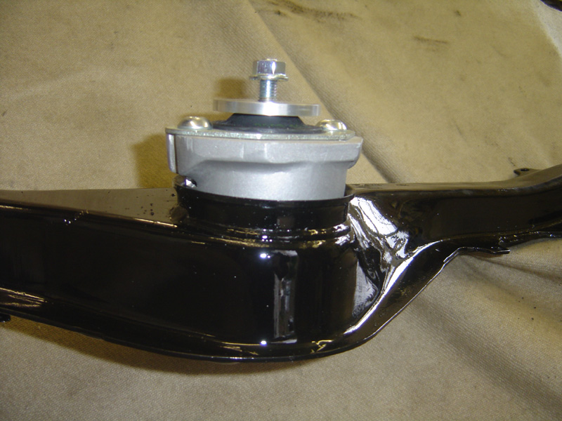

Vibra-Technics front engine mount.

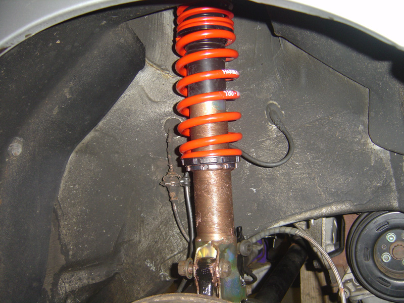

New H&R Coilovers.

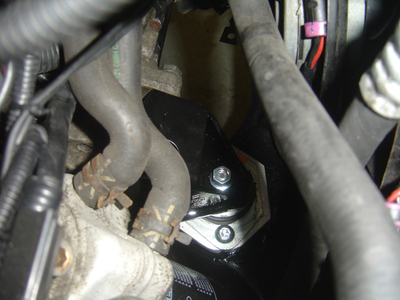

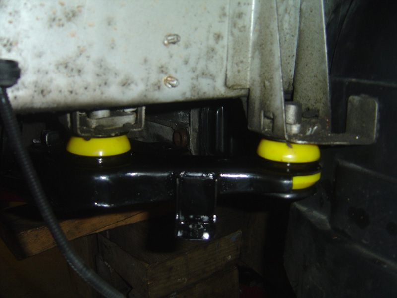

Front engine mount bushes and beam installed.
Front engine mount installed.
