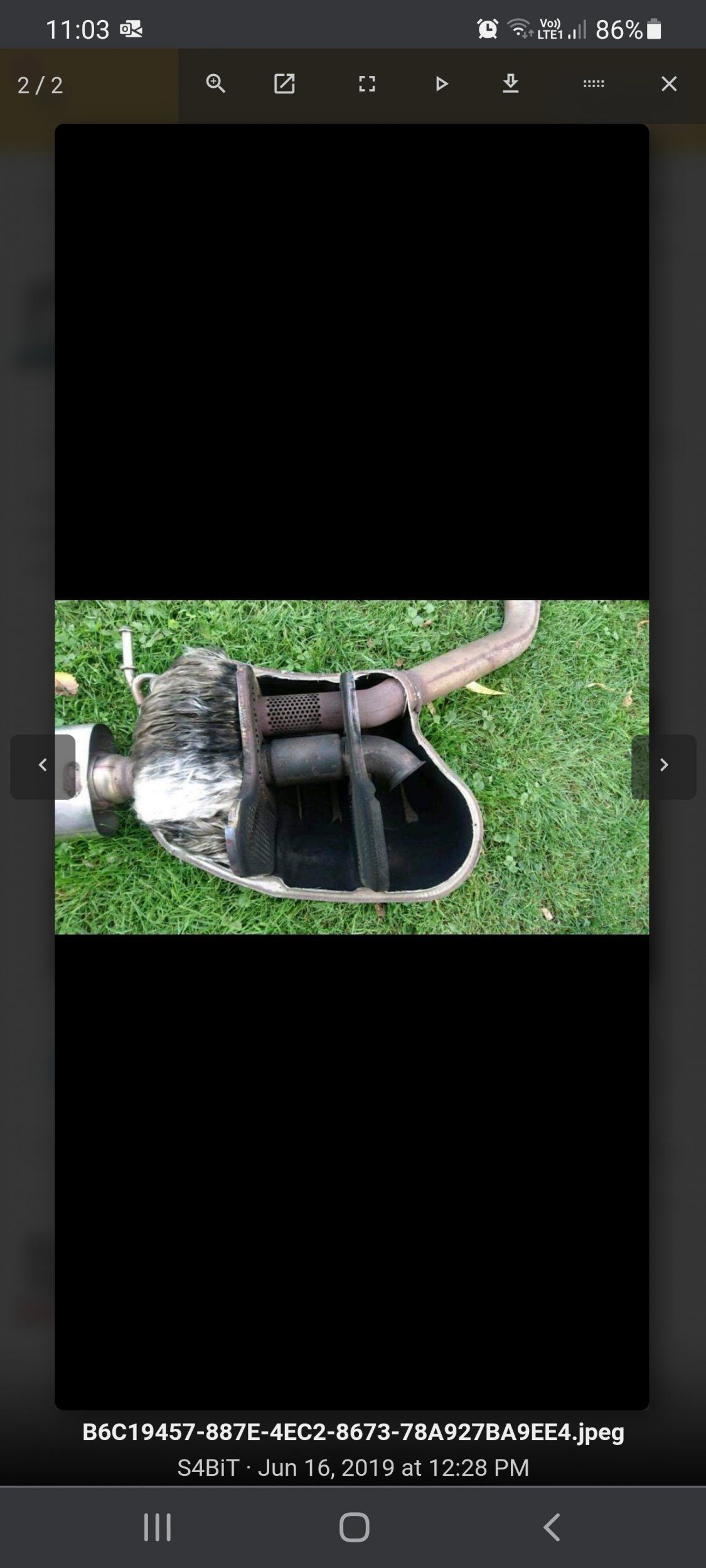

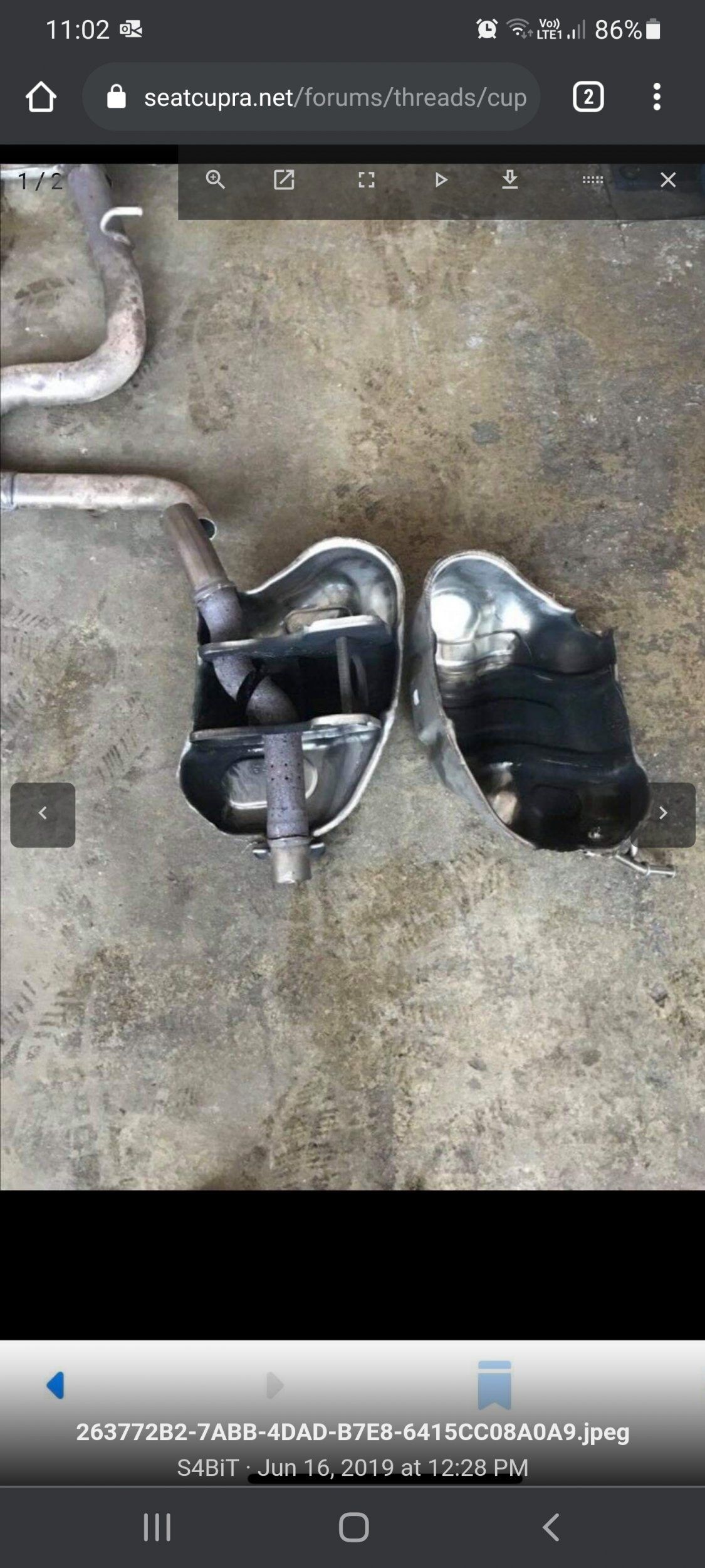

Apparently this is the internal difference pic 1 is golf r rear box and pic 2 is the cupra rear box
If that Pic 1 is the Golf R rear box, its the pre facelift. The pre facelift was the same system as the Cupra with only 1 exit, each side. It just didn't have a exahust tip welded on. As the actual exhaust tips were integrated into the bumper for the Golf R....
The facelifted Golf R exhaust has 4 proper tips. that exit the rear silencer as you probably know :)
Well spotted!! But it still internally is more straight through rather than redirected through baffles presumably because there is a center silencer on the 7 estate I wonder if my 7.5 rear boxes revert back to the cupra style due to being the only silencers in the system only one way to find out I guess
