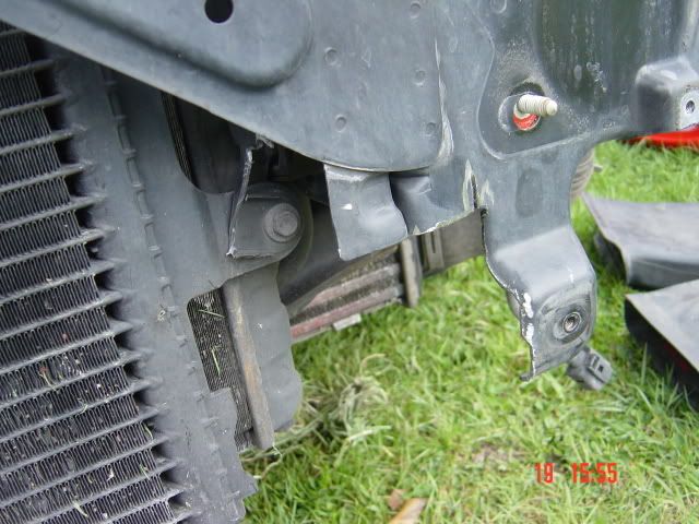

fimc

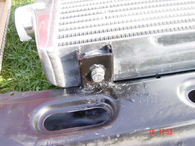

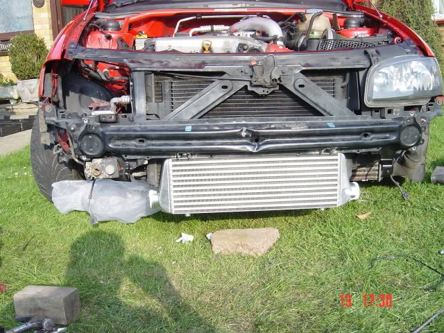

i have fitted my front mount just need to pipe it up but i did not need to cut alot of the bupmer due to me moveing the rad back

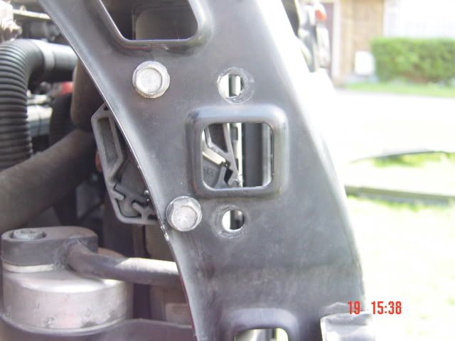

here i move my rad back:
then made the pipe work route:

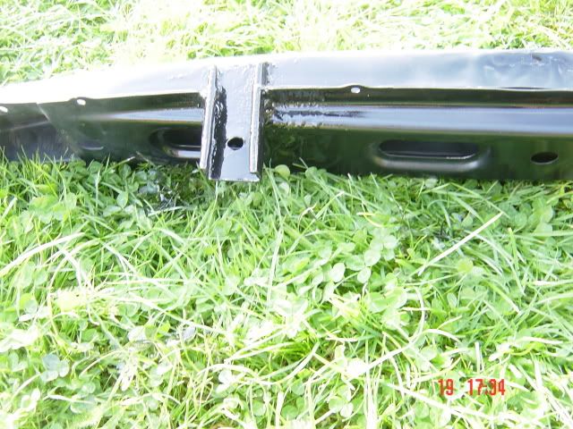

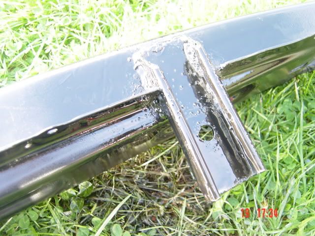

got my dad to weld me some brakets:

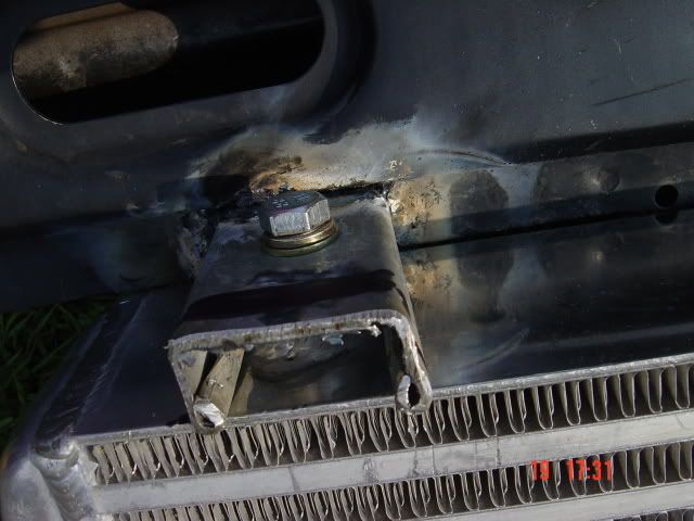

once we knew it was right he welded it up as it was spot welded to see if it works then i painted it:
now fitted: :)
now i got the pipe work to do and trim the bumper ends but i can fit the bumper without cutting it,
