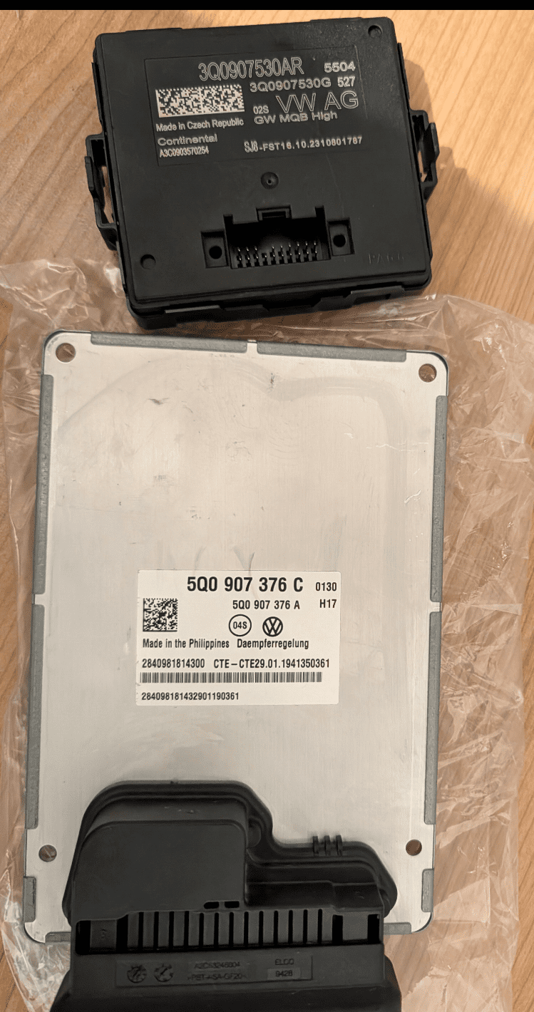

Good morning everyone.
The next parts are on the table.
This time the DCC control unit and the gateway. Both are relevant for the DCC settings, which should then be done using a slider in individual mode.
I'll first make sure it's running on the table. Then I'll edit the individual vehicle data sets and make them available.
The Continental gateway needs to be flashed to Index AR. Caution: This can cause problems with the Side Assist Radar; it changes the protocol slightly in the gateway.
Personally, I would then switch to the Lear gateway. Required Index AQ.
Caution: Replacing the gateway means unlocking the CP and having the functions activated.
Regarding equipment, you need a tool for writing the data sets, so not OBD11 or the like.
For example, VCP or ODIS or VC Tool.
The DCC unit need Firmware Index C with Software Version 0130
I'll keep you updated.

Doesn't it require new two-valve dampers to allow fine control?
Will existing single-valve dampers be OK for this?

I asked about dampers in my previous post, because around the same time, first VW announced new two-valve dampers, then configurators started to include "DCC Pro" option, and then I started to see that "sliders" in actual cars, so in my mind I associated all of those together, I thought it should be about new damper tech. But I might be wrong of course.
Apparently, more than just the gateway DCC unit, BCM, and 5F are needed for the FPA to work.
But I've still been able to work without a wake-up signal.
Alternatively, I'll install a fast connection for the DCC unit in my vehicle and test the data sets on the gateway in the car.
